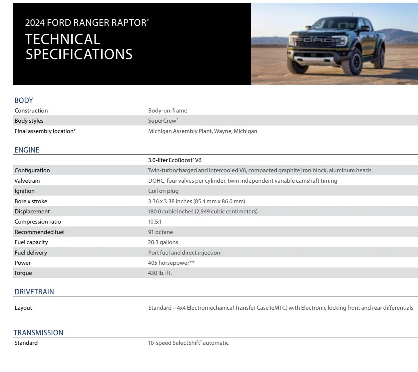

Racerx: unless Ford has a serious typo on their press release you are incorrect.
Ford Ranger 3.0 eco boost engine intake valves and direct injection! Screenshot_20241118_140238_Samsung Notes
It is a typo. Even the wiring diagrams show two sets of injector circuits for the 2.7 and only one set for 3.0.

OP is asking about the 3.0 ranger raptor specifically. So the other engines need not apply
This is a typo that Ford still has not corrected. This has already been proven in previous threads/posts and even one 2024 Ranger Raptor owner providing pictures to prove it. The 2.7L V6 is the only Port & Direct Injected engine in the MY24 Ranger, regardless of version.

What you fail to understand is that it doesn't matter what fuel or what additive you put in your fuel when all you have is DIRECT INJECTION. Fuel is nowhere near the valves.
Stu x 4
Stu
Jun 21, 2024
99
128
Colorado
2024 Ford Ranger Lariat Fx4 2.7L
The 2024 Ford Ranger Raptor has a 3.0-liter twin-turbocharged and intercooled EcoBoost V6 engine with direct fuel injection.
The 2024 Ford Ranger 2.7 L EcoBoost V6 engine uses both port and direct fuel injection.
The 2024 Ford Ranger 2.3 L EcoBoost engine uses direct fuel injection.
With port fuel injection, gasoline is sprayed into the intake manifold, where it mixes with air, and then is sucked down into the cylinders. Direct injection places an injector on each cylinder, spraying gasoline into the cylinder itself.
