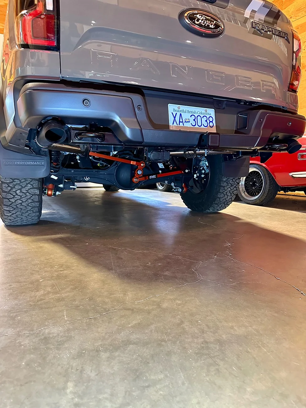

Installed @SVC Offroad watts link. Excellent quality piece
Make sure to have a press available to get center bolt out of factory watts link and have locktight for installing
The bolts for my arms were 4” long when should have been 3.5” , so I got shorter bolts . Could use as is or cut also .
I’m happy with it and it looks killer too

I am liking those exhaust turn down tips too!
The factory bolt was stuck in there and a press is about the only thing I didn't try when I did my watts-link. I was affraid of tearing up the bushing trying to get it out so I ended up getting a new bolt for it.
