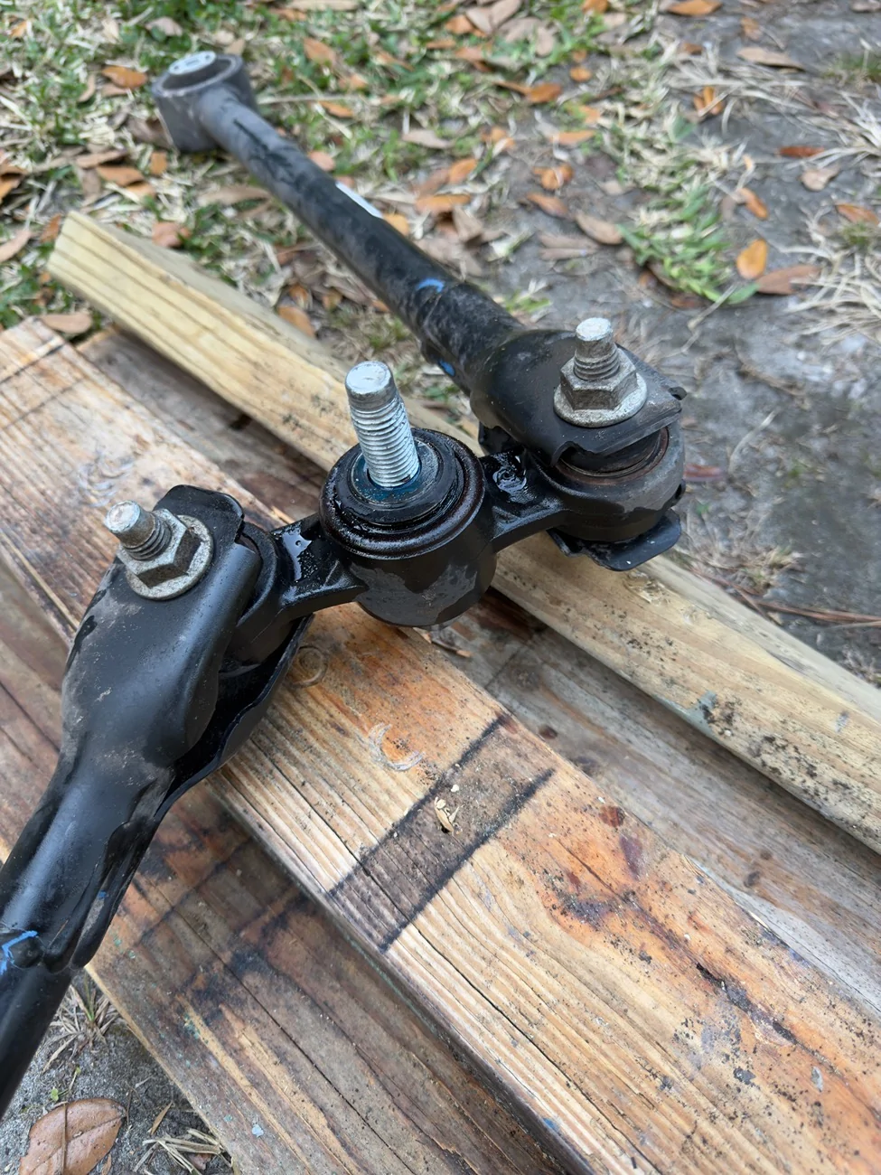

Has anyone upgraded their watts link and had trouble removing the bolt from the factory watts link pivot (the bolt going into the diff housing)? Mine is seized and nothing I try is getting it to budge.

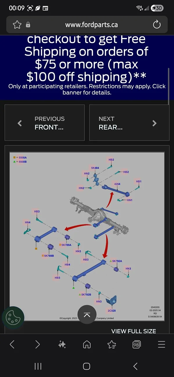

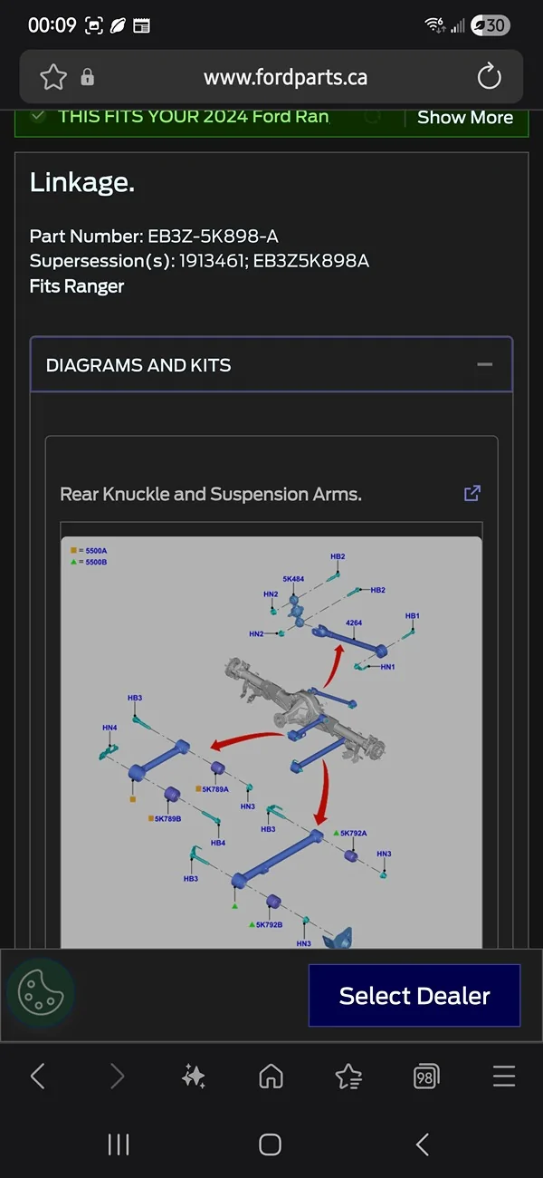

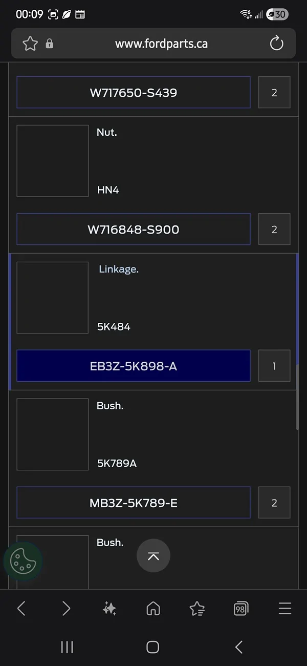

Its probably captive, and non removable. parts diagram shows it as one unit

Diagrams do show it as one unit but you’re suppose to reuse it with the SVC watts link kit. 🤷🏻‍♂️
