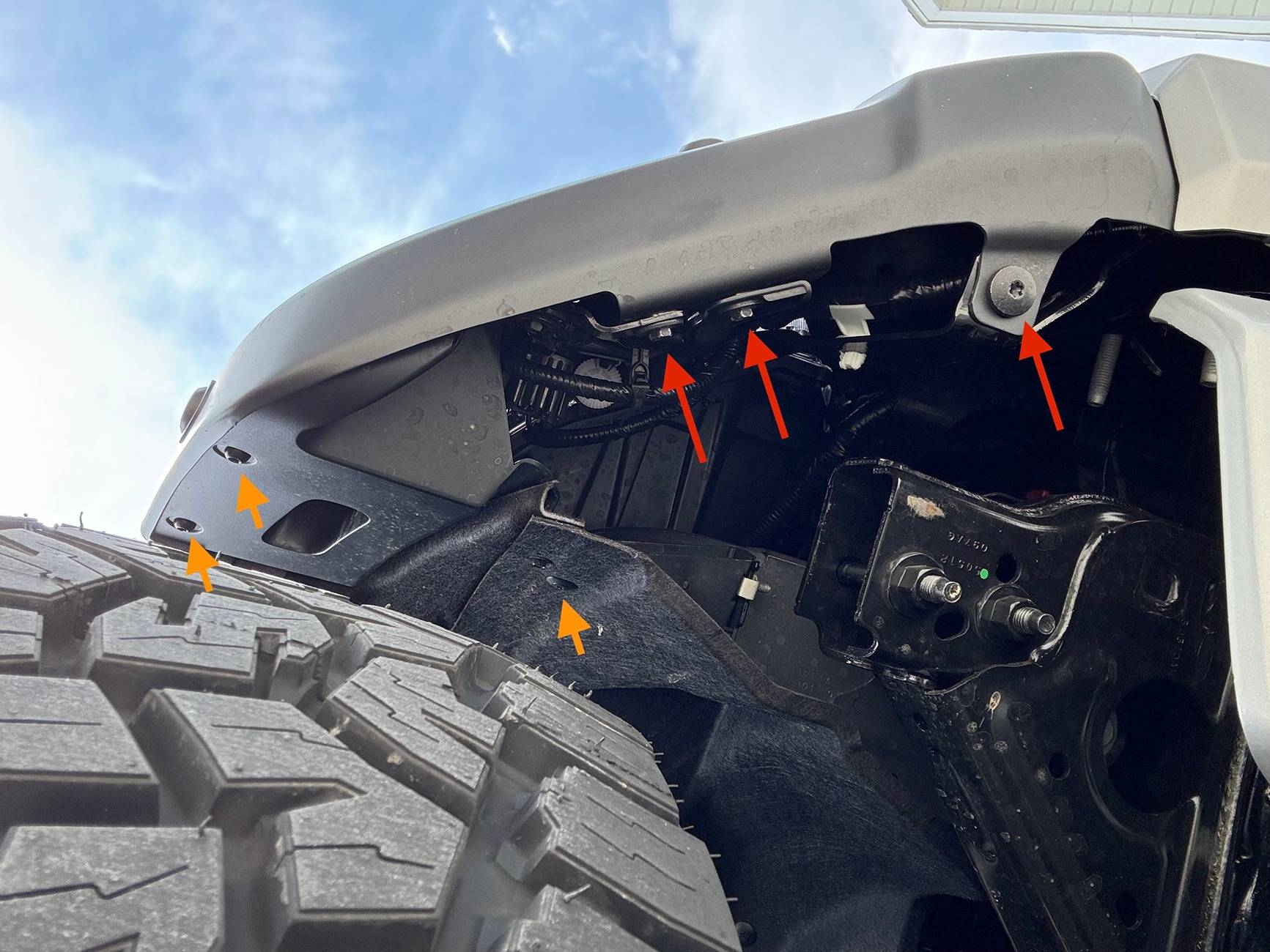

The front required zero cutting, but the back needed them to be cut in half. Nothing a sawzall and a diablo thick metal blade couldn't make easy work of. Pic below re: the fronts. You have to unbolt a few bolts and you can pull the bumper away enough to side the fronts out, without cutting. Red arrows you have to remove, orange you might be able to get away with not (but pretty sure I did, the right orange arrow I removed both of those).
That is great to know, thank you I appreciate it!
