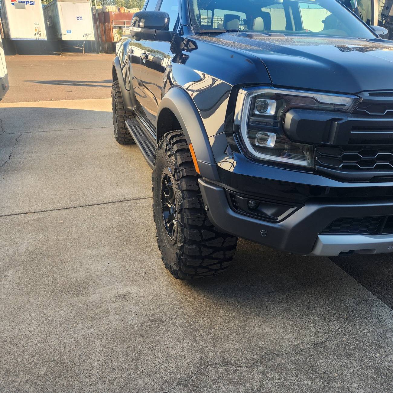

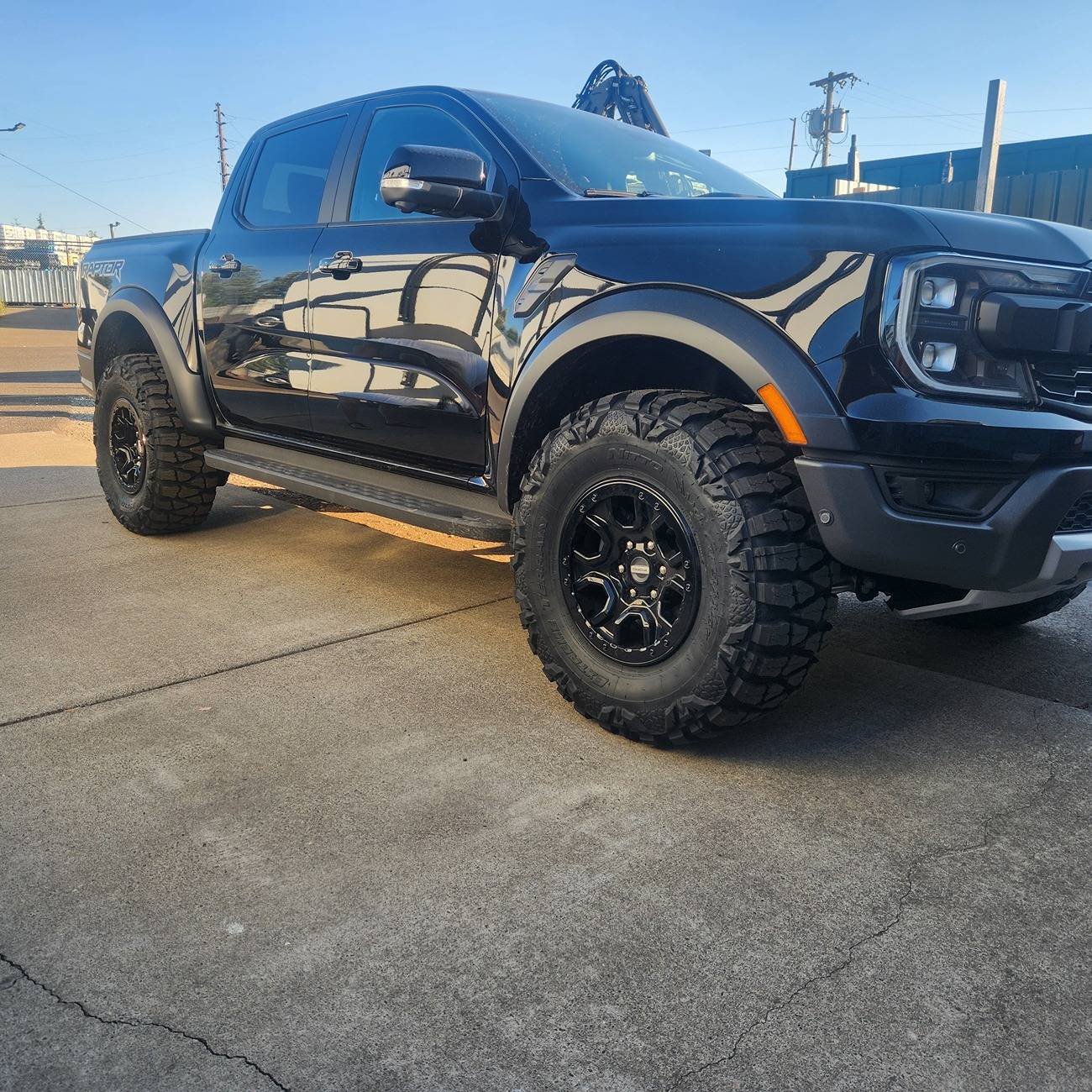

I am running that setup with a 295/70R17 tire. That is just slightly less height then 34" most call it a 34, where the stock SAS tire is 34.5 and most call it a 35, and mine do rub the left crash bar behind the bumper when the wheels are cranked to the right and I am backing up. It would likely always rub forward or revers when steering right with the 35" Bronco's SAS tires that came on those Rims.
Also my 295s are 0.8" narrower then the 315s.
I have not felt it to be a big deal with my setup and have yet to get around to pulling my front crash bars off. I likely will at some point, I think to run the 315 combo you will have to pull them, possibly the rear fender crash bars as well.

Swooped up some bronco Sasquatch wheels and swapped on 35s... needed to removed the crash bars and trim 1" off the rear on front inner fenderlip. stuffed the suspension and NO rubbing.
funny how the f150 Raptor owners look puzzled now as we cruise by.
Looks great. Curious what your fuel milage is now? Have you corrected the tire size yet. If so did you use Forscan? Any codes?
