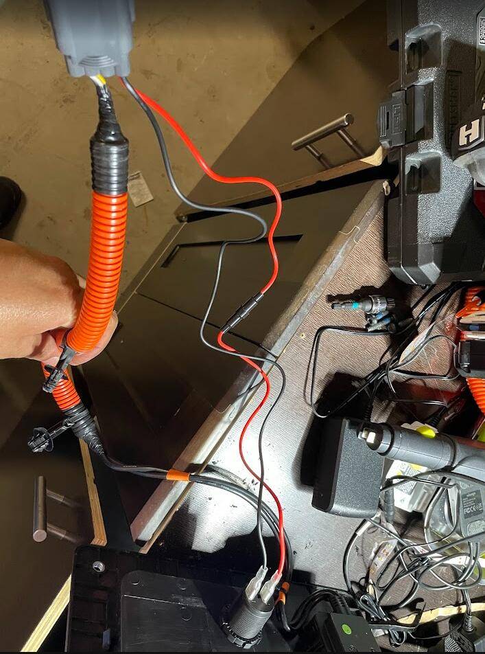

Hi all,
I added a 12V power outlet, which has been removed on 2025 RR models. The work took about $20 and 30 mins. I figured there had to be a cheaper way to get this done instead of paying $200 for a 2024 panel. Just had to add a pair of compatible pins to the harness. I will be upgrading cable quality and length soon, but my intention was to prove this solution was possible.

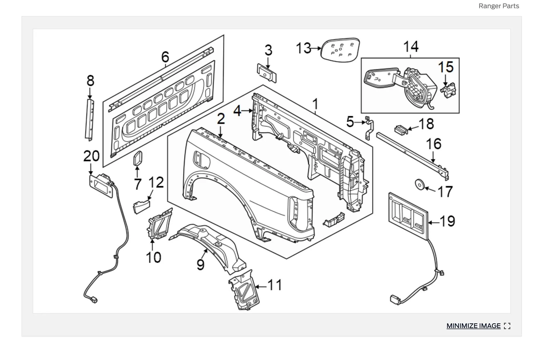

but when i was trying to track this down a couple of days ago I ran into this diagram a few times and it seemed to indicate the bed light #20 in the 2024 was in a separate cable versus the 2025 which has it as part of the cable.

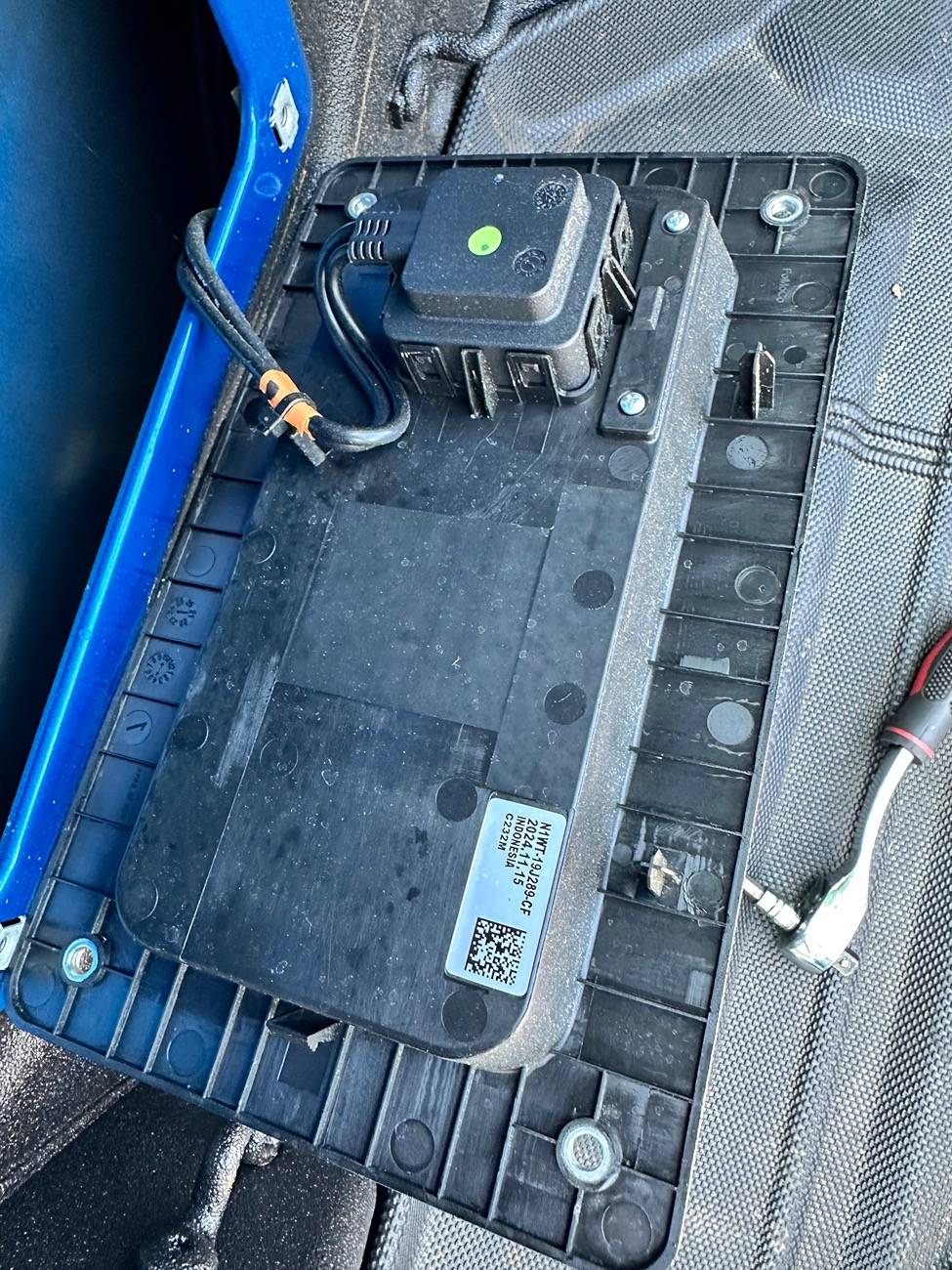

I was curious if there was a part number stamped on my panel (2025 lariat) and it’s different than other part numbers I’ve seen mentioned here or in other posts: N1WT-19J289-CF

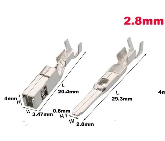

This kit appears to have the exact pins OP used. I've tried to find individual ones that are the exact same style but no luck. Unfortunately you'll have 428 pins left over when you're done lol. Going to be ordering this set and trying to tackle it - seems easy enough.

These appear to be Yazaki connectors. Good thing I have several gauges of terminals and sizes of wire seals left over from my GMC, which uses the same type for the aux switches. I'll have to give them a try.
Terminal: https://mou.sr/3U2rMPc
Wire Seal: https://mou.sr/3WP2DHx
Of course I went overkill on my 12v wiring and did silicone 12 gauge, which is massive compared to those terminals. I'll either need to size down wiring, or redo my harness I built
