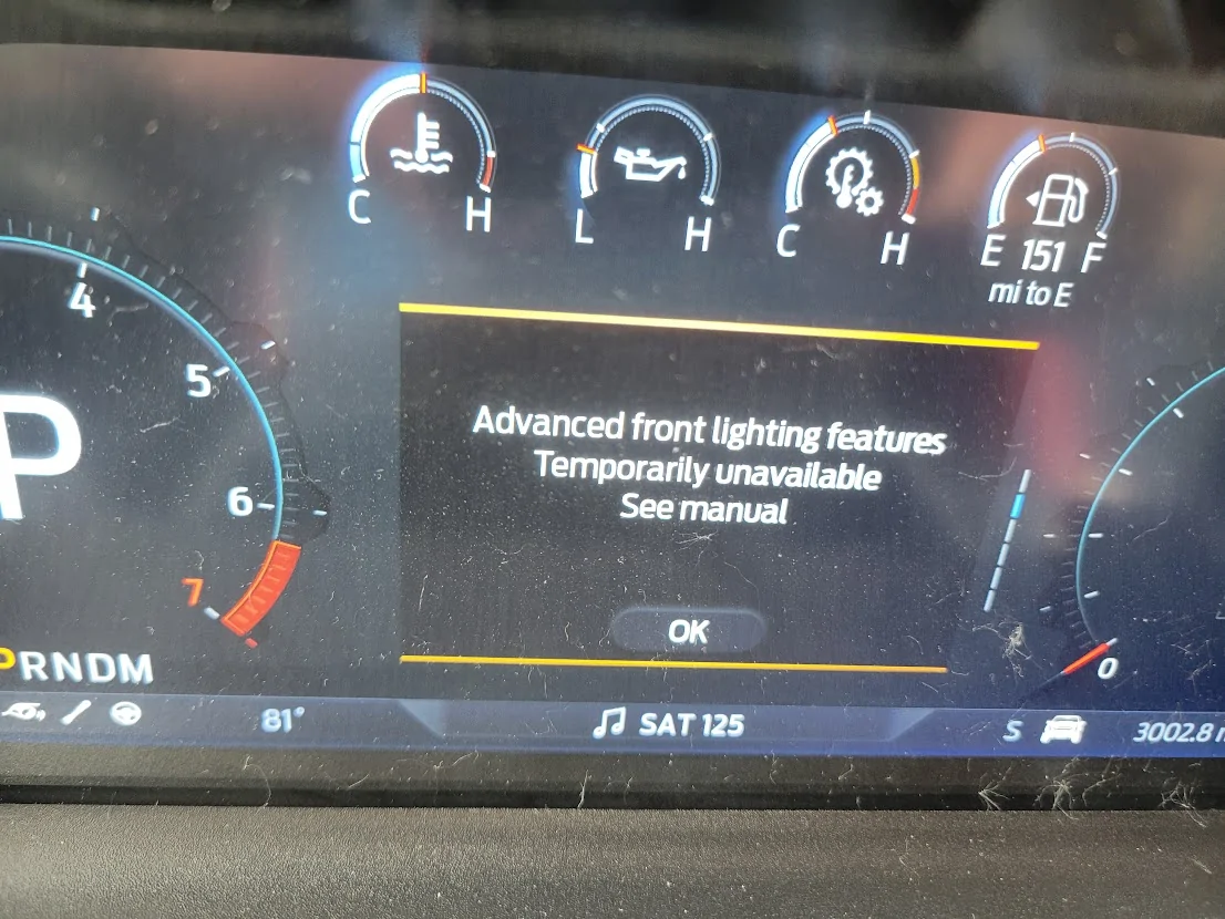

On my way back to Va. from Ohio, I got back in to set off after a piss break. I got this message on the dash. When using the left turn signal, it sounded normal, when using the right turn signal, it was a fast blink. On my next stop I got out to visually check the turn signals. Left turn front and back seemed normal. The right rear seemed normal, even the flash rate, the front right was out. So I tried the 4 way flashers, they all worked. But I also noticed the DRL didn't seem to be functioning. WTF?
Just over 3k on my '26. Any insight?

Well today everything is back to normal. Not sure if it's because I remote started it or Sync had a chance to update at the house.

Not exactly the same, I had the same error message on mine, but the blinkers worked. The dealer installed an update for the lighting module. Since then no issues.

A firmware update?

Yes, there was an update for the lighting controller available on FDRS. I didn't get anything offered as an OTA, so not sure if that would have eventually been pushed or not. But the dealer installed it, along with a BMS (battery) update for a battery drain issue I was experiencing (also fixed since then).
