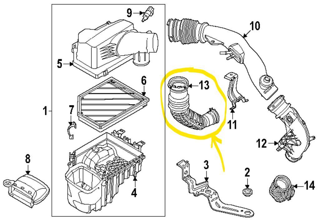

Any of you guys who have an intake installed possibly want to sell the tube that goes from right after the intake box (air filter box) down to the passenger side turbo inlet?
I installed the dual valve UPR catch car which requires drilling a hole in that tube and I just want the option to go back to stock if/when I want
Thanks
Looks like you want this #13? Ford oem part# NB3Z-9B659-D, around $130 new.....

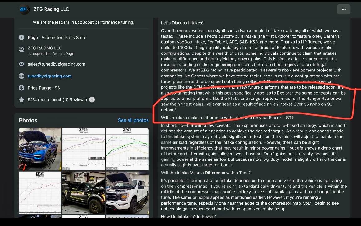

Kinda a long read, here's where he points out the RR Intake
Ford Ranger AFE Cold Air Intake installed on 2024 Ranger Raptor IMG_0862
es. Since then we've actually improved on the design but not had a chance to get it back on the dyno.

yea that is nuts. I installed the intake and the FP tune at the same time so I noticed a huge difference to stock.

Which RR intake are they referring to?

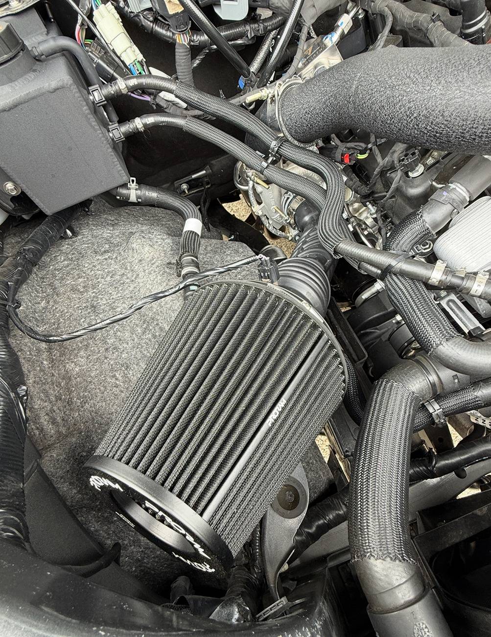

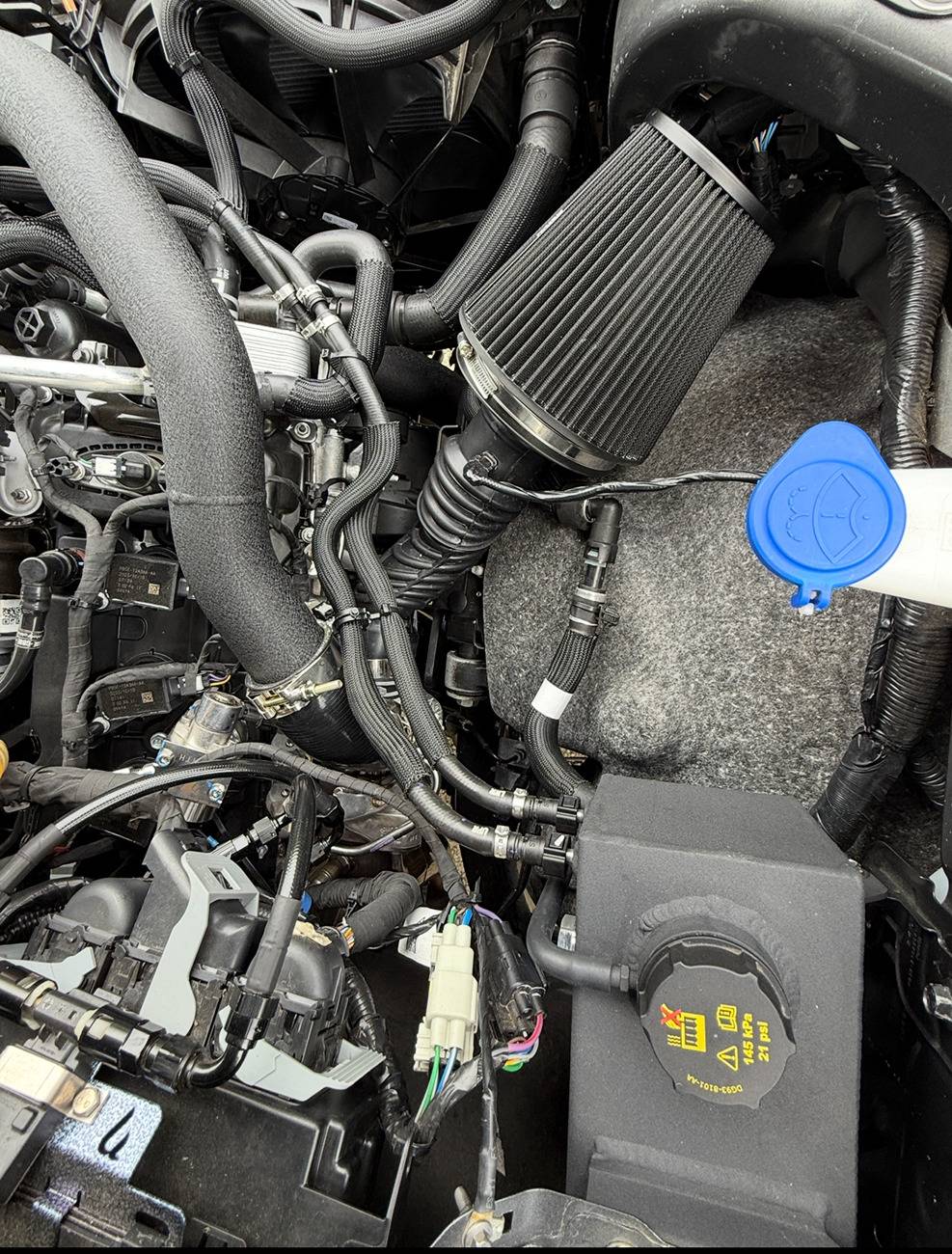

Ford Ranger AFE Cold Air Intake installed on 2024 Ranger Raptor IMG_0863
Ford Ranger AFE Cold Air Intake installed on 2024 Ranger Raptor IMG_0864
I rigged this up with the factory piping before we had some made. Cut a little hole big enough to squeeze the air temp sensor in.
Each turbo gets it own air supply, vs the driver side getting leftovers.
