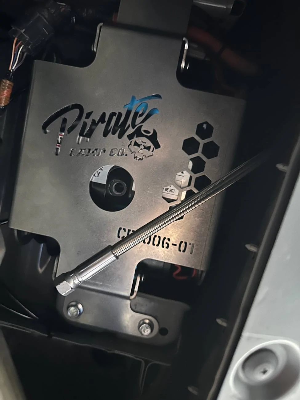

I did use pirate camp plate to install my ARB compressor under the bonnet; super clean install, way easier than in the bed truck and no issue with routing big wires to the battery. the ARB standard wire harness is long enough to reach the battery clamp with an all-hidden route under the plastic cover on the top of the front grill. also, wired to my AUX6 and it works as a charm. relay placed close to the compressor in a frame recess protected by water&dirt. the standard ARB hose is long enough to reach all 4 tires, and also to inflate my MTB when needed

Much easier and much faster install, you just have to open the bonnet and attach the hose? You could run an air line to the rear also and have 2 chucks.

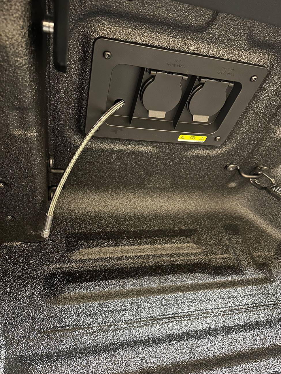

yes, super easy and the compressor is better protected under the bonnet vs the rear frame. yet, on my 3.0L diesel there are the truck bed access steps, and thus you cannot really fit it as in the raptor (but pirate camp makes a proper plate for my version too). correct, I just open the bonnet and plug the hose; and yes again, I can just route a fixed extension hose to the truck bed control panel. way better to route an air hose than a 10 or 8 AWG wire. but I do not like the hose plug in the bed truck, too keen to be broken by ay load I throw in there

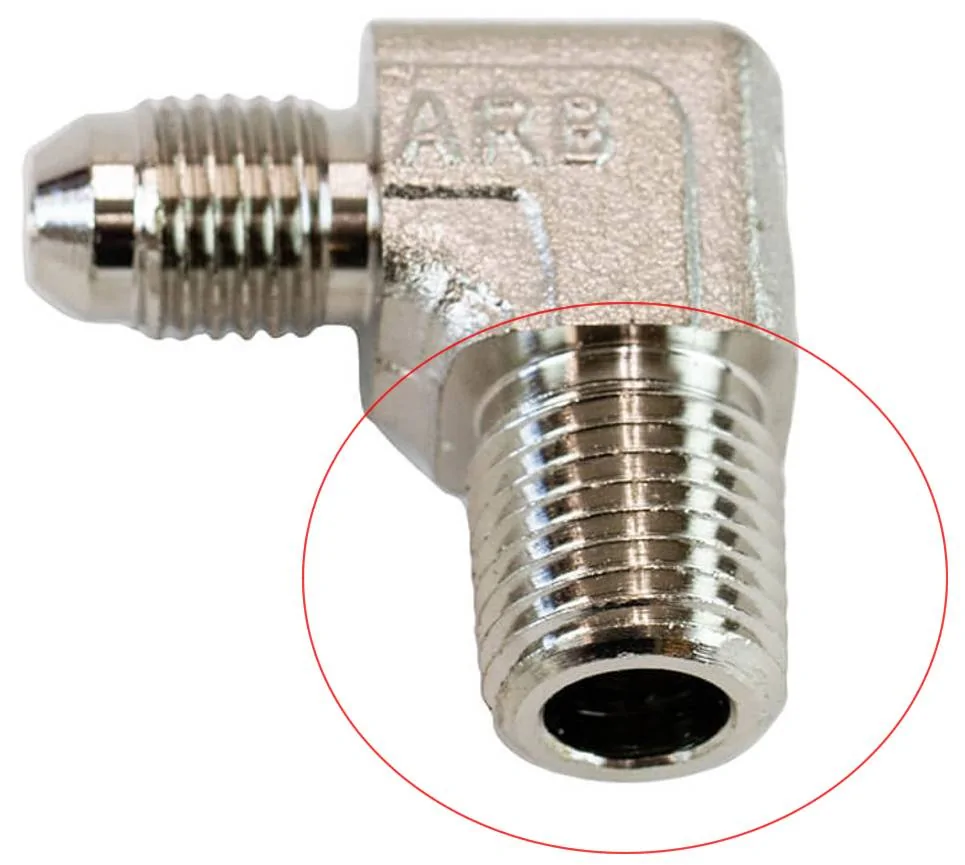

I ordered the compressor and Ausmotion compressor mount today. I'm putting together the other things I need, but I'm not sure on the hose connection coming off the compressor. Is that the 1/4 elbow fitting?
https://store.arbusa.com/air-line-elbow-fitting-0740110/
Also, why did you need to run the braided sleeving all the way to your engine bay?
Yes, this goes into the compressor. I got mine running today and I am just waiting for those fittings and the steel braided hose and I will be done. There are 2 brown wires in the rear. One is Aux 3 I got first then I tried the other one and got Aux 4. I ran the plastic braided sleeving all the way because I extended the wires and didn't want them exposed. The sleeve provides protection from friction. I'm not an expert, I could have probably used something else similar to what the ARB harness is.

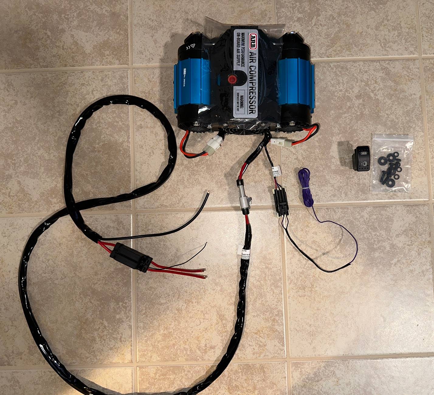

I got all my stuff and unfortunately, the wiring isn't as intuitive as I'd thought it would be. Did you have to run the big wires all the way up to the battery or can you patch them in to the aux cables in the back? If you are just using the overhead aux switch for the compressor, do you even need that second set of "switch" wires hooked up? It seems like wiring the big wires directly to the aux wires would power it and act as the switch.
I ran them all the way to the battery and I think that was required due to the amperage and the Aux wiring is very thin and adcts as a swtich right? Not an expert. Let me find a photo I took of what I ended up with.

This was all I used. Purple went to brown wire by tow hitch (Aux 4).
Thanks! What wiring did you use from the end of the loom to the battery? It's way too long of a run for just the loom alone. Were you able to find something that was already wrapped?
