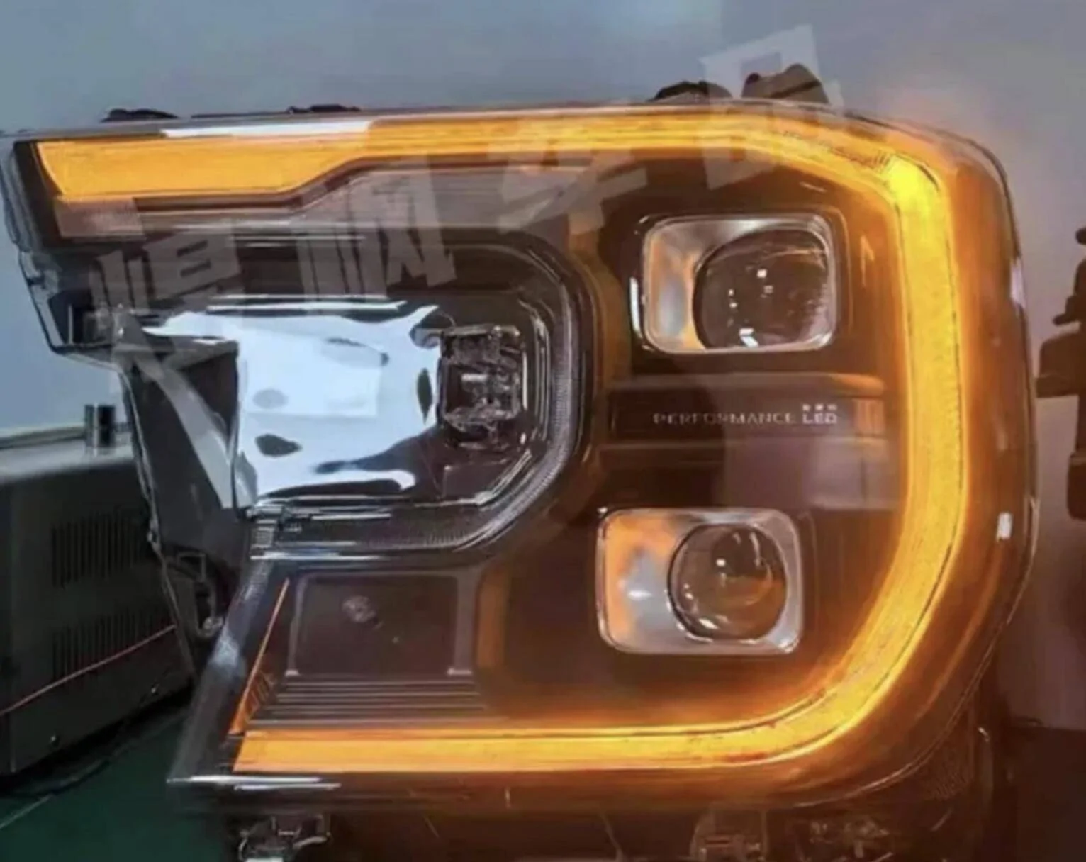

Before y'all beat me up, you probably will anyway, this is the cheapest best option that I've found. I tried other things and the colors were off, or the boards didn't function properly. If you want the look, like I did, then compared to everything else nowadays, it's not to bad. The picture below turned out a little funky.

So, what does the mod actually entail? I.e., what are you doing to the assembly to get the desired result?

$1,000, yikes. Do you at least buy me steak dinner and tell me I’m pretty?
I guess. Applebees. No one else though, and no sides.
Changing the LED. Lot of the expense is one slip up and we have to eat a headlight.

So are you just changing the LED chips on the removable module board or are you splitting the lamp and replacing LEDs internally?
Splitting and replacing internal.
There’s a pretty good, lengthy post on here about trying to do the boards
OUCH! Those puppies are about $1600 a pop!

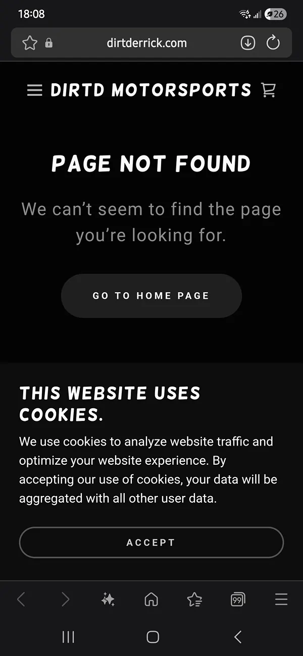

both pages are gone.
Yes. That was back when you sent them off to an old school headlight custom shop. Now the boards are $50 and everywhere for sale.
