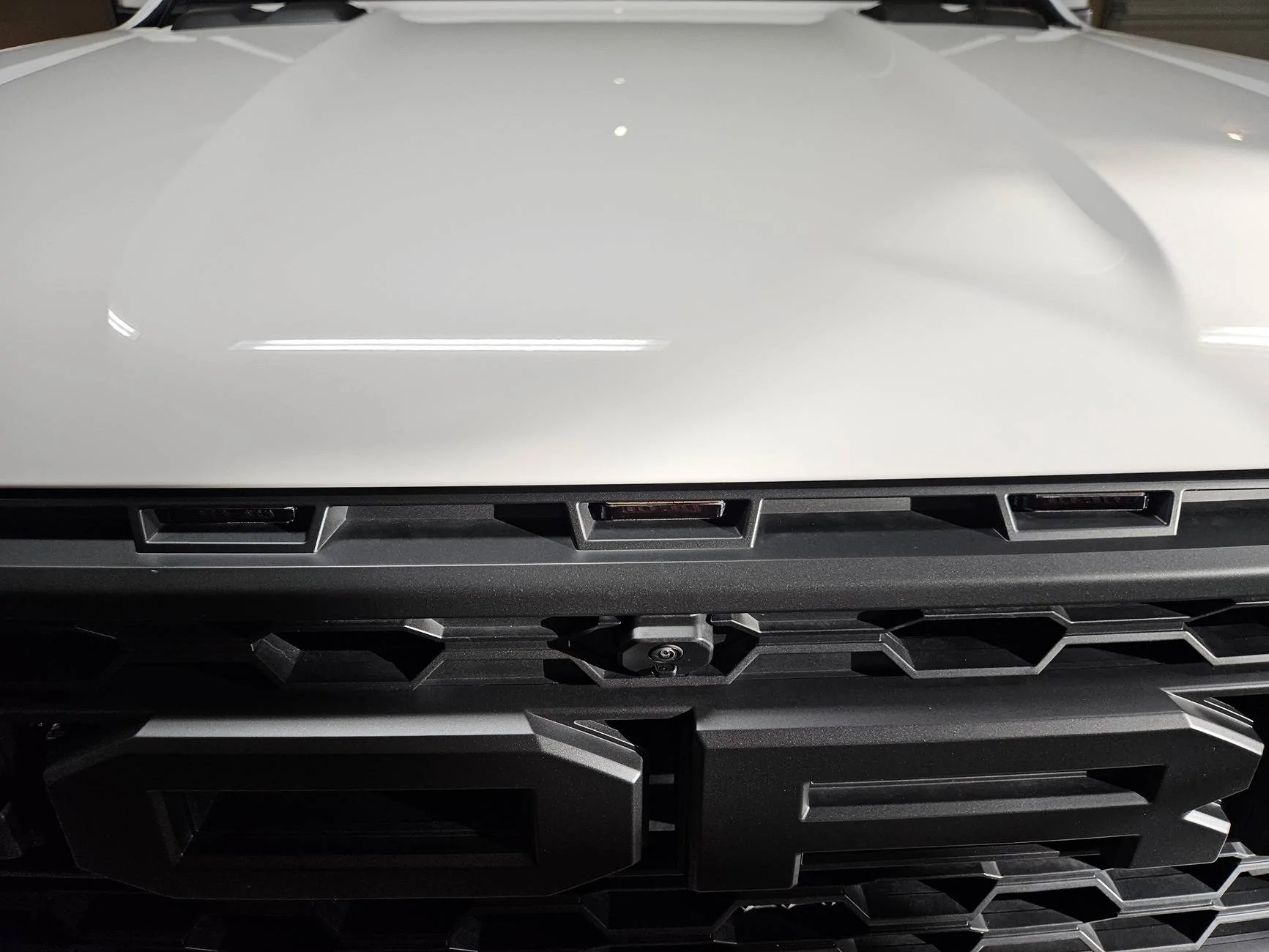

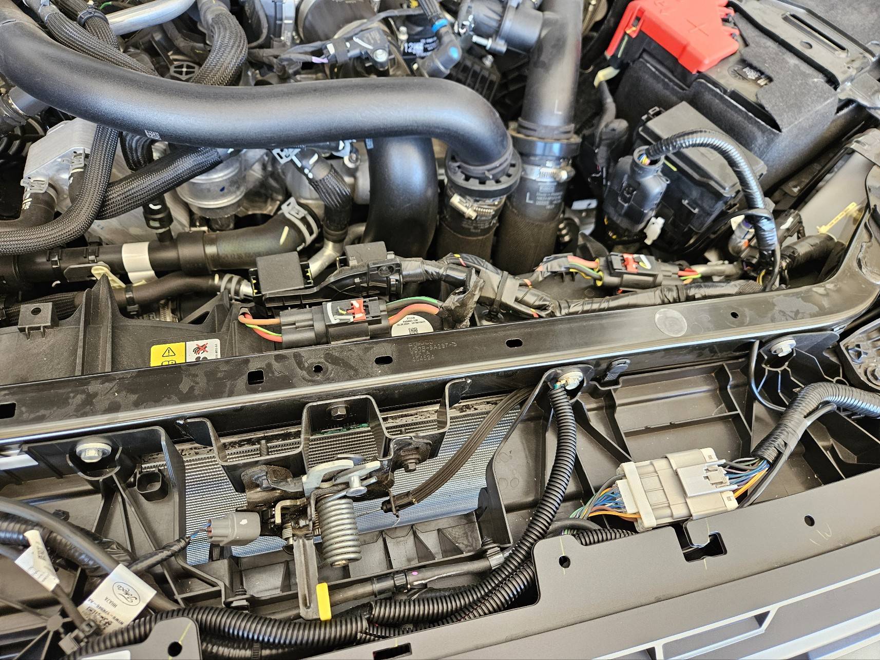

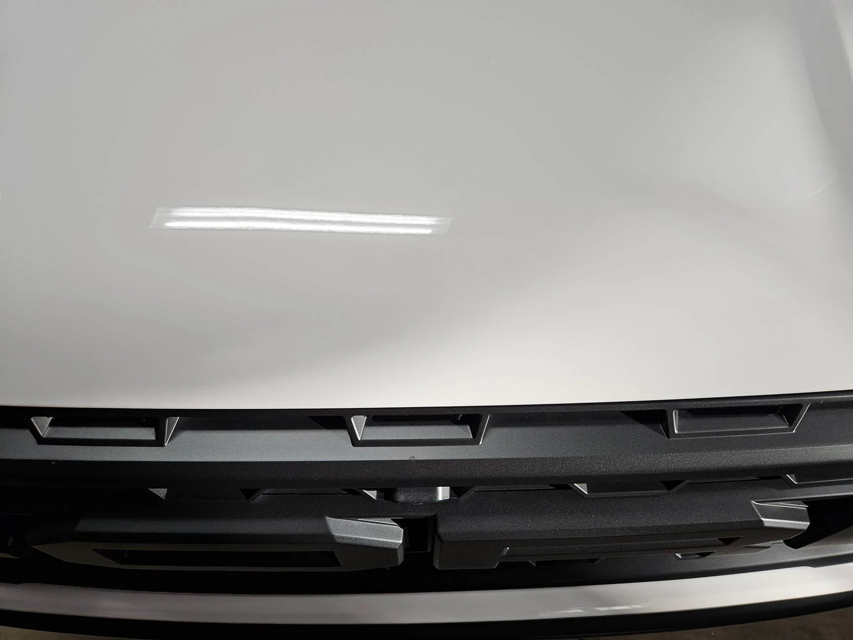

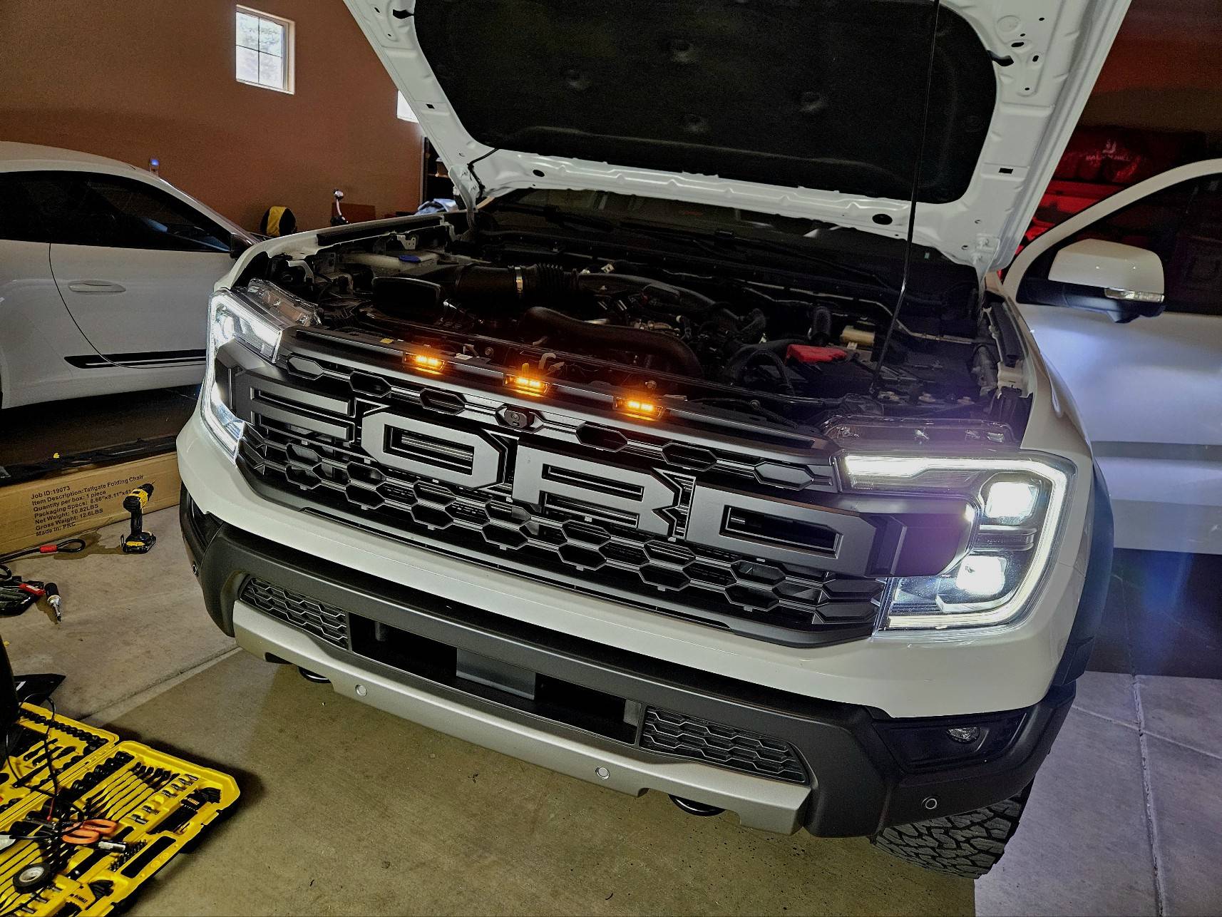

Some pics of how the eBay kit from Thailand fits. Install was super easy, connected to low voltage switch 1 at this time.
Unlike online videos which grounded each light individually, I did a single point ground with a spaded pigtail and splice joint. Wiring pic is before full helical tape of nylon jackets, along with zip tie/tape to secure everything. If anything doesn't work out, it takes more time to remove the cowl than to wire the lights!
Would I ideally prefer the solid bar LED? Yeah, but I wanted the flush fit more.
Ford Ranger Amber Lights for top of Ranger Raptor grille? Attach33678_20240727_142406
Ford Ranger Amber Lights for top of Ranger Raptor grille? Attach33683_20240727_142746
Ford Ranger Amber Lights for top of Ranger Raptor grille? 20240819_180238
Ford Ranger Amber Lights for top of Ranger Raptor grille? 20240819_180231

Fit is good but I don’t like how you can see the individual led diodes.
Having lived with them for a few weeks, I thought the individual LEDs, that all happen to be at an angle as well would bug me, but they actually don't at all.
My wife told me to just get the F150LED lights when they come out with ones that flush fit without grinding. But after dinner this week when I hit remote start, we both noticed a few things:
- I wanted the lights to be more solid to match the C lights, but the markers are yellow while C are white.
- The fender markers and side mirror markers are have an older reflector style look, and the grille marker lights actually complement those well, except for being slightly more yellow. But look again at night and you may quickly realize you also want them to blend with the other markers not the C-lights.
- During the day, one could say these ones aren't super bright, but they are plenty bright at night which is what they're supposed to be for.
And then we both said neither is ideal, but these actually blend very nicely and no reason to change.
At the end of the day, the fun was installing them, and I notice them for 2 seconds when remote starting, but I don't even know they're there when I'm driving.
Would I do the mod again? In a heartbeat. Would I spend more than the $50 shipped I did? Unsure.
