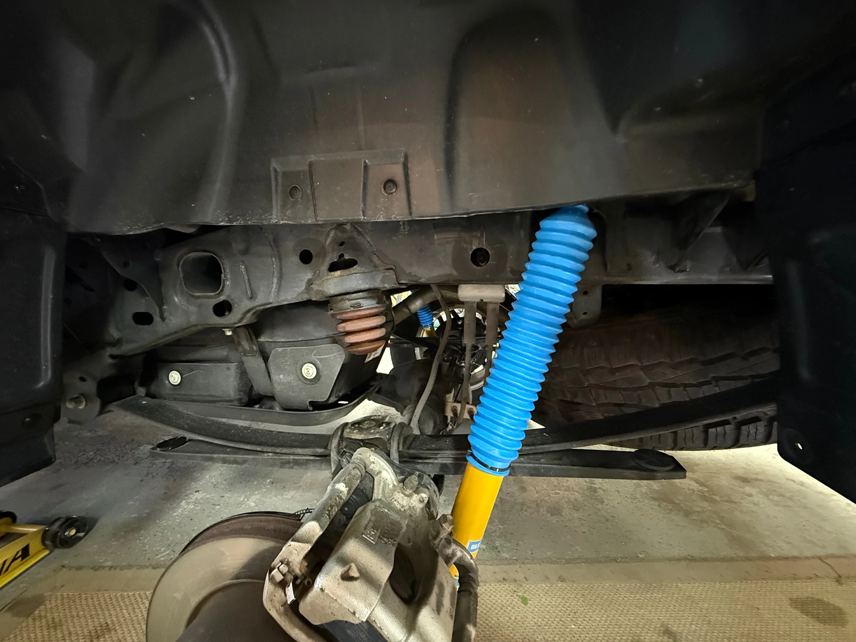

Once the warm weather hit and I started driving with the windows open, I noticed a rattle from the rear end whenever I hit a bump. I checked the spare tire, brake calipers, and hitch. Everything seemed fine. Suspension seemed ok. I tried bouncing the rear of the truck and was able to replicate the noise. Turns out the shock bushings are bad. The truck is two years old with 76K highway miles, never abused. Seems a bit premature to have to replace shocks.

Haven't read whole thread, but if not resolved, check all your spots like stake pockets, etc. Simplest solution usually the best if you've ruled out all the suspension usuals...

With the right tools and the correct replacements (if available) just changing the bushings would be OK. IMO at 76k it's a coin toss as to whether new shocks are the best solution.

Agreed. Time for an upgrade in shocks.

I ordered a pair of Bilsteins. I had these on my 2019 Ranger. I thought they improved the ride.

Just installed them last night. 60 miles of mostly highway this morning. They seem great. I was mostly focused on the rattle being gone. I previously installed Bilsteins on my 2019 Ranger and felt they really improved the ride.
