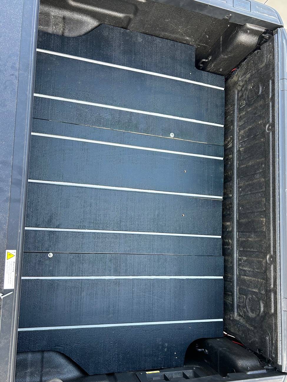

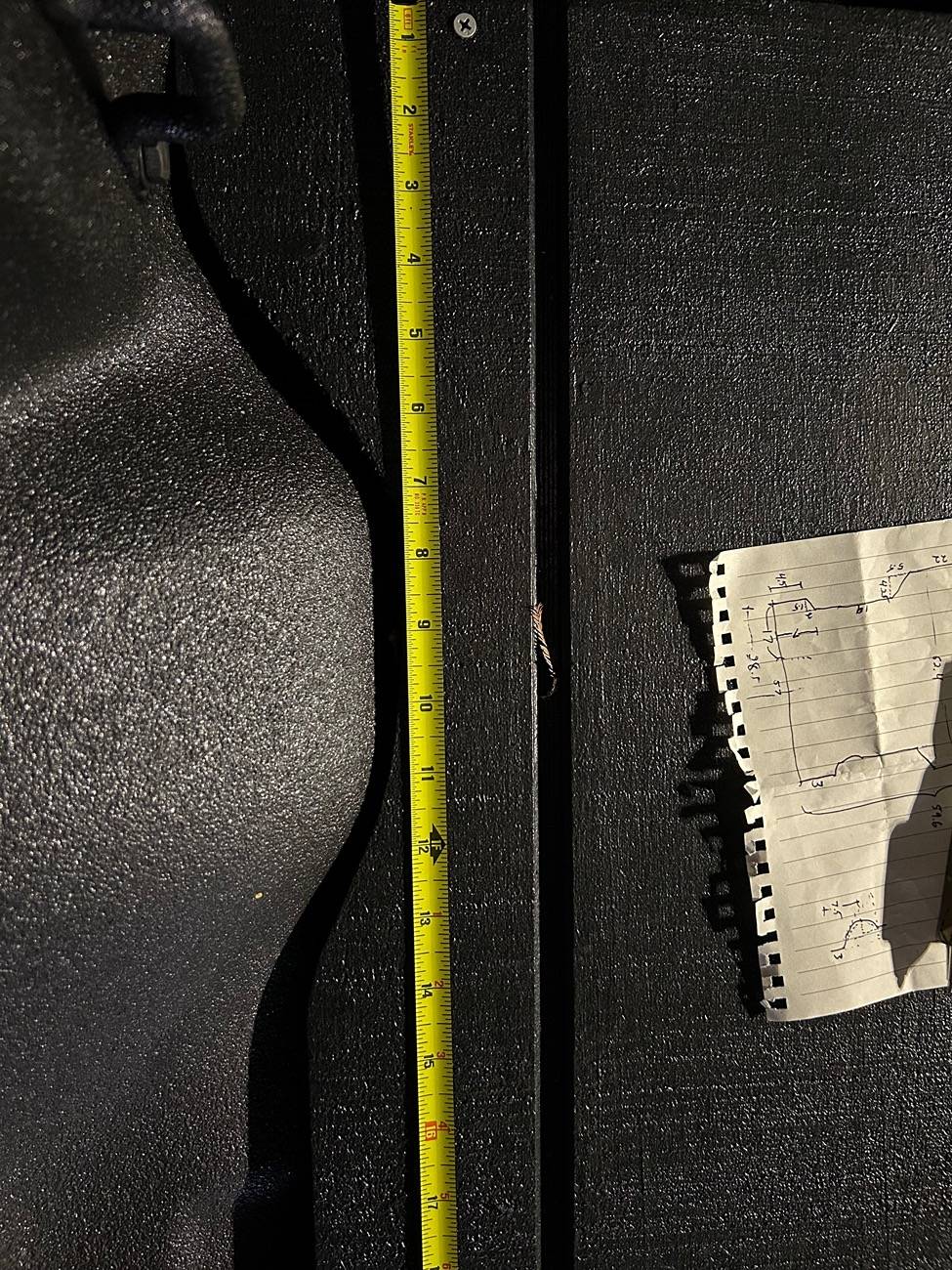

i was in the same boat as you and ended up making my own slider and it can hold 6 of the 9.5" tall totes from lowes/home depot. it does add some weight (about 75-80 lbs) but it is solid and makes getting to my gear SO EASY now. still gotta paint it up and get it water proof since my tonneau cover leaks like a damn siv!

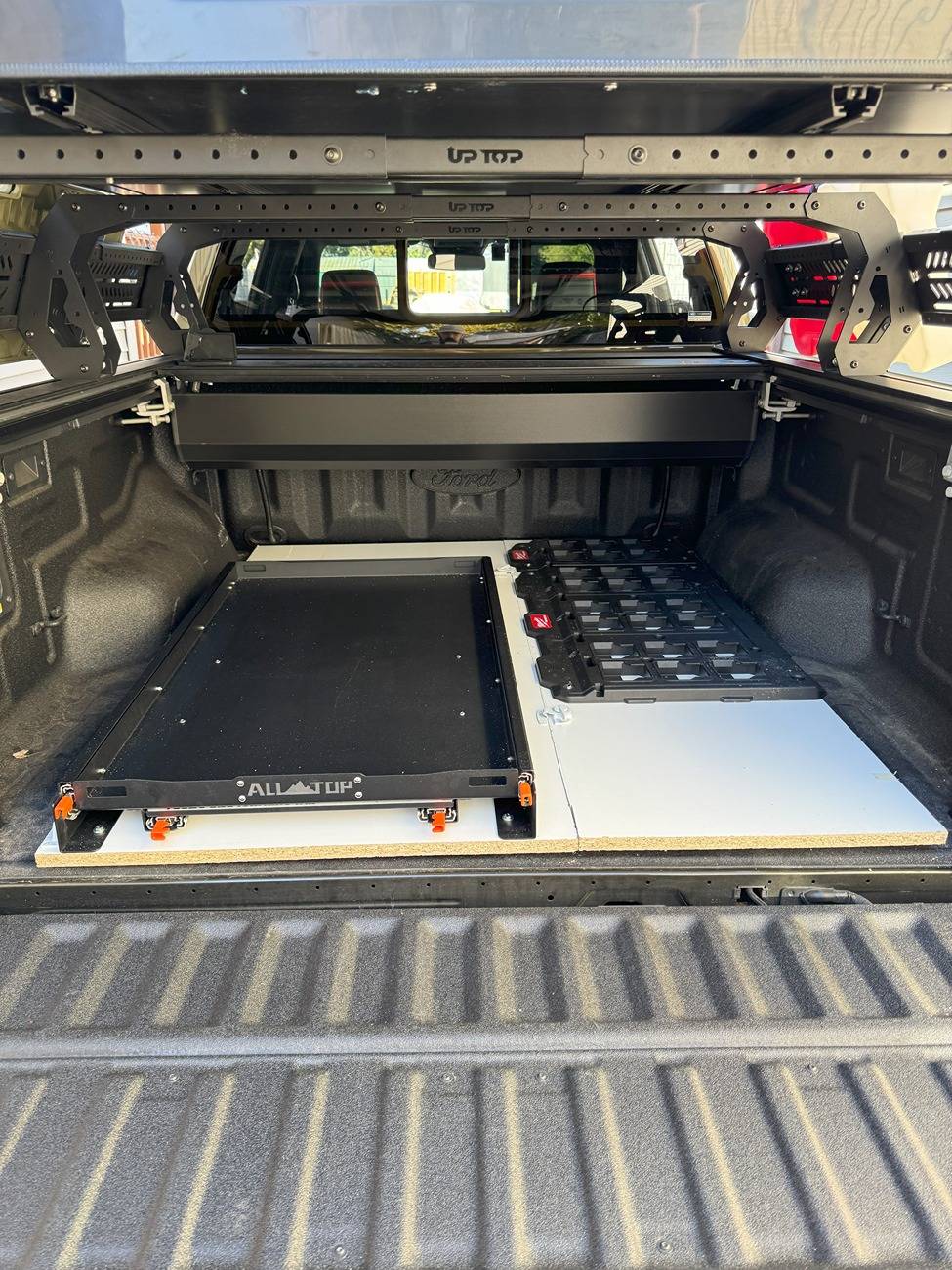

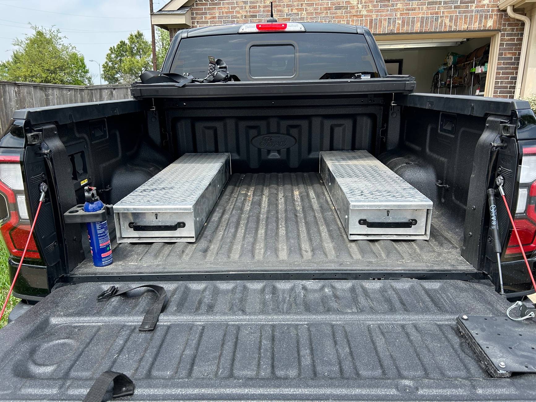

I went with homemade slider and Packout mounts for my trips. Split in the middle so I can use both or just one or the other.
https://www.amazon.com/dp/B0B7MHGZJB?ref_=ppx_hzsearch_conn_dt_b_fed_asin_title_1&th=1
dude, that setup is awesome... does your tonneau cover leak at all? i would not be able to use particlal board like that in my truck because my tonneau leaks a TON. How did you secure the front of those boards to keep them from flipping up when the weight is all out on the back. I love that secondary slideout table... freaking brilliant... now i wanna add something like that to my slider. I really like that you can pull this out really easy if you need to.

So far just the standard mitigations. Plugged as many holes in the bed as I could and added seals wherever I could.
I bought a 3/4" thick Melamine panel for my base. I treated and painted the exposed cuts and has resisted moisture so far. Added textured feet to the bottoms so they don't slide on the textured bedliner.
No issue with tipping. The board goes all the way to the front and I usually have some weight on the section that sits under the roller cover pan.

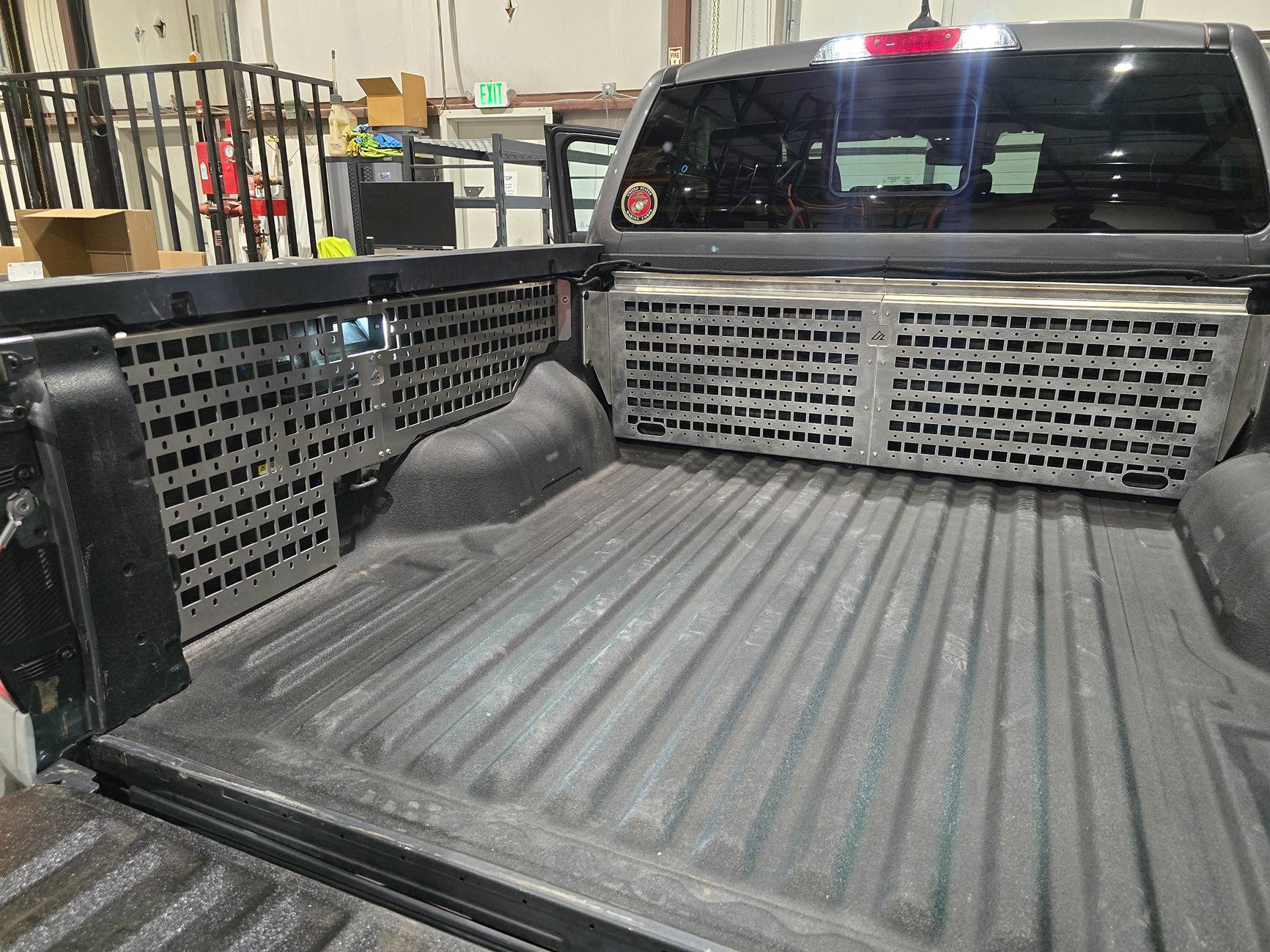

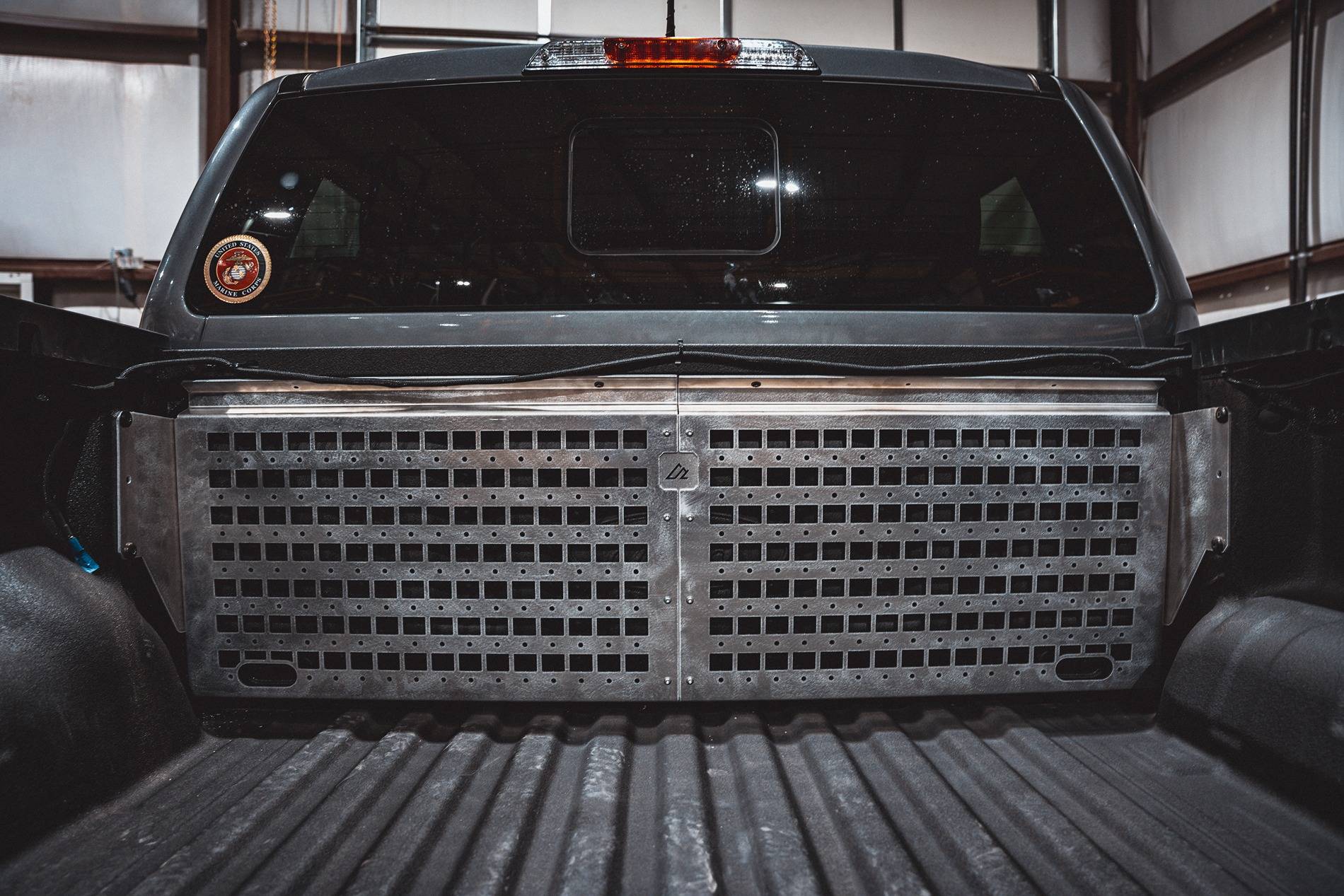

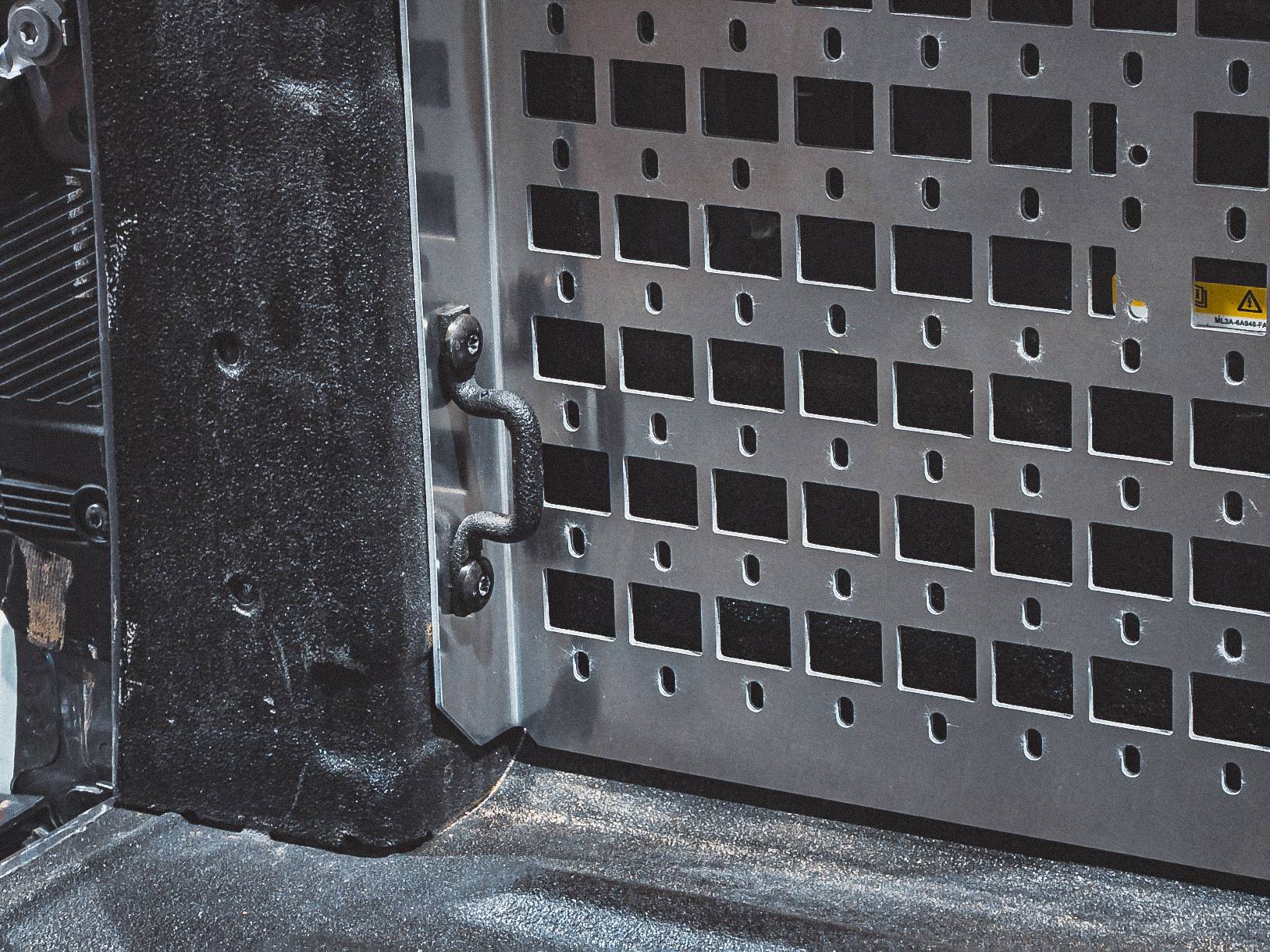

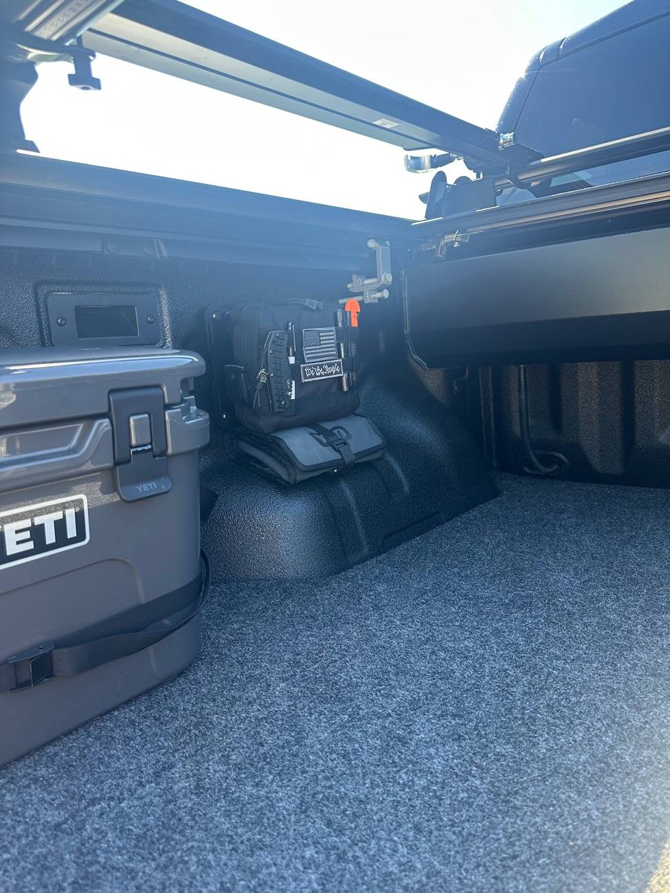

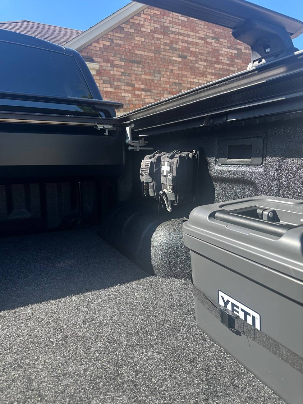

I had a very specific want. I used builtrights’s universal panels with rivet nuts to attach. Provided exactly what I wanted and no more.

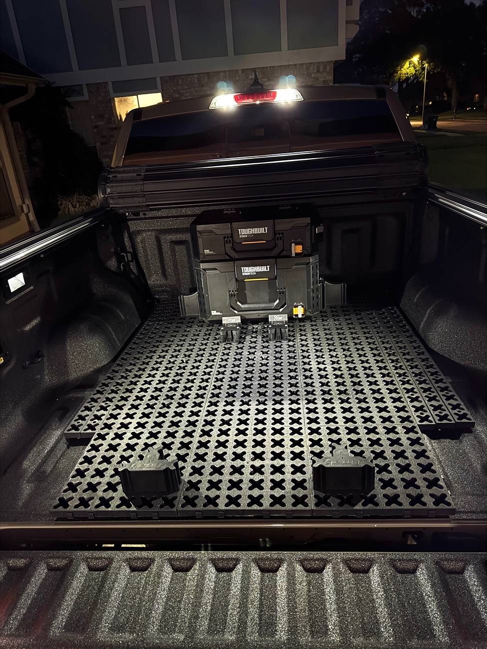

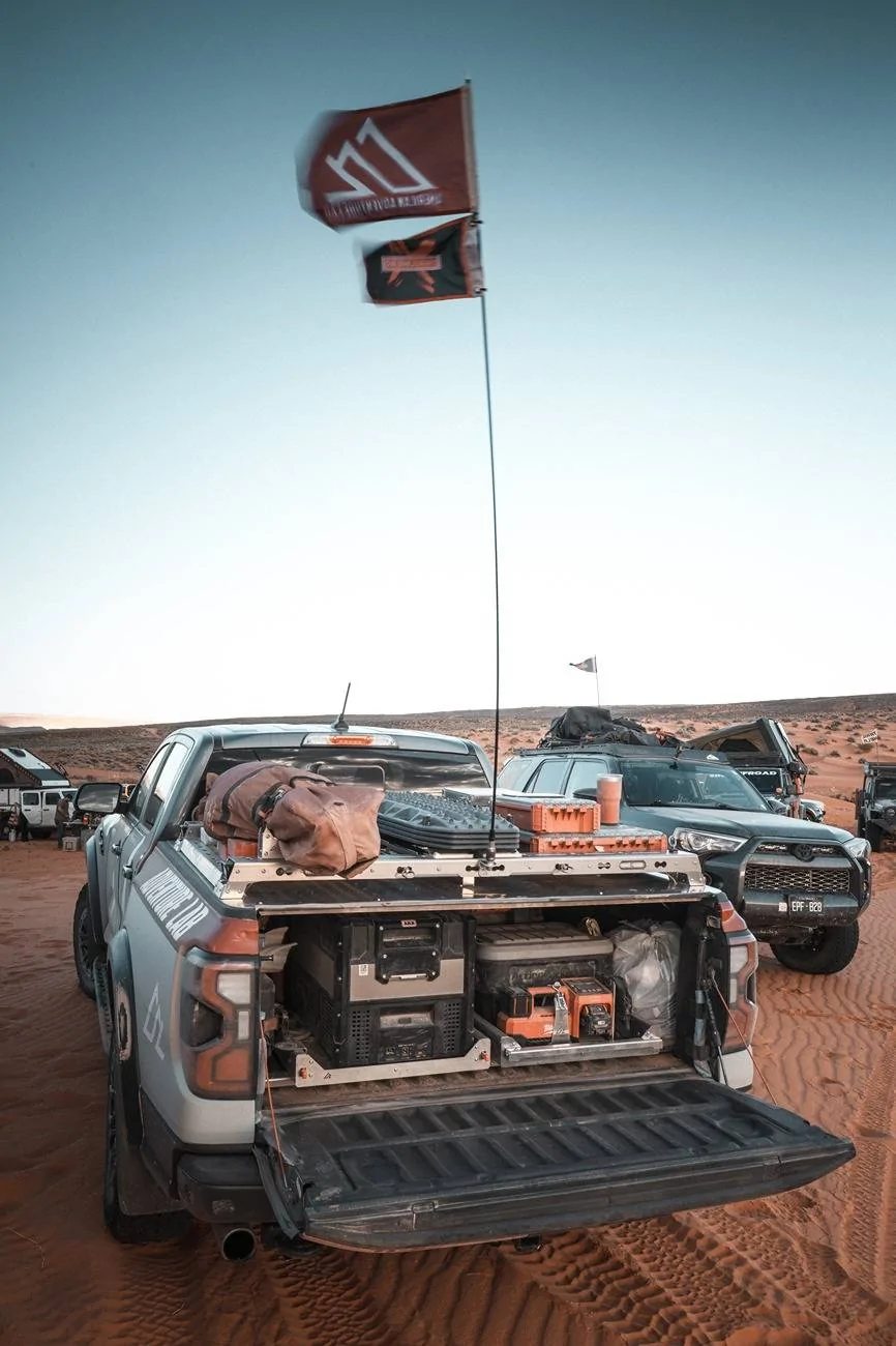

I made these today. They will be for sale in the next week or so. Lots of options coming for the rear half of the side panels (Packout, rotopax, power panel access, etc.)

Also, we will be releasing a fully bolt in floor rail system with tons of slider and drawer options coming.
