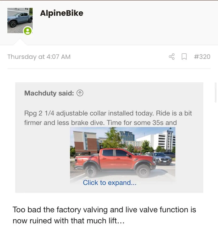

Pipe down son…
I don’t recall saying anywhere that lifting/leveling this truck is “ruining your suspension”.
From the What did you do to your Ranger Raptor Today thread…
Too bad the factory valving and live valve function is now ruined with that much lift…
a77cj7
Chris
Jul 25, 2023
147
259
Sturgis, SD
98 Ranger
Pipe down son…
Great memory. Maybe you are the one who should “pipe down” if you can’t remember what you posted.
Edit: screenshot at bottom
I simply stated that the shocks won’t perform how they are designed. And that is an undeniable fact.
From an engineering standpoint, yes. It will affect the shock tuning.
From real-world use, happy to deny it. My truck did not show any perceptible changes in ride or performance with the collars added.
All of these rationalizations about “only lifting it a little bit won’t affect it” are simply that. You’re own rationalizations…
Your reading comprehension is not showing strongly here. I said nothing about the amount of lift. I did however point out that adding weight well within the rated payload will change the ride height more than the lift. So are new shocks required for each new loading of the vehicle, or do they work just fine at the different heights? This is without getting in to how the additional weight or lack there of changes the ride.
Again I say, if you don’t believe me call Fox yourselves. But don’t start making statements about how you are smarter than the Fox/Ford factory off-road engineers. Cuz you ain’t and I ain’t!
Yes, lets ask the people hoping to make money off of proprietary-only modifications if we should buy stuff from them. Plus, you admit that they told you the difference wouldn’t be noticeable to many people.
If I can spend $3000 to buy a new set of front shocks to be “correctly tuned” for my ride height, or I can spend the same money to add bump stops front and rear and limit straps front, I will not choose the imperceptibly different shocks.
And yes, I did confirm that the factory trucks that competed in the Baja and those other various races had their shocks internally reconfigured for the change in ride height!
Once again, your reading comprehension fails. I stated that not only is it changed, but it is changed depending on what course they are running. The level of tuning required for race trucks is somewhat different than that of daily drivers.
I was not responding to you directly with the rationalization comment. I was responding to the multiple other people on this thread.
I’m not here to go back and forth with you.
Your comments about adding payload are also irrelevant. Static vs dynamic changes. Are you completing hells revenge while towing your 5k lb trailer? Didn’t think so.
Also, who said anything about $3k for new front shocks? Fox charges $175 per shock for a rebuild. I’d personally much rather do that than add bump stops and limiting straps.
PS: re-read my comment in your screenshot. I said the factory performance and live valve function is ruined. Not as you stated “the shocks will be ruined”. Please work on your reading comprehension before putting words in my mouth.
a77cj7
Chris
Jul 25, 2023
147
259
Sturgis, SD
98 Ranger
If you quote someone, you’re generally responding to them.
Did I tow a trailer on hells revenge? No. Have I run washboard gravel with significant raised cargates with 1500+ lbs of passengers and cargo? Yes. Did this change my ride height more than the lift? Yes. Did the truck handle it admirably? Yes, but bumpstops would be nice.
Sorry I dared to shorten your statement, but made it no less inaccurate. Is the factory performance ruined? No, it’s unchanged.
Is the live valve function ruined? No, it’s just running slightly out of designed center.

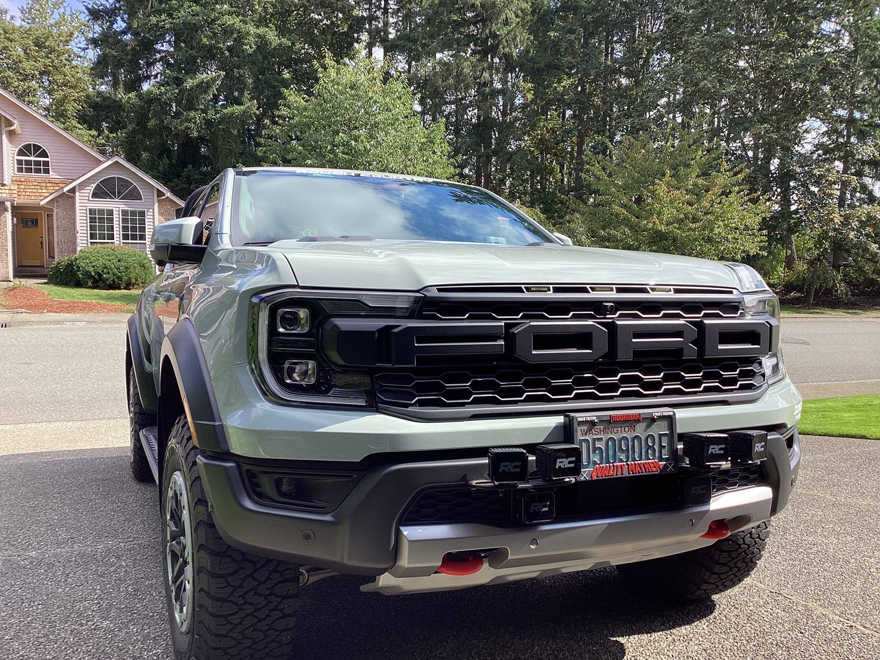

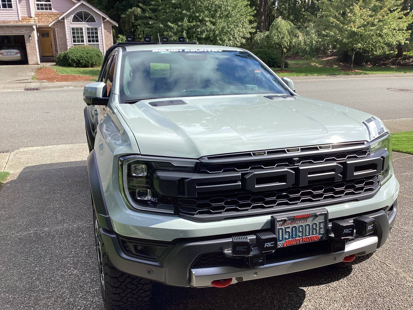

Well, I’m going to do a 1” spacer on Friday, guess my truck is @#$&@, lol!
What kit did you get? From what I can find, the Bronco RC 1" lift requires a top hat spacer as well as a new mount for the bottom of the strut. And the strut doesn't mount the same way as the RR.
Arsenall11
Feb 11, 2024
753
802
Maple Valley Wa
24 Ranger Raptor
Mechanical contractor
That’s the one, neted just over 3/4” of top spacer, but be measurement it was a full 1” higher in the front. Didn’t want 2” and the 1 1/2 required cutting the studs and rotating the top hat.
