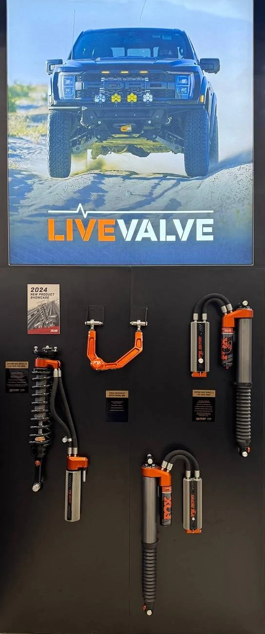

So I went to SEMA 2024 last year and spoke with FOX. They showed me the platform that is coming for the R/R and was amazing, it is a plug in play aftermarket OEM fit just like you said. There also releasing a FOX UCA. I will attached the 2024 F150 Raptor's new shock. IT will look just like this,

Any update on this?
Thanks.
I called a month or so and asked for an update and they told me the are “working” on it. So no clue. You can go to the website and go to: contact us, go to truck and they will send you to the guy that you can ask.
