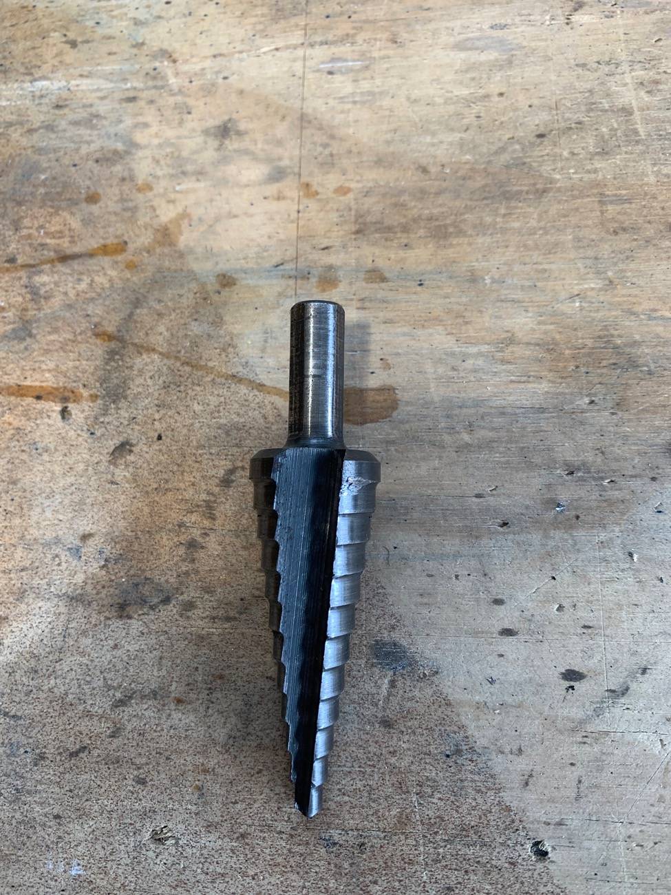

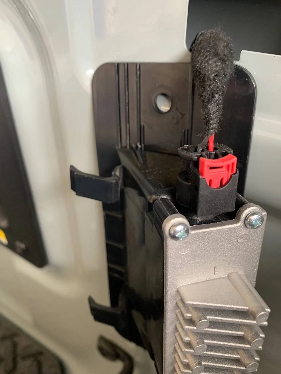

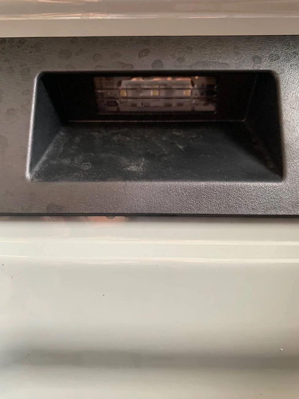

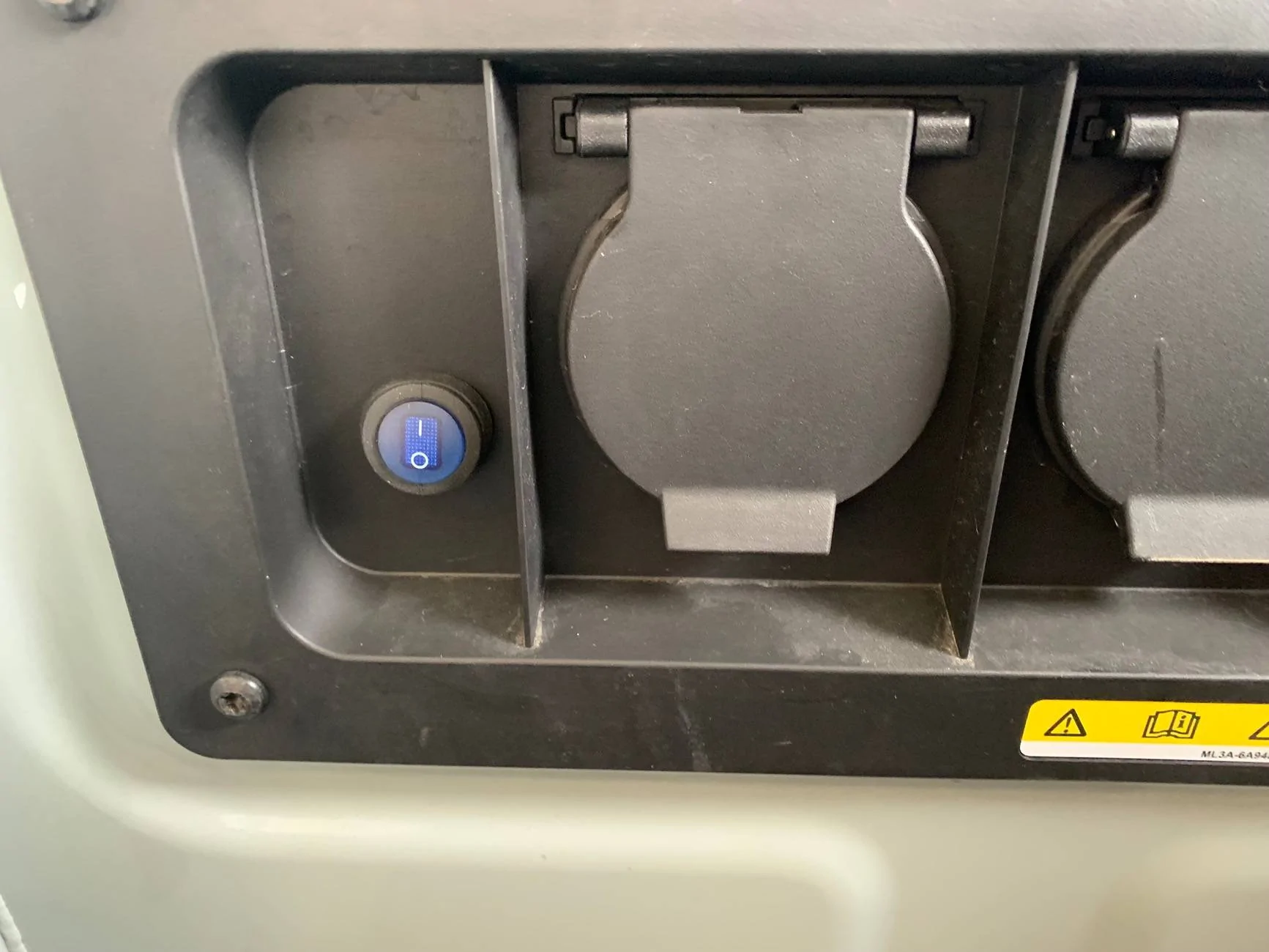

I am in the process of adding a remote bed light switch next to the power outlets in the bed. The 12v power outlet is where I plan on grabbing power. Remove the panel and drill the plastic to take a round rocker switch. Driver side bed lamp led has only power and ground so I will cut the connection and join new power and ground from the switch. This lamp has a couple of plastic tabs on the bottom holding it in. Will probably add some strip lighting as well. Work in progress with photos!
