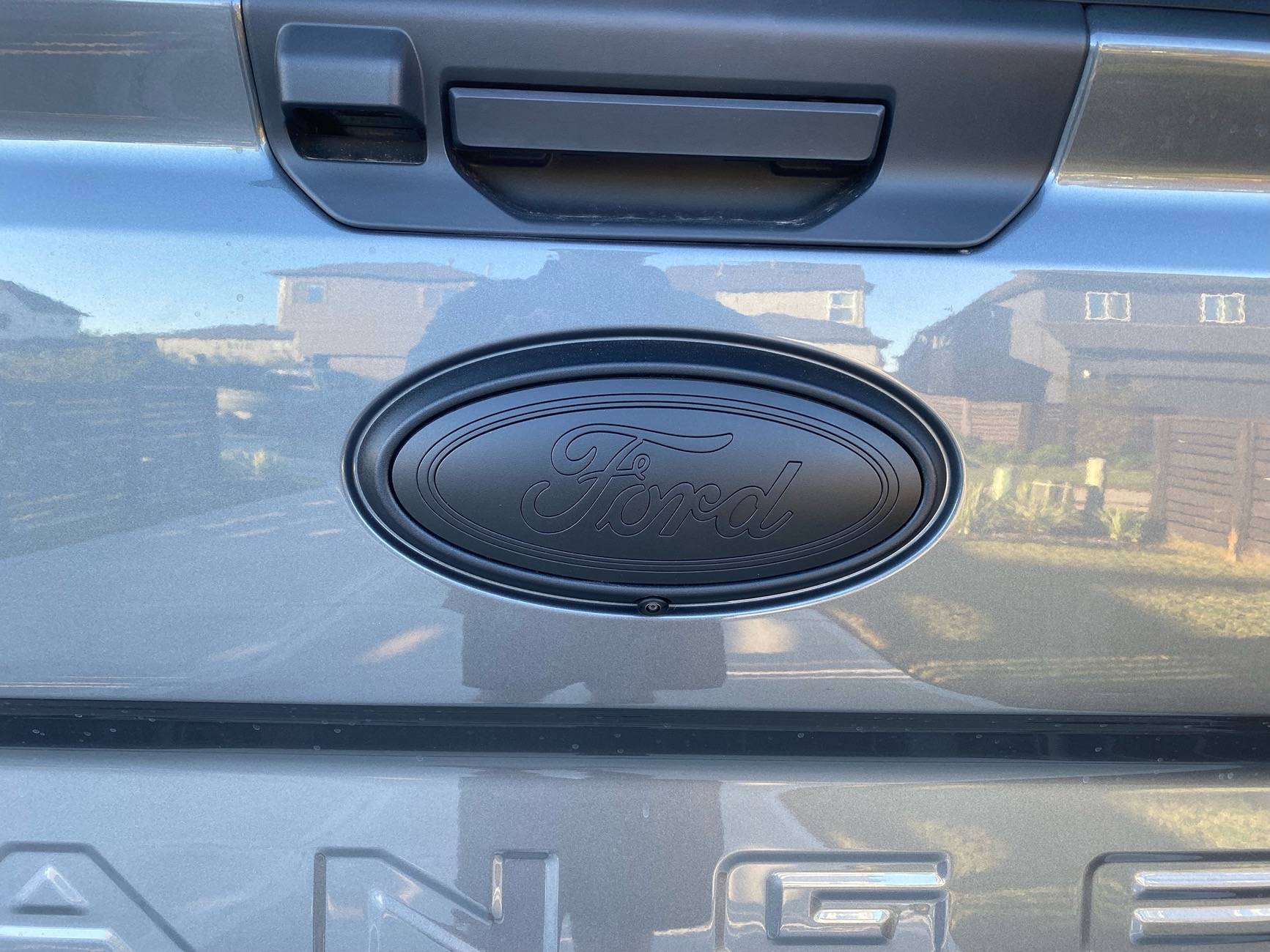

What's the process for that? Thanks.
Fairly simple. Mask off area, spray layers of Plasti Dip (you can find it at most automotive parts stores or home improvement stores), peel off excess around. Once dry, it will break at the hard edges around the emblem as you peel it off leaving a clean edge.
Look up Plasti Dip on youtube to see it.
I'll check it out. Thanks again.
