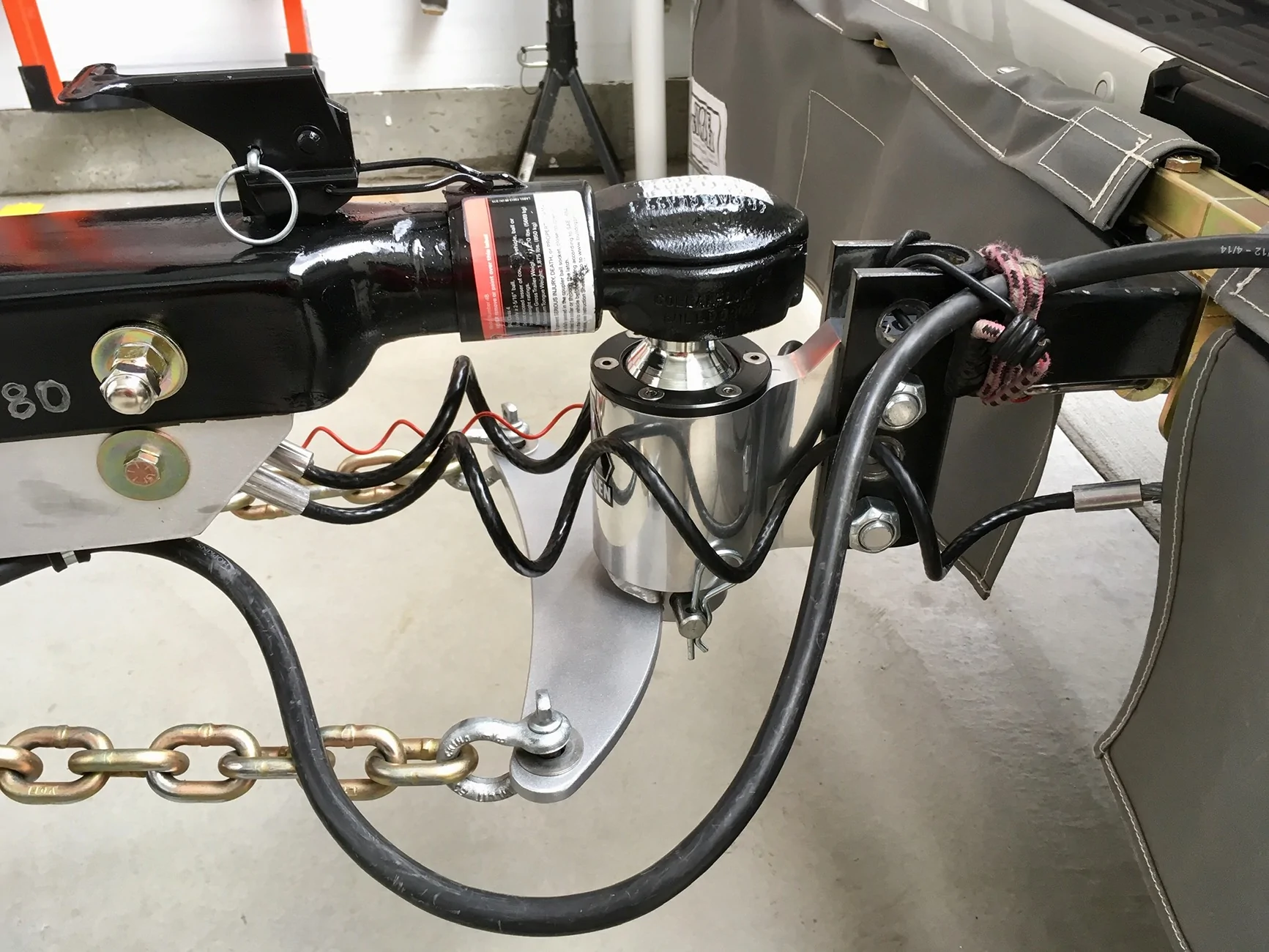

If you do decide to try a WD hitch, I strongly recommend an Andersen, it is half the weight of a conventional “steel bar” hitch, which will help with your very limited payload.
Andersen WD hitches
and BTW it is indeed Andersen spelled with two “E”s, it is usually mis-spelled in forum discussions.
I also highly recommend using a 2 5/16” hitch with an upgraded trailer coupler, it really helps with ball wear which can be an issue with this type of hitch, which “pushes” the coupler into the back of the ball as the chains are tightened. A forged Bulldog would be best in the long term…. I towed a 6000 pound Oliver for 35,000 miles with this setup, it was superb and trouble free. FYI:
https://olivertraveltrailers.com/fo...-bulldog-coupler-and-andersen-hitch-to-2-516/
John Davies
Spokane WA USA
Ford Ranger Can I tow a 5000 Lb trailer IMG_9418

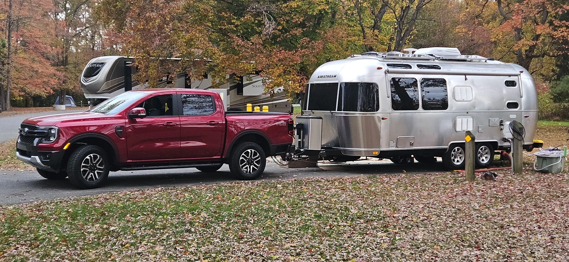

I tow a 23 ft Airstream which is 4800 lbs dry weight and about 5700 when loaded. The hitch weight is about 480 lbs, and yes I have a weight distribution hitch which you really need, otherwise the front end steering feels way too light and squirrelly. I have been towing various combinations for 40+ years and personally would not tow much bigger than this. 2025 Lariat, 2.7 and the advance tow package. Regards
Ford Ranger Can I tow a 5000 Lb trailer 20251029_084737
