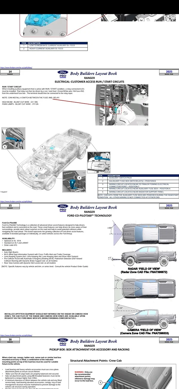

have you also checked the setting on the infotainment? driver aid I think? or vehicle. or somein. you can turn it off, aswell as turn sensitivity down on them
Ford Ranger Collision Avoidance in 2024 Lariat Seems to Have Stopped Working Screenshot_20250621_085001_Adobe Acrobat
