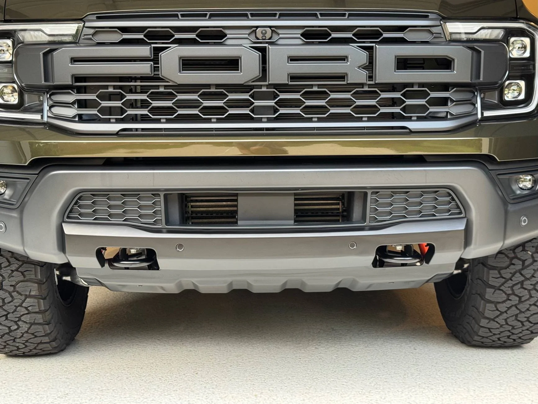

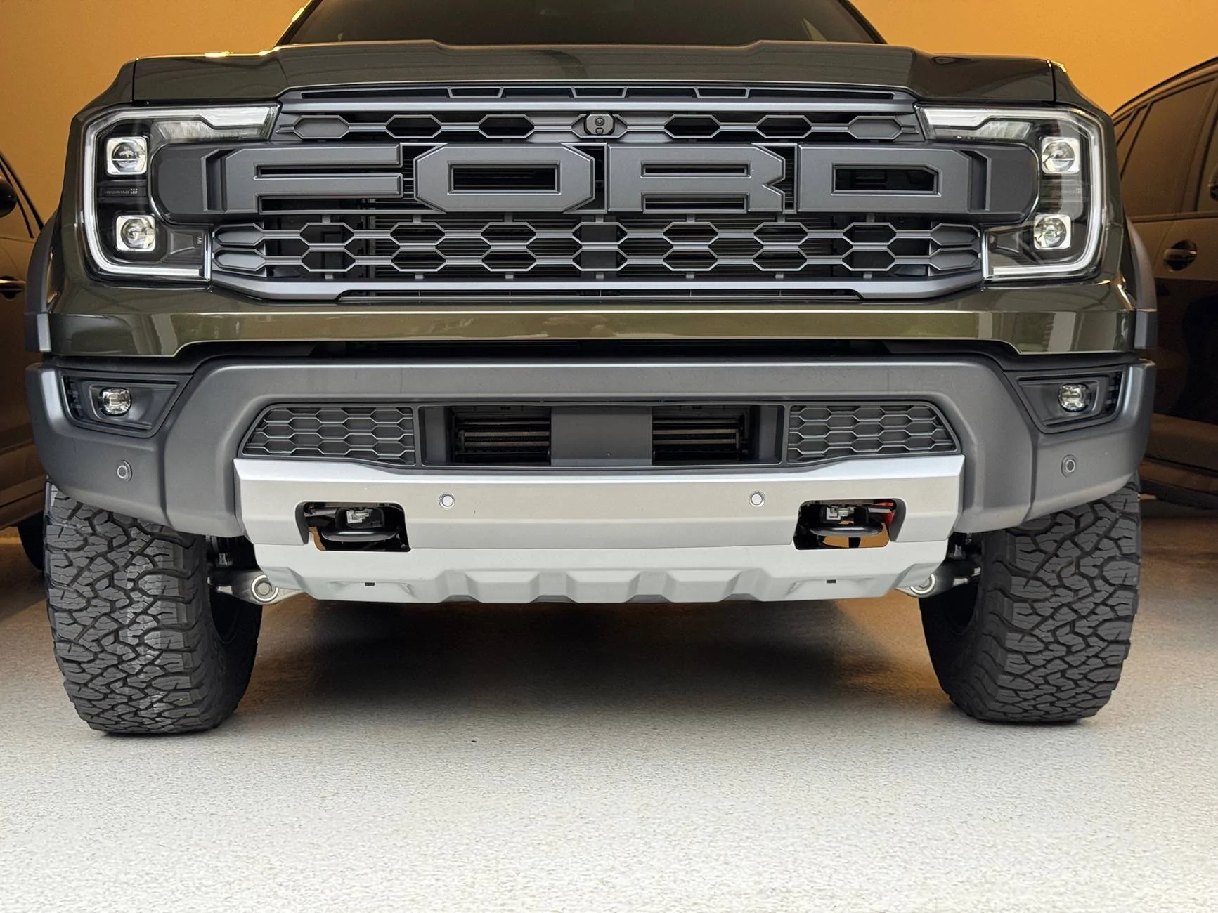

I wrapped the silver lower valence and silver front skid (bash) plate using “KPMF K75400 Matte Perfect Black Vinyl Wrap”.

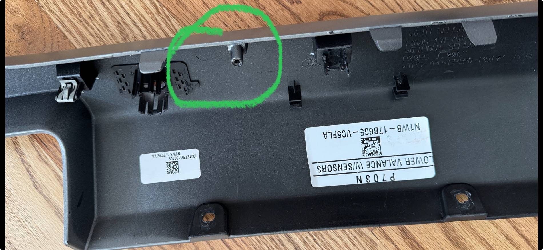

The black plastic piece directly above the valence does not need to be removed. The valence has five 10mm bolts on the bottom which are easy to locate. The trick is two T25 screws which are hidden. Once you know that they are there, you can locate them with your fingertip and fairly easily get a driver bit on them. I attached a photo with the screw boss circled in green (that is the valence).
I wrapped the sensors separately which only took a couple minutes.
The skid plate is 4 15mm bolts. I read a trick to just loosen the rear with did help with reassembly.
before and after photos attached.
