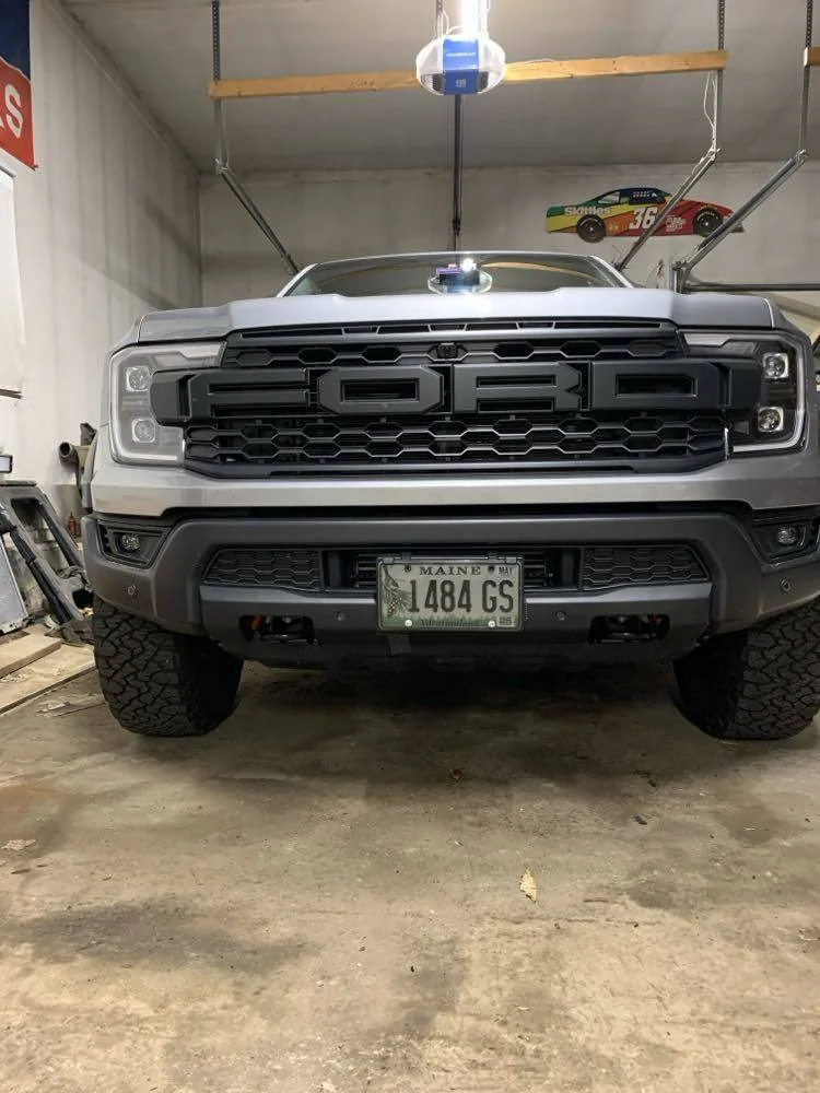

I did both mods to my Raptor. I PTM'd the skid plate and bumper trim to match the bumper and I did the license plate bracket flip mod. IMO both mods looked better than stock but my license plate bracket flip mod didn't work as planned. It blocked the front collision assist sensor so my front collision assist and adaptive cruise didn't work. :(
Is that Ernie Irvan's car on the wall?

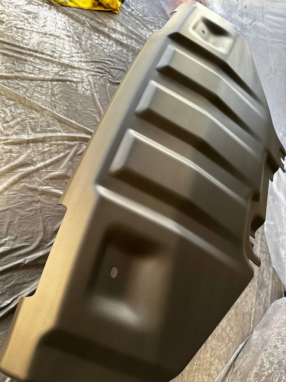

Well I finally did it. I pulled it all off and painted it. Color matches extremely well I ordered some Ford (JNV) paint and put it in a Harbor Freight paint gun. Here’s how the skid plate turned out. I’ll post a picture of the trim piece too when it’s on the truck tomorrow.

Once you take the trim piece off which isn’t very difficult you can pop the sensors out pretty easily and then remove the rubber grommet around them. I painted them separately. I just did 1 coat primer, 1 coat base and 1 coat matte clear because I was not sure how much paint would affect the sensors. But mine still work fine.
