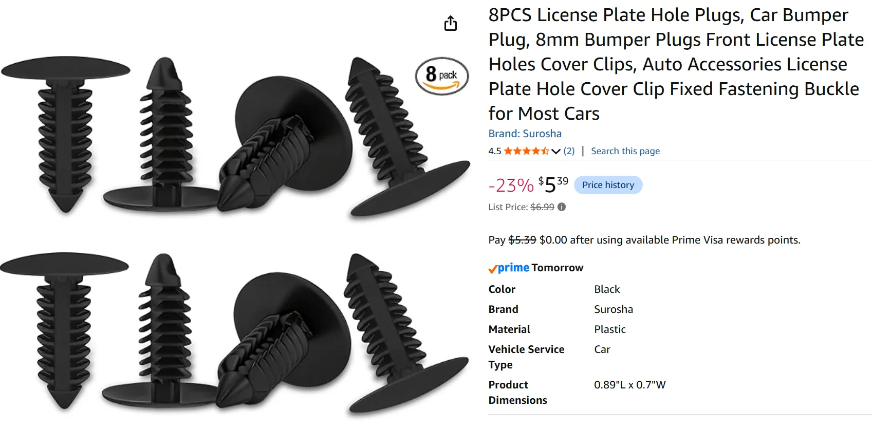

I used what natkill posted. I used a color matched paint to color match the heads of the plugs. Looks decent.

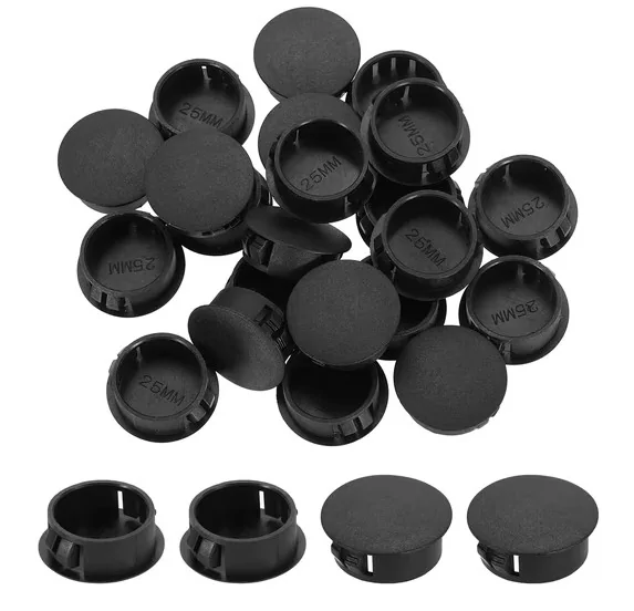

In the past I've used something like these. Available at most any hardware store.
Ford Ranger How to fill license plate holes in front bumper Uxcell-Black-Hole-Plugs-100pcs-1-4-Plastic-Plugs-for-Round-Holes-Nylon-Flush-Type-for-Furnitu

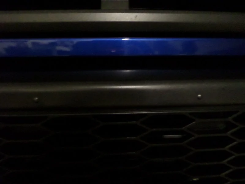

I used these to plug the holes on the front bumpers on my 2017 and 2020 F150 Raptors. I got them at Lowes and painted them grey to match the bumper.
Ford Ranger How to fill license plate holes in front bumper h4ZghzK
Ford Ranger How to fill license plate holes in front bumper SAM_0598
