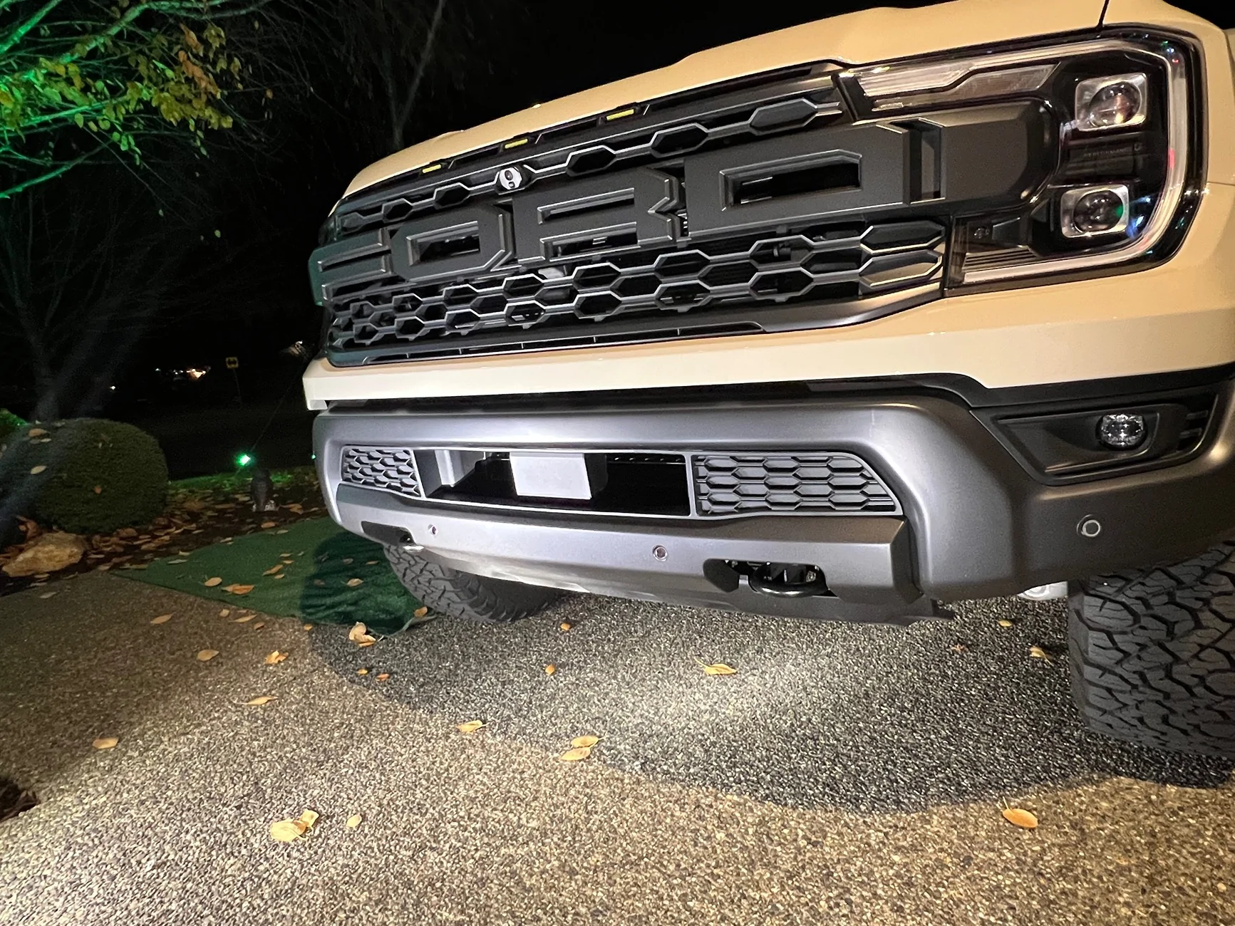

Not necessary, it's a simple masking job and Plastidip.
Thanks for this tip. I spent an hour trying to get that valance off to paint it, couldn’t get it to release in the middle. Instead to your advice and masked it and 1 can of plastidip ( for now ). Turned out great

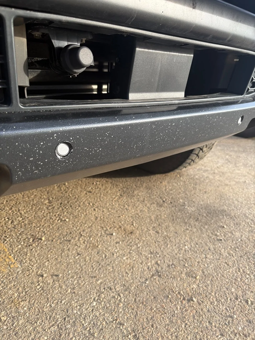

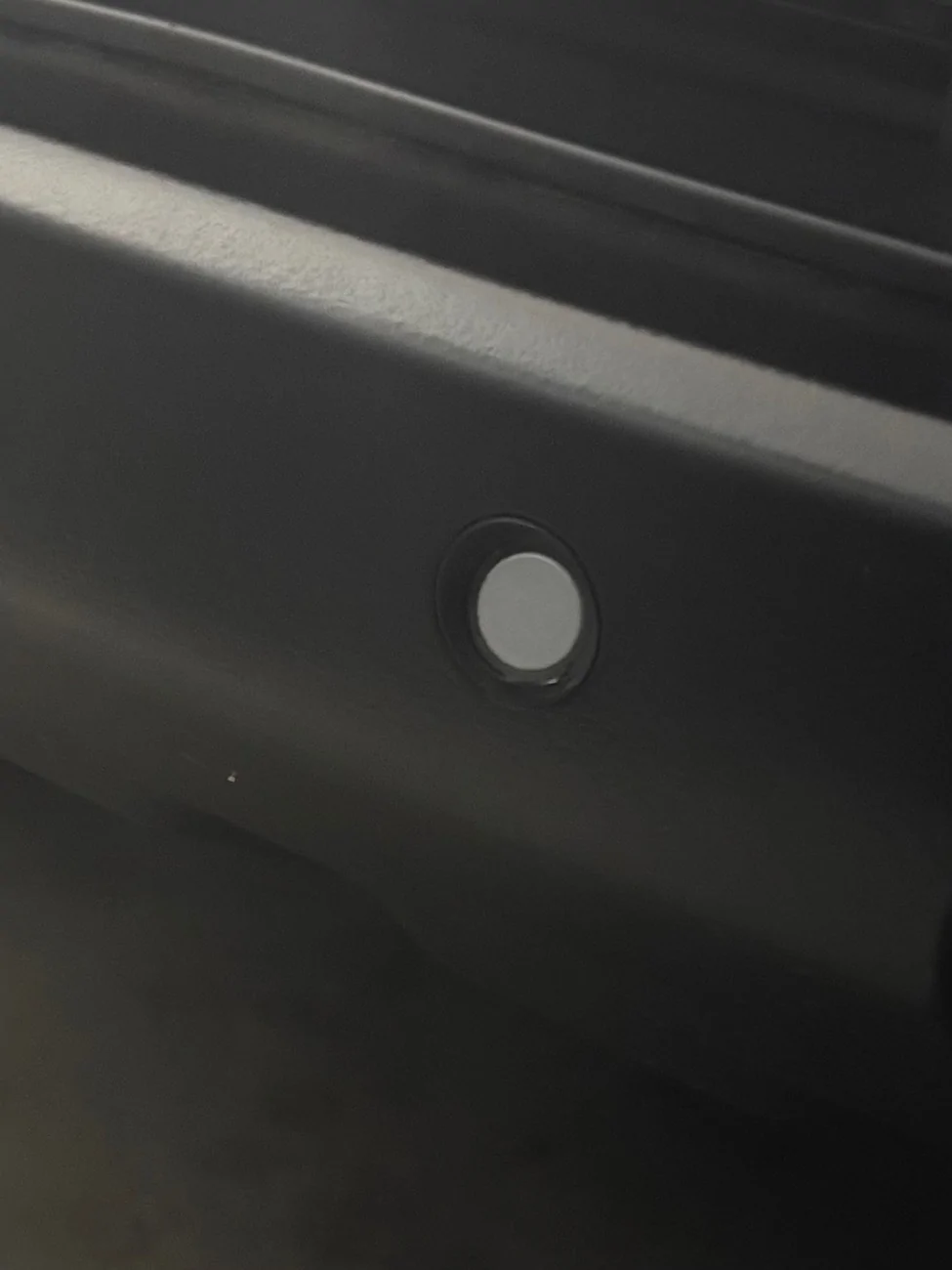

Hit my parking sensors with a sharpie so it wouldn’t affect any sensitivity. Zero issues and blends in at 2-3’ away. Easy to always touch up later.

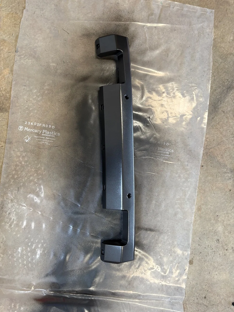

Buffed it down with scotchbrite.
2 coats of plastic adhesion promoter.
2 coats Krylon 5X Fusion textured black which turned out EXACTLY and I mean EXACTLY like the gray bumper & grill.
And this was off the truck & on the bench.

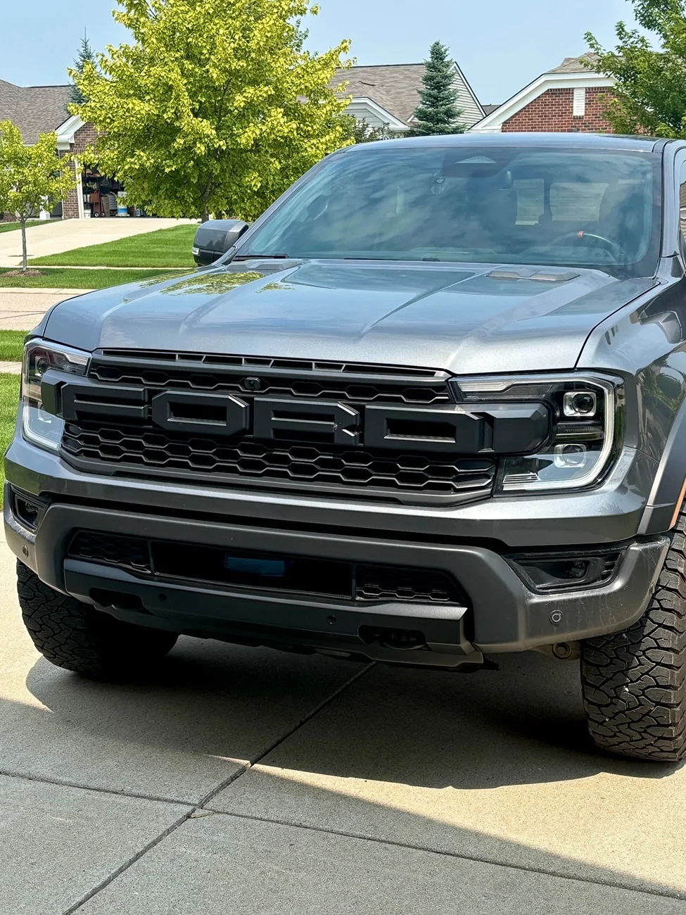

I painted mine last summer (pics in this post) and it's chipped to hell. Looks like it got shot with a shotgun. I do live in a area where the gravel the roads in the winter and do a lot of gravel road driving and hunting. It looks awful. Wondering if a wrap would hold up better or do I just repaint it🤔
