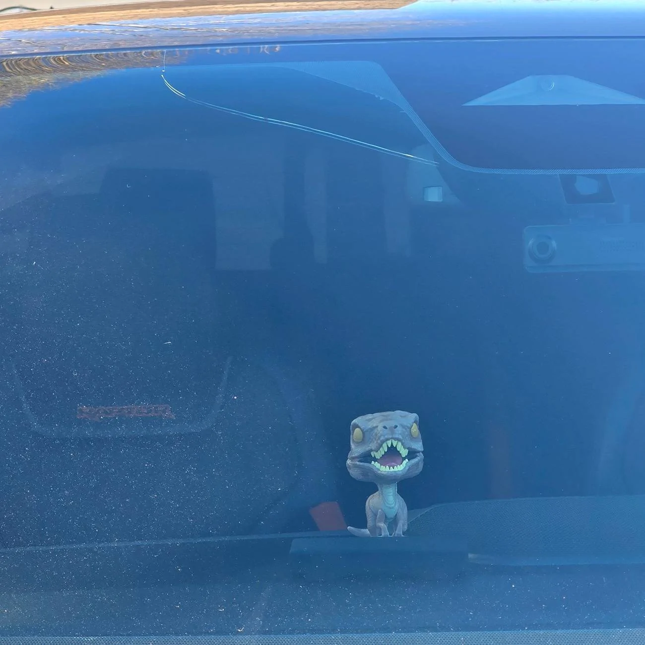

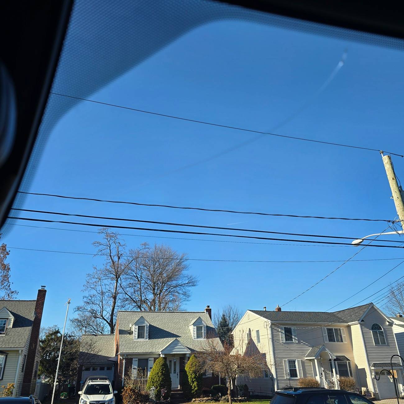

Anyone else unlucky? 1300 miles, it's a quick fix through my insurance just a headache
Ford Ranger Cracked windshield 1000011619
Ford Ranger Cracked windshield 1000011618

10,000 mile warranty if not caused by a chip or other damage. Mine cracked inexplicably in the first few thousand miles and Ford replaced it.

Damn, really? My dealership told me I was SOL

Worked at a dealership years ago and we had a ballpoint pen test. if you could "scribble" the pen across the crack and no where along did the pen find a spot where it clicked/caught on anything, then it was a stress crack and could be warrantied. Any place a stone or something damaged the glass, there will be a noticeable spot where the pen catches, you'll feel it, and that's where the impact happened = not warranty.

Is that a rock chip towards the top? Same happened to me on my last truck so close to the edge. The worse is when you drive a couple hundred miles to a dealership to buy a new car and get a huge rock chip on the drive home. Did that with a new Lexus a decade ago. Sucks, and I feel your pain.

Sure looks like that's the culprit. Probably would have heard when that happened too.

That makes perfect sense as to why mine got denied. I appreciate your insight

You are correct, sucks it happened to you as well

Zoom in on the photo and you’ll see it’s a rock chip.🇺🇸
