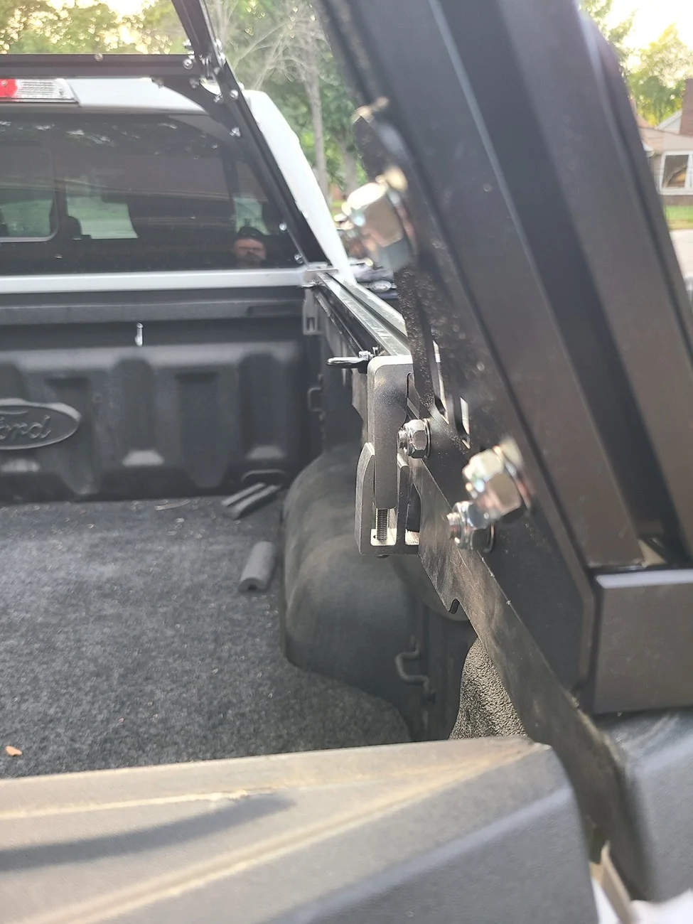

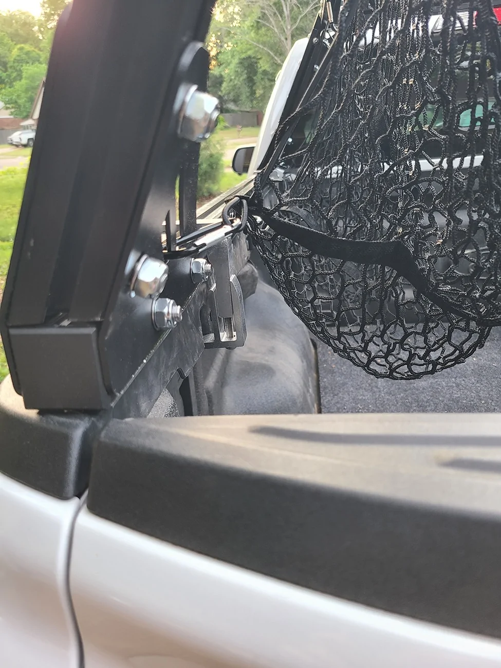

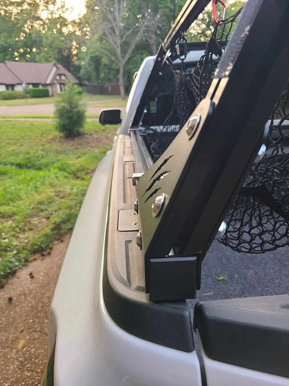

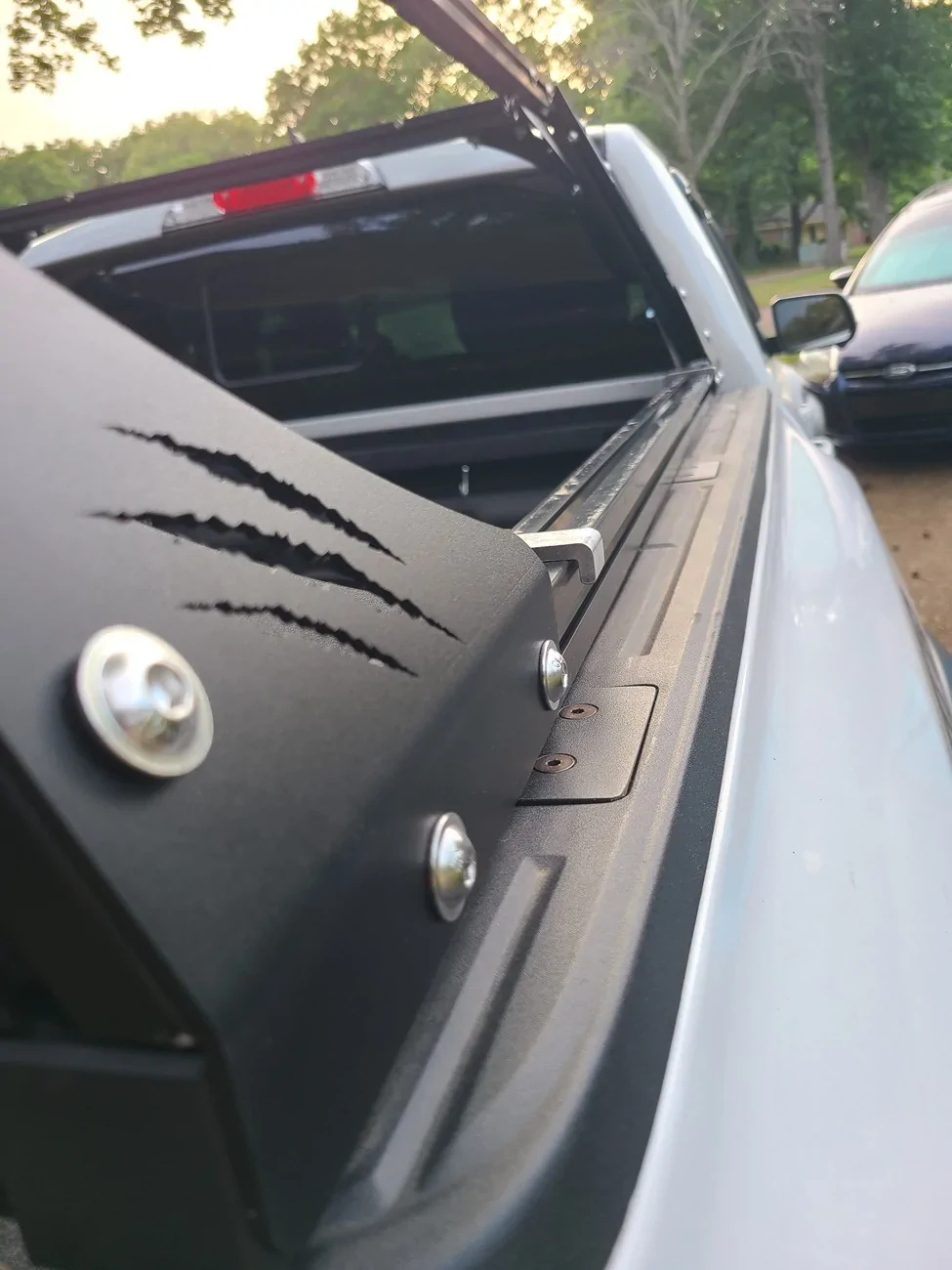

Got myself a Wildtop Beast for my RTT and gear, and after getting it on the bed, it looks like it should be wider to sit fully over the shims. Am I overthinking this?
Side note: Not sure it's readily apparent, but my bed rail caps cupped slightly from just two years of a light weight, soft fold tonneau resting on them. Definitely NOT structural. Bad form, Ford.

dang, you are barely on those shims. that is kind of risky looking

My thoughts as well. The weight really should be more centered over the shims. Nothing they couldn't remedy with 1" longer east-west rails and some wider clamps. I'm hoping they reply soon.
Only other negative is the rail slots don't have wide, in-rail slots for adding full size t-nuts and bolts after assembly. You have to plan your accessory mounting ahead of time with this design.

It looks more than a little sketchy to me, but I think you need to ask the manufacturer about it. It looks like the entire rack should be a couple of inches wider. I tried going to their website and got a “Server not found” error message.
If you did not already do this, you should definitely have anti seize compound on the threads, because stainless nuts with stainless bolts will definitely be risky in terms of galling, especially if you use a power driver to run them down snug. When one locks up tight, you must use brute force to remove the nut, a 2 foot breaker bar works OK, just break the bolt. It is best to avoid that scenario in the first place.

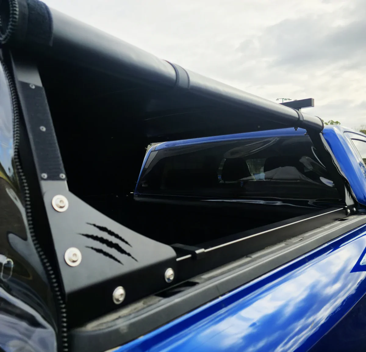

the pic on their site shows the base and clamps almost identically lined up like yours on the shims.
Ford Ranger Does this look safe? Bed rack mounting. 1776710434534-34
theirs
yours
This is one reason I favor a bed cover like Leer, which sits inside the rails and places minimal weight on them. The weight is largely carried by Leer’s own rails which mount inside of the bed. The cheaper Amazon covers sit entirely on these rails caps and can deform them over time.

Good catch. That looks like their scout model based on the rear window. That's not rated for much weight at all, maybe a sheet of plywood. But that's beside the point. I don't think the shims are going to like an offset load, but maybe the caps are sturdier than we thought?

i dont think the caps are sturdy at all. i put my shims and took the top plate off so my tonneau is a little lower and the caps are all funky shaped now. i think they are just for looks
