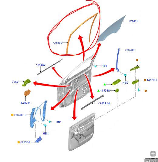

I had a lot of wind noise on my RR. I pinpointed it to the window glass run channel not sealing correctly. If I push it up into the corner of the door then close the window, the noise 100% goes away. Once I roll the window down, it slightly pulls the channel with it and upon closing the window, the noise returns. I have to keep pressing the channel back into the upper corner of the door. Is it the run channel or the door? Don't know - suppose I'll find out soon enough.
I am likely going to replace the run channel myself as I really don't like bringing my vehicles to the dealer - too many bad experiences. The part is relatively cheap. The last thing I need is for the tech to beat on the truck trying to replicate my complaint and then messing up the door trying to replace it.
Thanks for the info. That is exactly where the wind noise is coming through mine also and the dealer actually replaced that window gasket. And they actually made the noise worse.
Maybe they didnt seat it all the way up to the top of the of the b-pillar side of the door/window frame.
I found that if you pull the channel out of the window frame (on b-pillar side of front door) just enough so you can pull it up out of the door maybe 3/8" and push the extra material to the top of the door frame, then reseat the channel, my wind noise goes away 100%. I don't know if the channel in the door is too wide and doesnt hold onto the window run channel tight enough, or if the run channel itself is bad.
However, once I put the window down, the noise returns...
