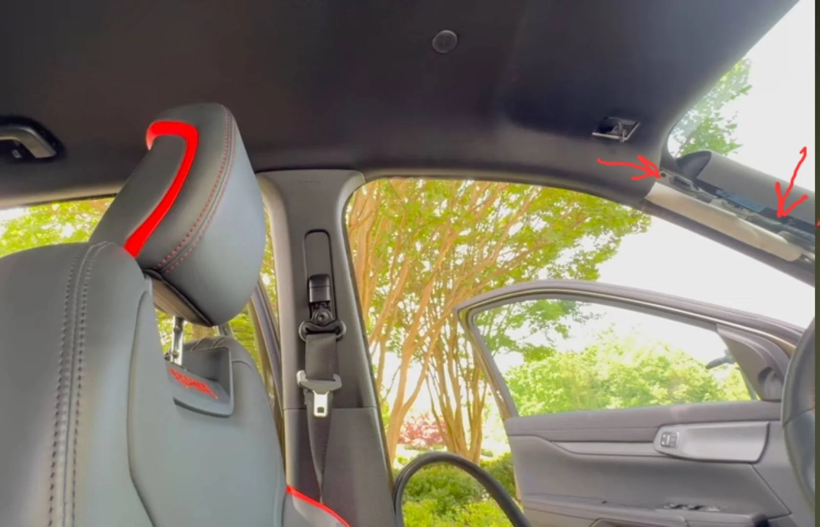

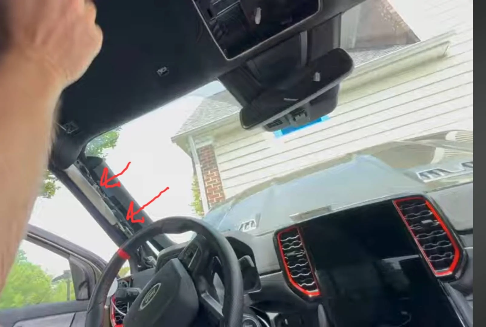

I got some still shots from the video that that one guy posted, and I looked for steel in there, and I see some spots where we can fab up something to hold the handle tie holes too.
Have to really take one of these off to look at it first and I don't want to do it to my wife's but when mine comes in in a couple weeks, I'll definitely be brave enough to take mine off and see if it's doable.

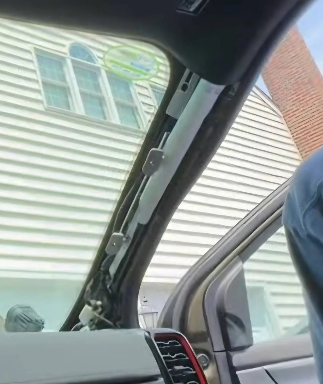

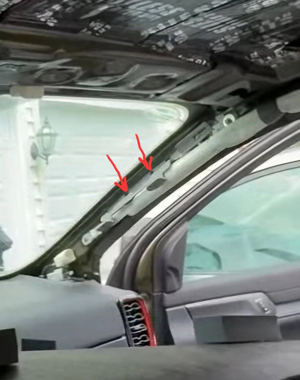

Sounds like a good plan. Be careful if you go the weld route, try not to burn anything. I found a better shot from the video and you can clearly see the North American version handle holder is riveted on just like the one in the foreign picture you posted. Don't give up the ship my friend!

This has been an issue for quite some time now. Here's a video of some guy putting one on the driver's side of a 2014 European Ford Ranger. If the stampings are the same for every country's Gen6 Ranger, then this is doable.......
