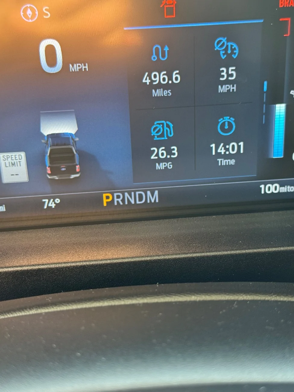

This is awesome. I am really wanting to get one of these tanks. I have a 2024, and cannot find reliable information on how to update the DTE on my model year, only people saying what to do or who to contact for 2025+. Anyone know how to do this on a 24?

jsut that one guy is the person in the know. no one has figured it out other then him, stanghi

unless i missed the posts, yes. that is what has kept most people from doing this upgrade

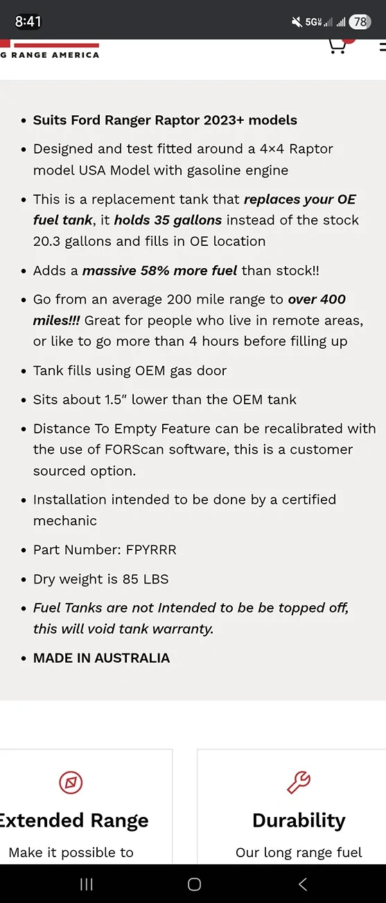

I have one sitting in my garage waiting to be installed. Pretty sure Long Range America has a link in their install instructions on how to update the DTE using Forscan.

I thought there was a discussion around here that there is a difference in how the programing of the 2024 works compared to that of the 2025.
My understanding is that the if you have a 2025, you will need Stanghi to help program the trucks computer.
Where if you have a 2024 it was my understanding that it could be recalibrated through a Forscan program /devise.
That there was a difference in how the fuel capacity and DTE data was setup in the 24 vs the 25.
I believe that was for certain vehicles like F250. For 6g ranger i believe its across the board. They did that change before this generation. I can confirm that there is no easy forscan way ~currently~ to do it. I have a ‘24
Ah, good to know.
Thanks
