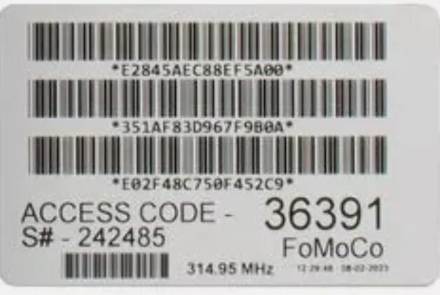

The Factory Key Code location to reset the door keypad is under the dash near the driver-side foot pedals. I used my phone to take a picture of it. It is hard to see physically but taking a pic with the flash worked for me.
Ford Ranger Factory Key Code Location 2024 Ranger Raptor 20250310_143403

This code on the back of the bcm and the card over the fuses bcm the does not work, as there is no physical connection with the keypad to the bcm.
The card in the glove box that looks like this is the one for the wireless pad.
Ford Ranger Factory Key Code Location 2024 Ranger Raptor 1741672170824-c9

Note, for my RR, the factory code on the card (truck documentation in the glove compartment) was different than the code under the dash. The "card code" did not work, the under dash code did work to resent the keypad.
