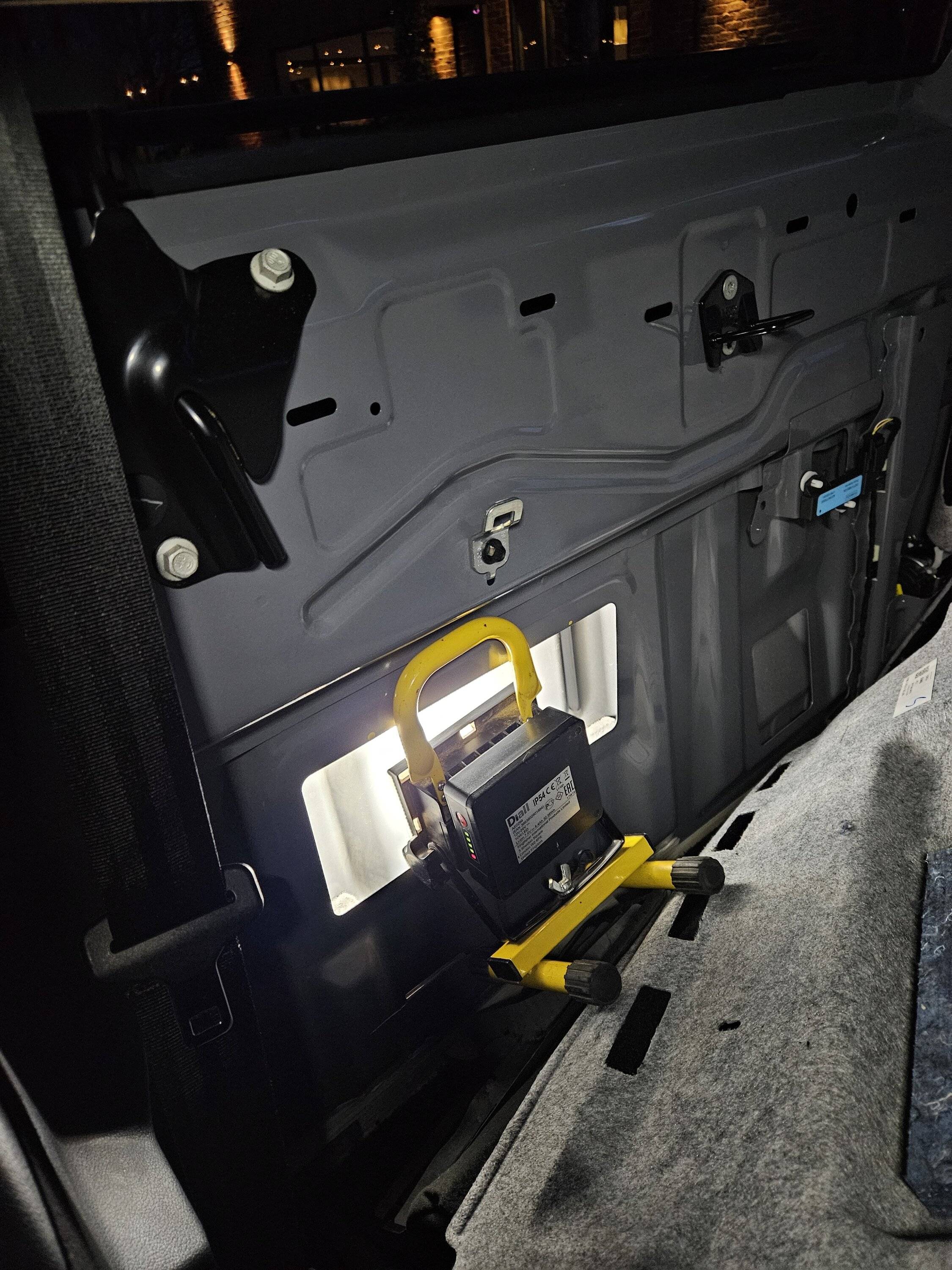

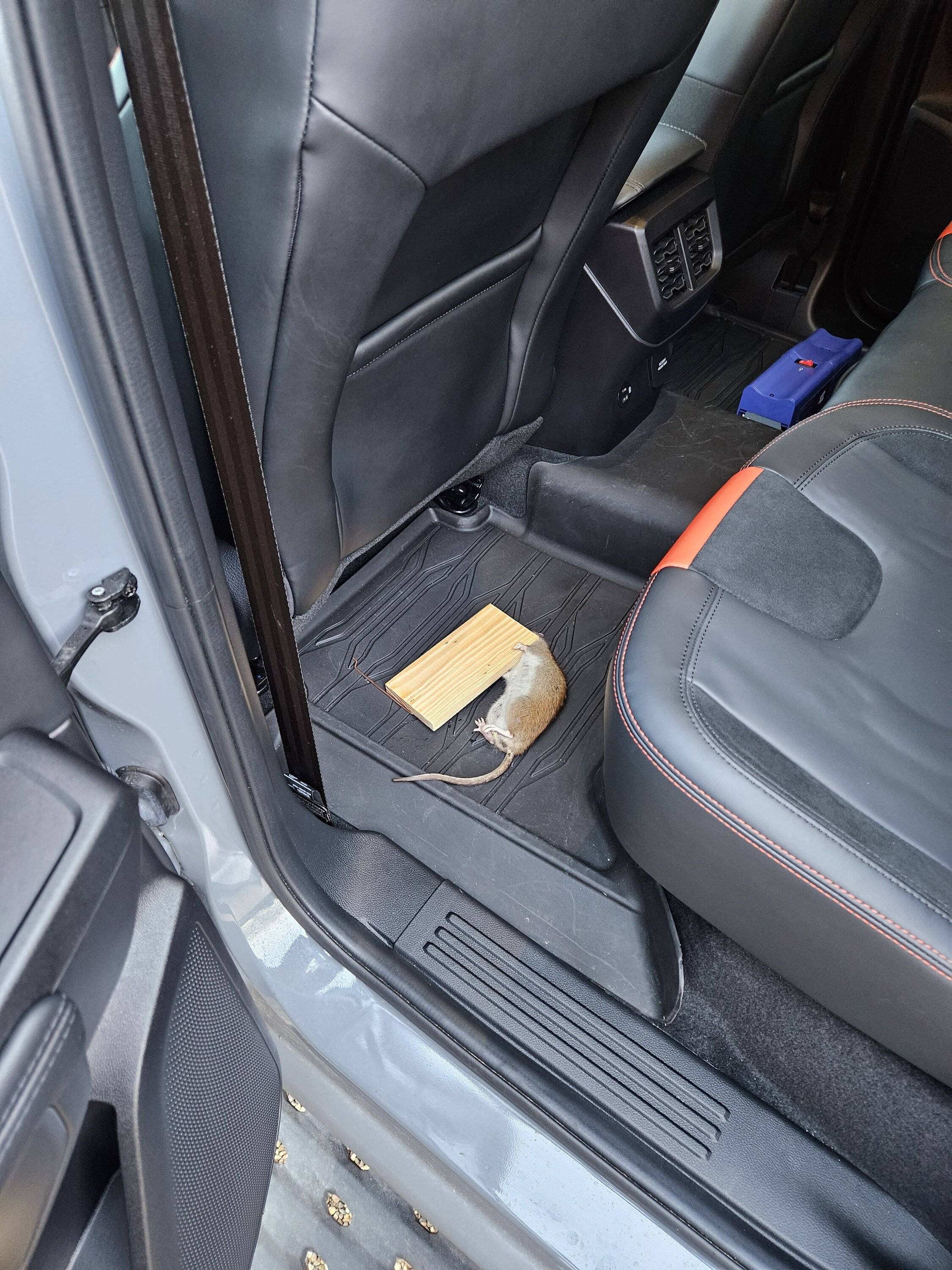

Had a rat gain access to the cabin and cause some damage, including driver, passenger leather seats, seat belt, cup holder & child's car seat.

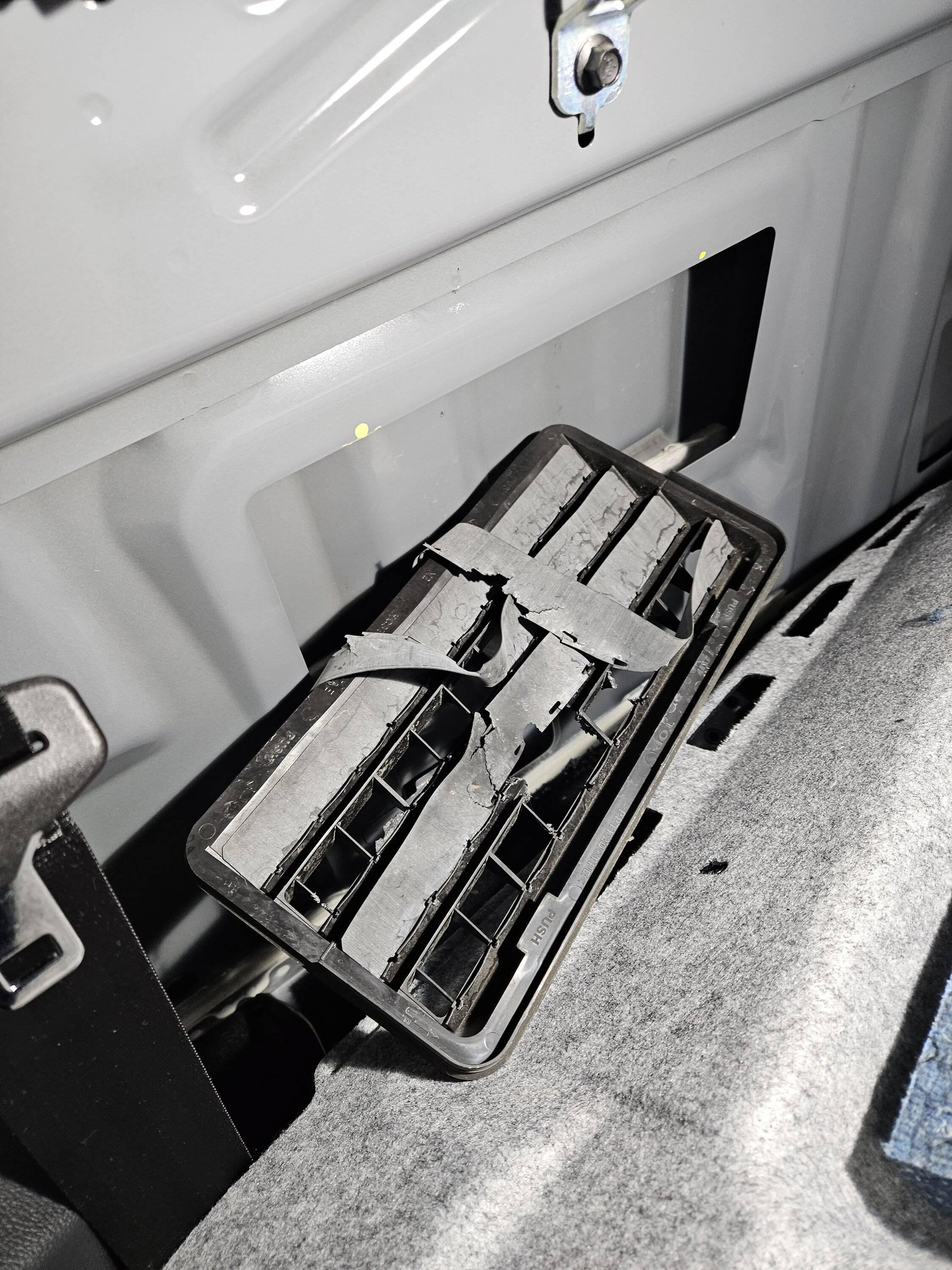

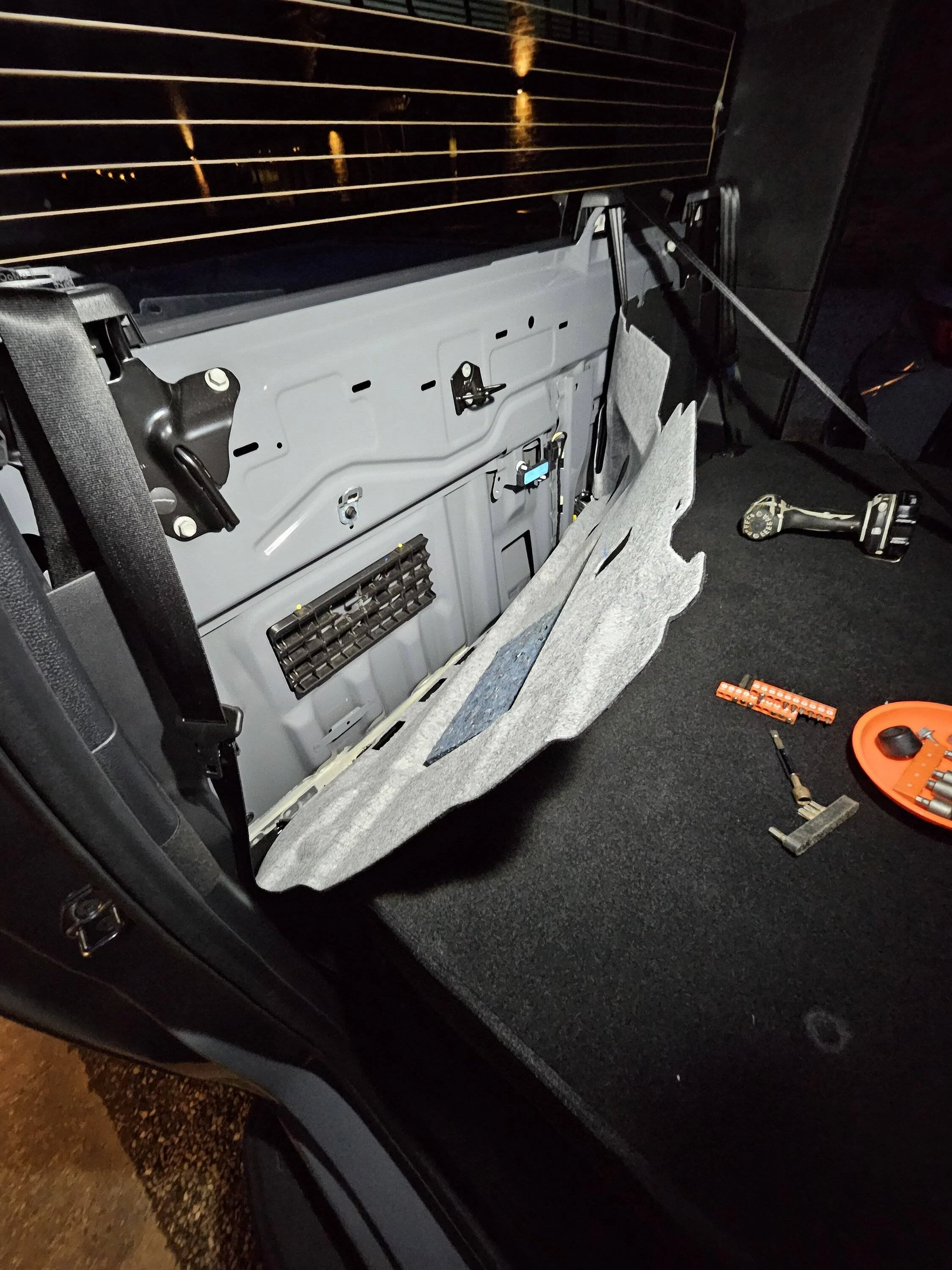

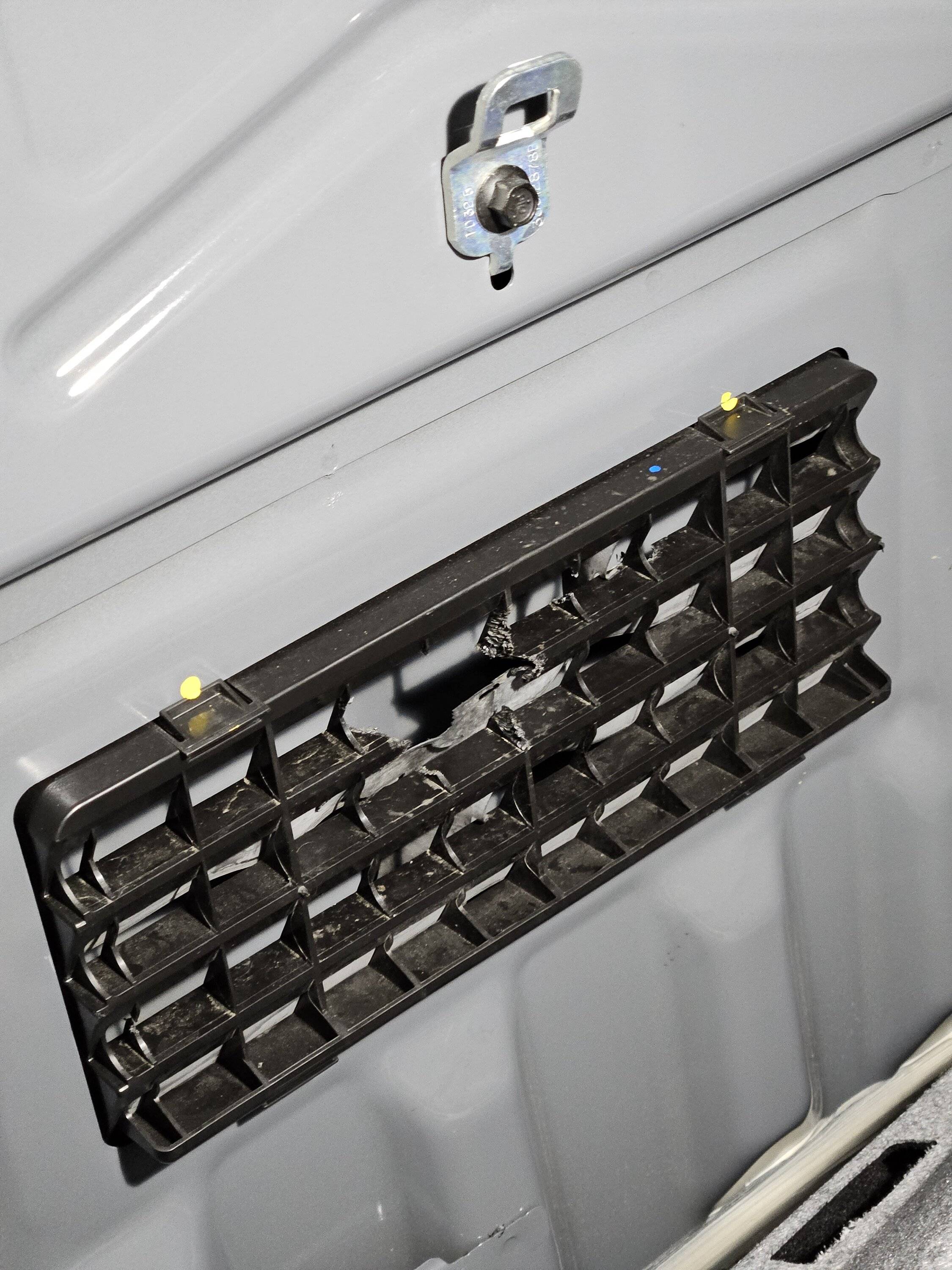

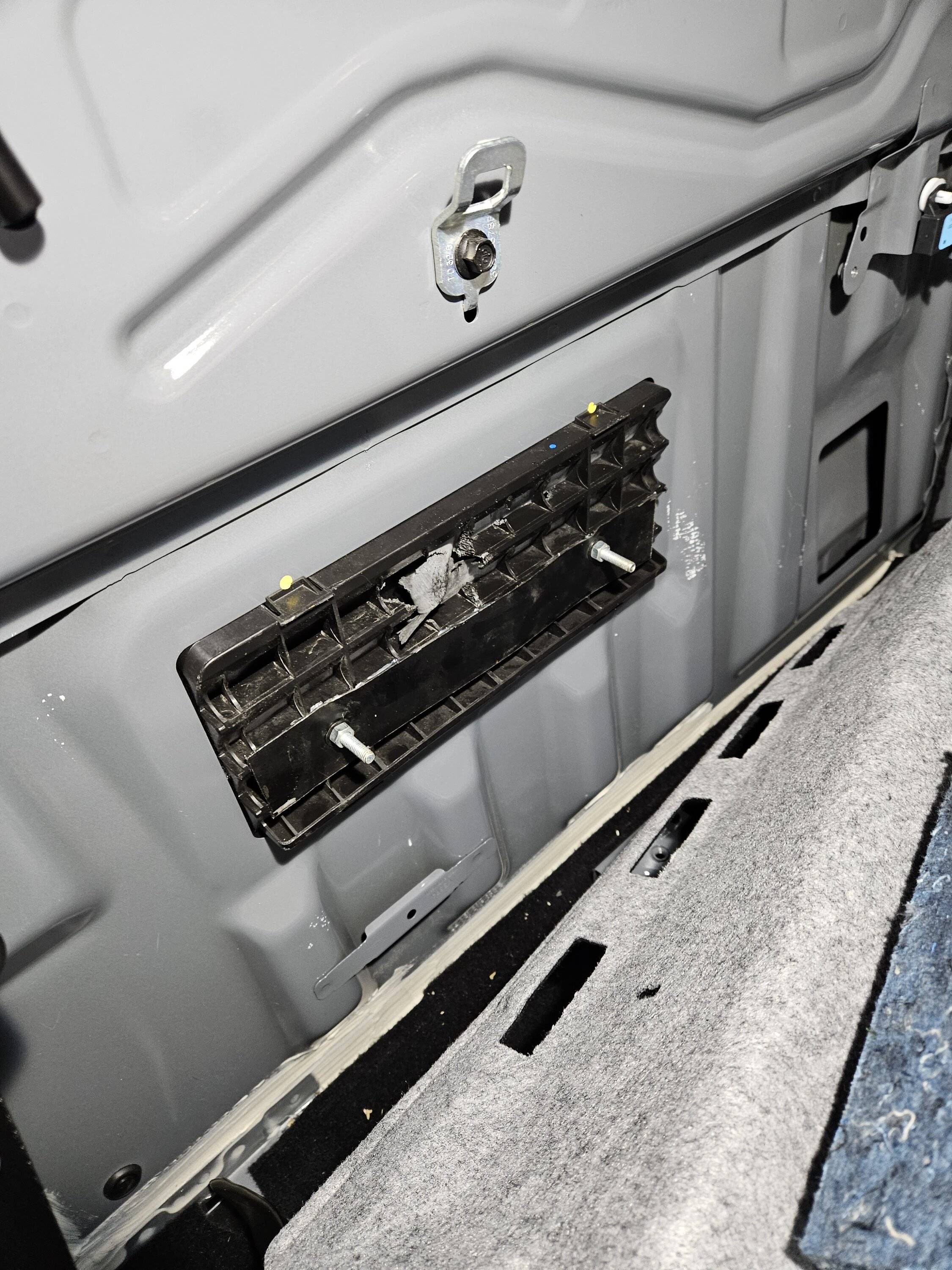

I idenfied the entry point behind the rear bench seat, the bulkhead has a plastic vent, the rat chewed through this and entered the cabin on a few occasions. Just letting owners know incase they experience anything similar.
Having a chat with my local dealer next week to see what can be done. I have temporarily sealed the vent with some metal plate to prevent anymore unwanted visitors.
