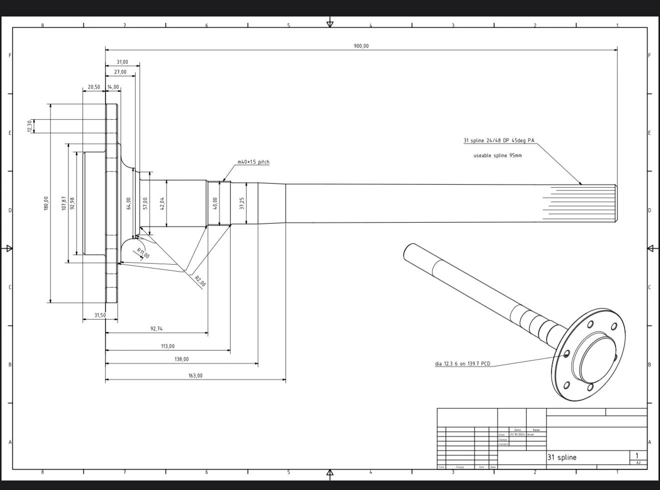

thanks for posting this. I have found info online that said it is a 8.9" AAM axle, and other places say it runs the m220 gears like a Rubicon.
Does anyone know the spline count on the front and rear axles?

Have this. Hopefully it helps. Some reason the front/rear axles are one of the great mysteries of the world.
thank you !
So 31 spline, AAM rear end with 8.9" Ring gear.
Do you know what the front end is?
