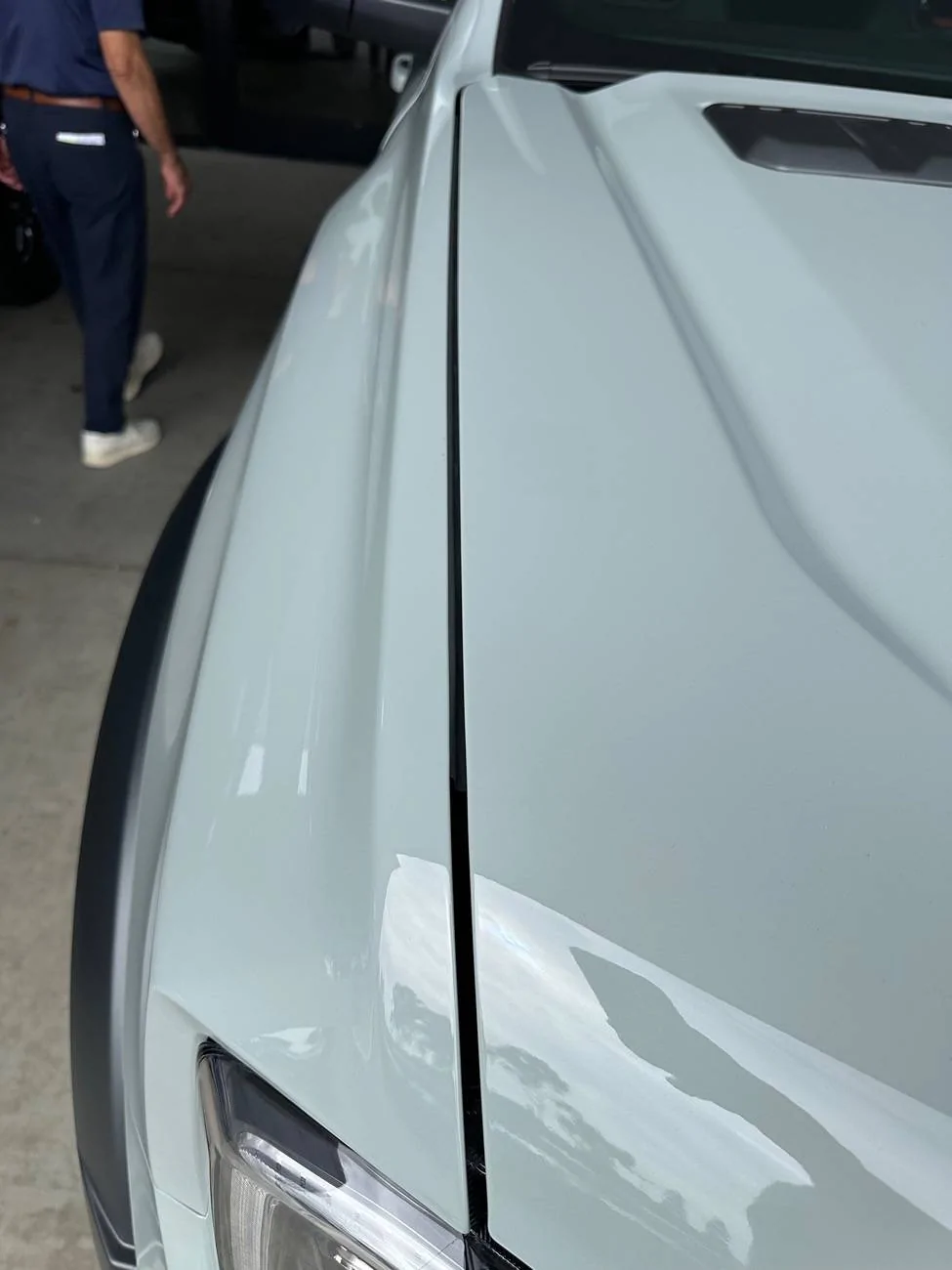

I have a slightly misaligned panel gap on the front of my hood but overall, I don't have any build quality issues I've noticed. I did have a connector on the back left of the bed that was disconnected, not sure if it came that way or if someone messed with my truck.
I do as well. The passenger side gap is bigger. I'm having the dealer sent it to a body shop to have it aligned before I have them adjust the hood latch to see if that's why the hoods on these are not shutting on these.

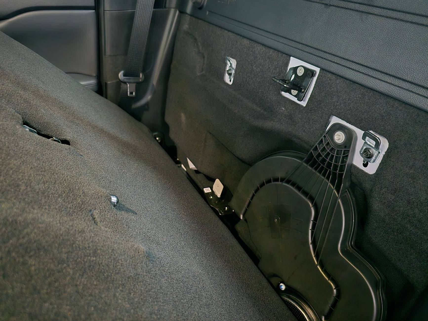

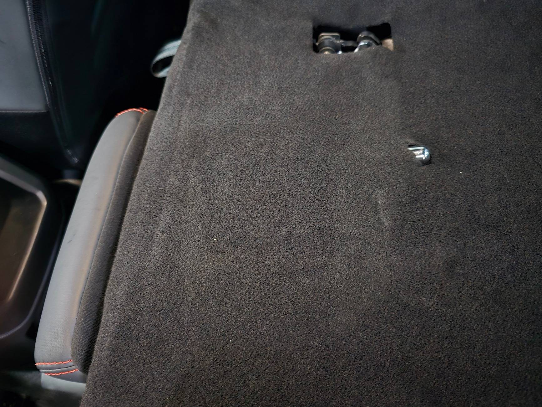

My rear seat had to be slammed to latch. The dealer found it was due to the middle head rest leg hitting against a bracket. It also punched a hole through the rear carpet which I had not noticed. If you rear seat is hard to latch, try raising the middle head rest as it maybe preventing the latch from engaging easily. I'm going to remove my middle headrest. The way the legs angle seems like it could be a problem to the carpet even without the bracket interference.

My '19 Ranger had a similar issue with the backseat needing to be violently slammed to get it to latch. The dealer tried a couple of times to realign it but we all just gave up on it because that was something I wouldn't interact with very often. Of course, that's where I decide to mount my relays, fuses, and control circuits for my secondary battery and lights/accessories so I was in and out of it for a couple of months getting that wired up...

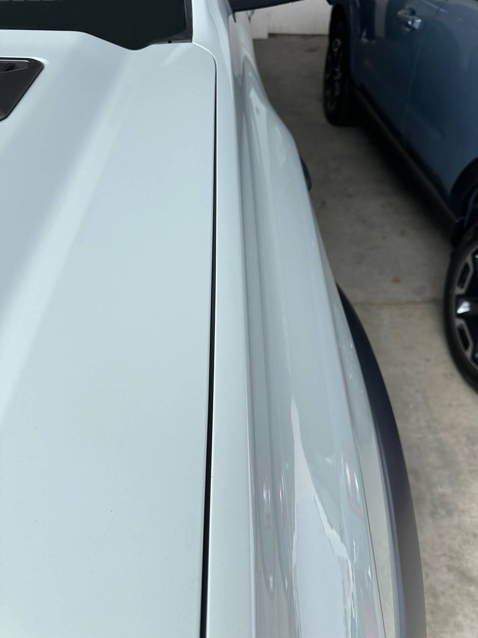

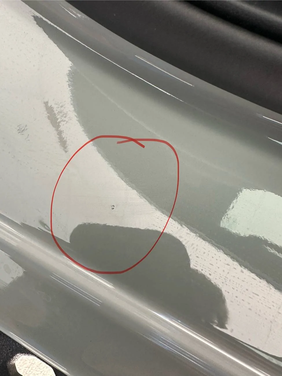

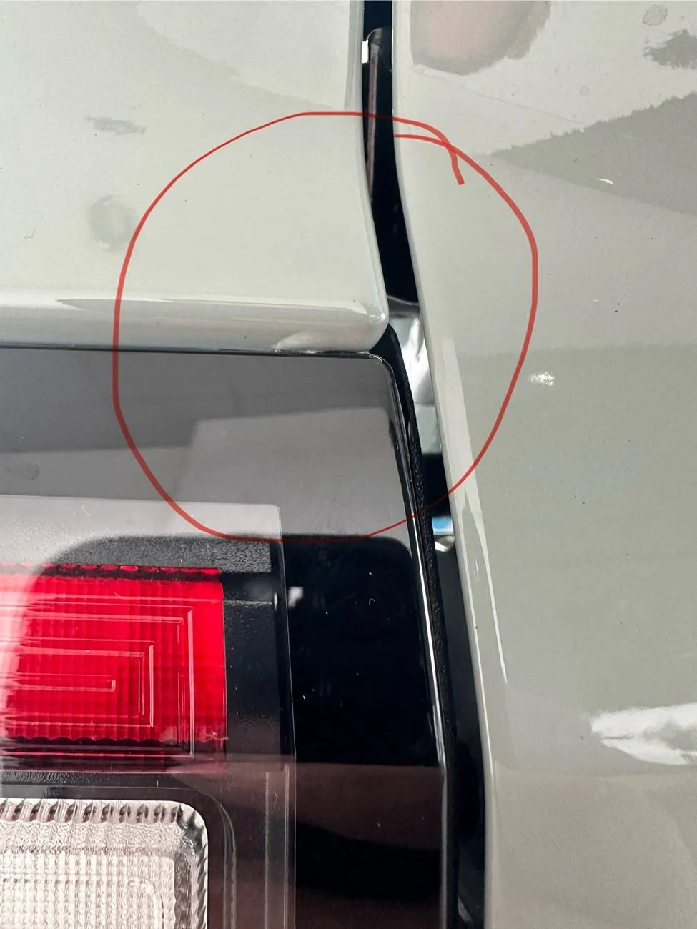

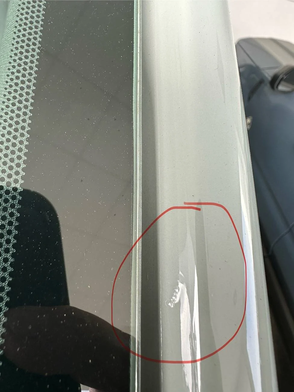

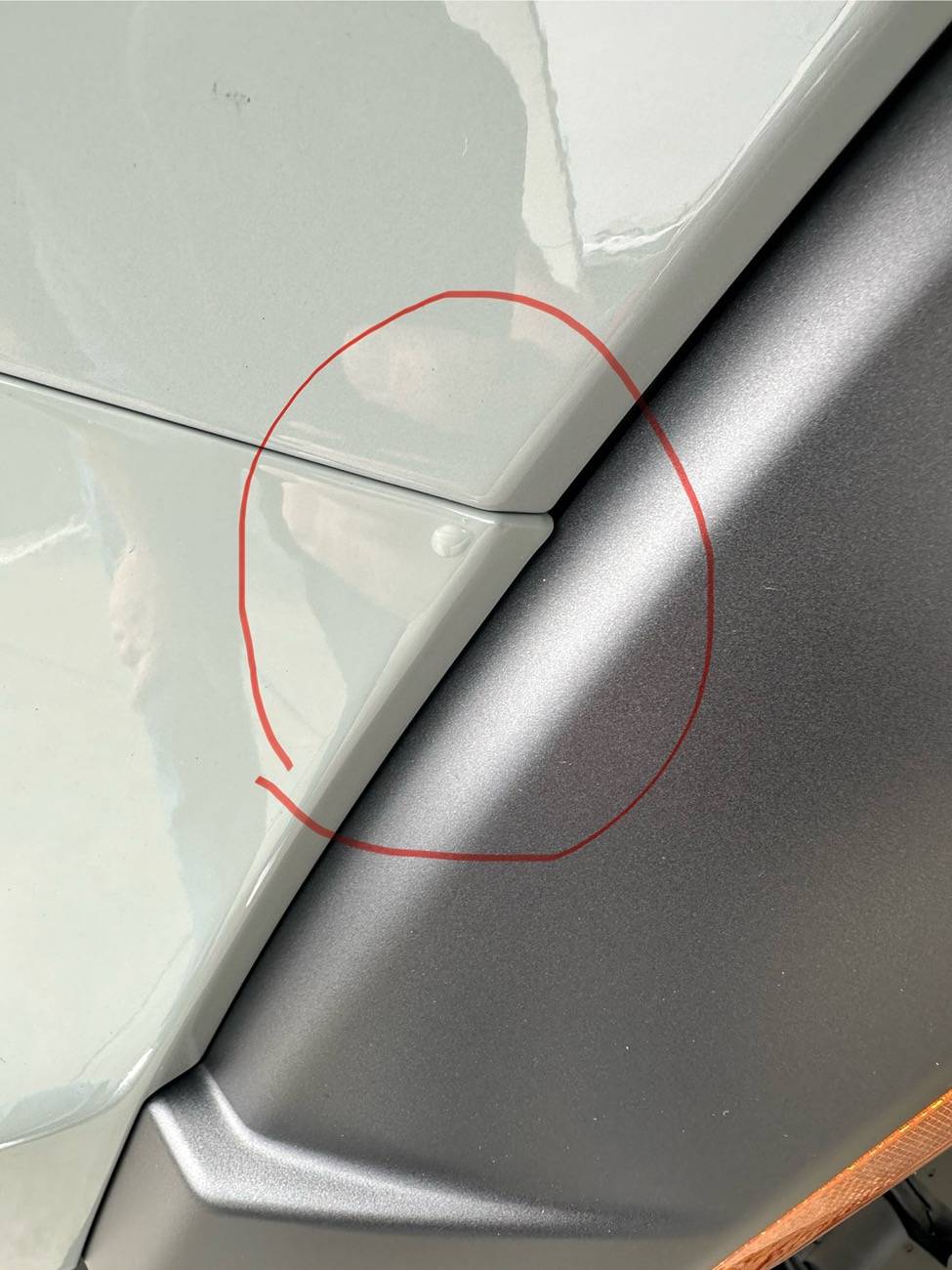

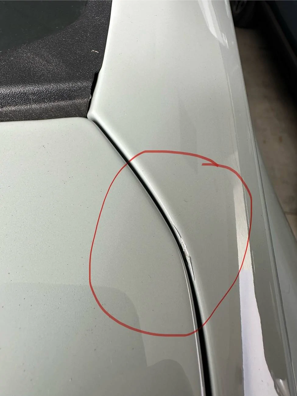

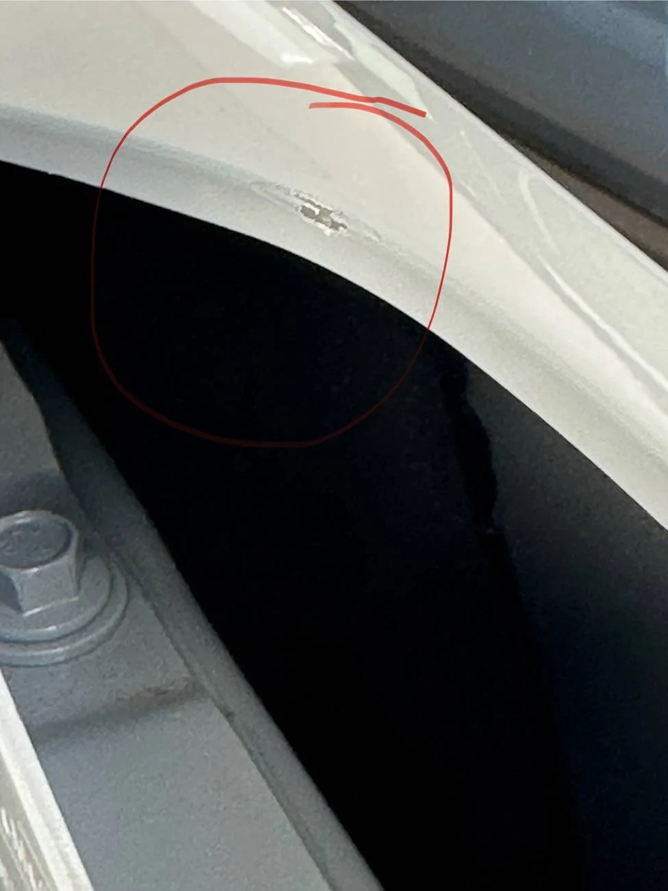

Picked up the RR yesterday. Hood is not aligned properly causing a paint chip on the fender near the windshield. Also multiple spots around the truck that have little paint bumps/drips. Dealer acknowledged and will be correcting next week.

That's pretty bad. Mine had tail light issue so it's going in wednesday.

Was just doing random reading and came upon this. I noticed this the first time I put my rear seat down for loading some groceries. Really odd the legs are so long, so much so that they poke out of the carpet! Mine isn't ripped yet but I can tell it will soon. I'm going to remove the center head rest, take an angle grinder and cut a few inches off each leg, file the sharp edges, and reinstall. Should make things better.
Oddly enough, my center head rest does not snap into place when pushed all the way down. I see there is a notch in the leg to allow it to, but I can't push it down deep enough to click into the notch, so it just sits in place

Update. Got to tinkering. Pulled the center rear headrest out of the rear seat with the back folded down, until the headrest legs were not protruding proud of the rest of the back. Measured how far it was out (about 2") and cut 2" off each leg with an angle grinder. Filed and sanded the sharp edge to a rounded end, reinstalled, and the back of the rear seat is now flat - no more legs pushing through the fabric!
