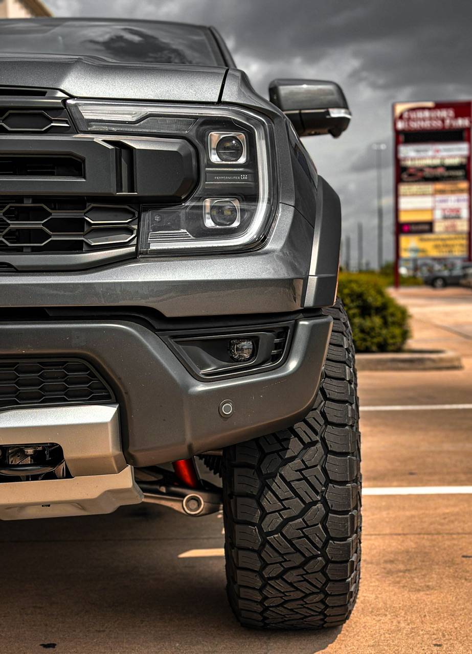

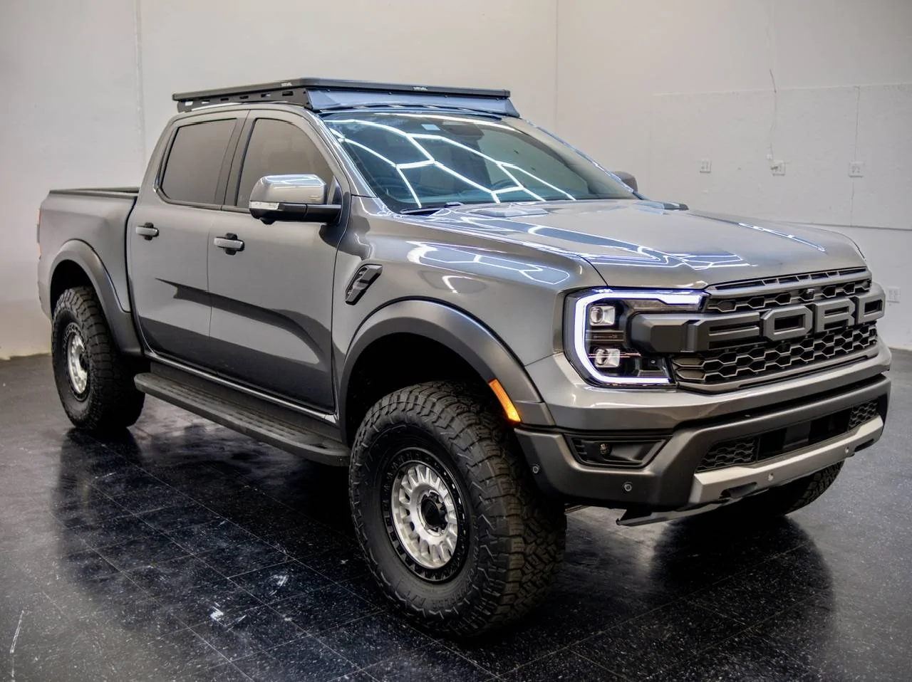

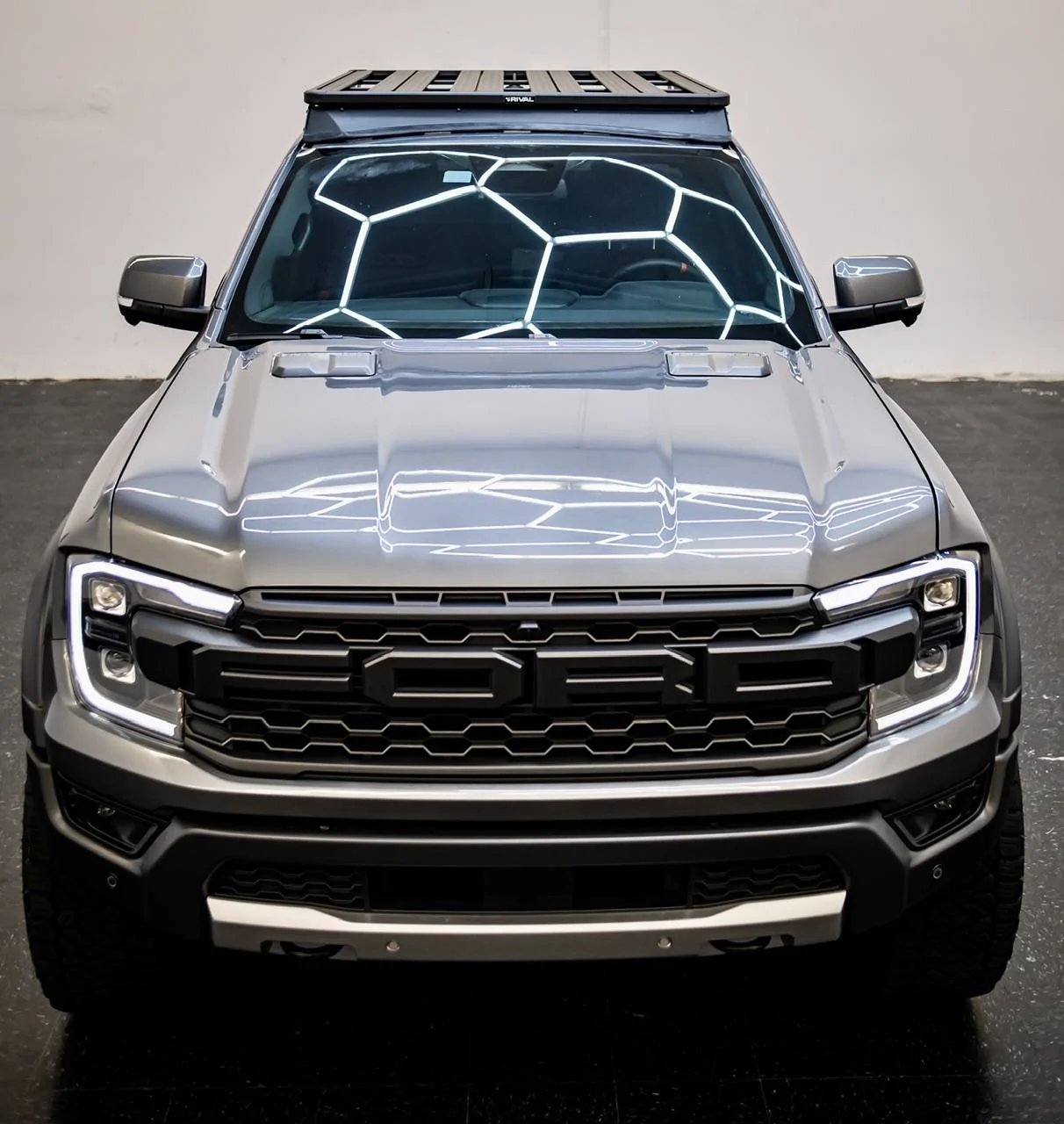

We installed a set of 2.5” Perch Collars to level the front. We are anticipating with the weight of the winch it will bring the front down to the 2” we originally wanted.

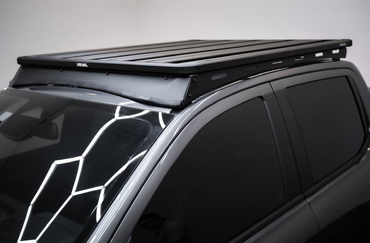

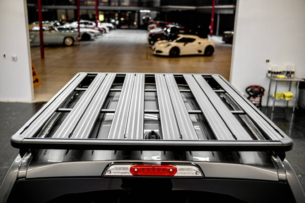

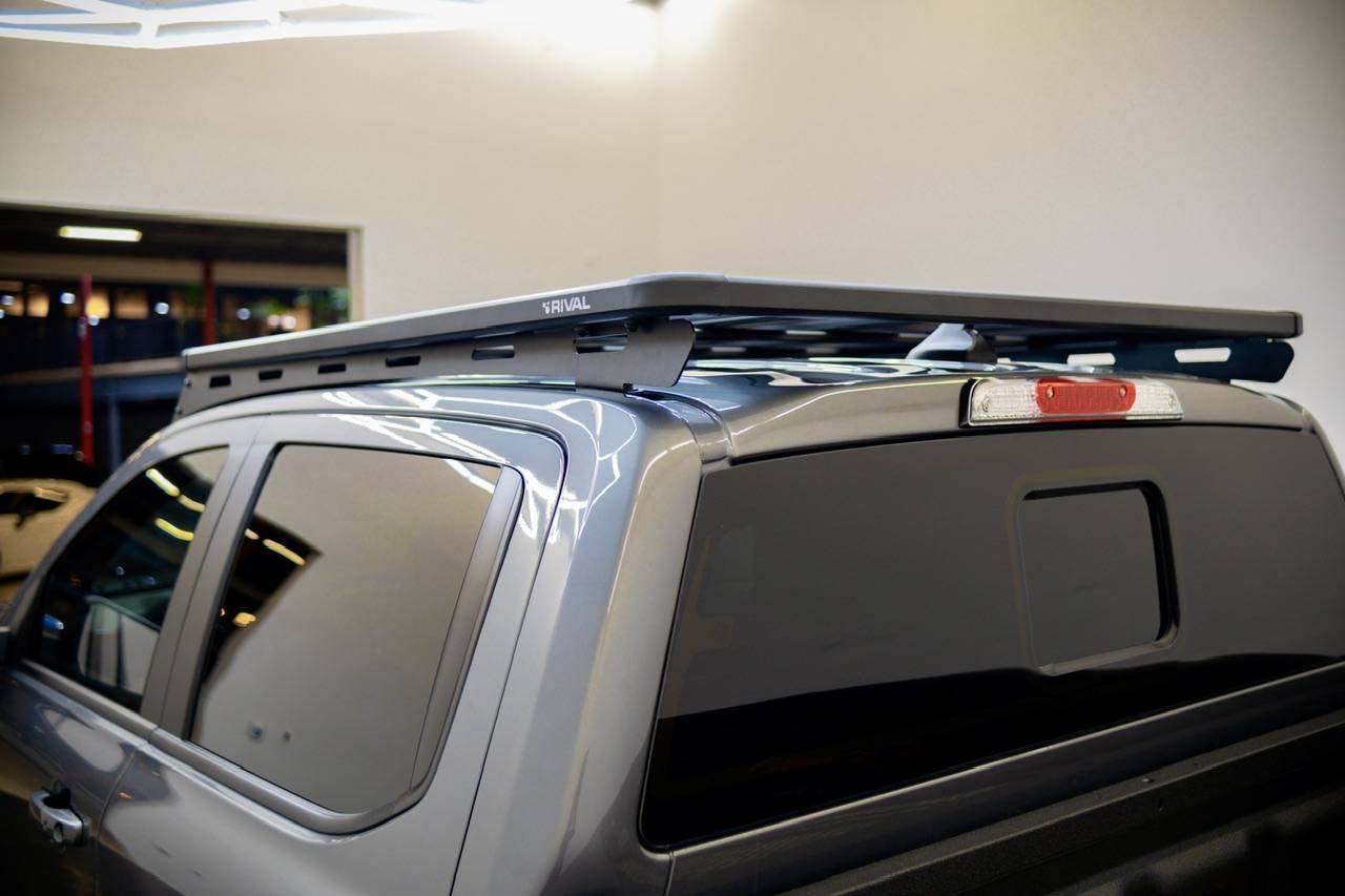

While we were at it we also test fit our Ranger Roof rack. There are some minor changes required for it to fit the US Ranger but we anticipate this to be released in the near future.

How bad is pulling the headliner to get the roof rack installed? Kind of lame that the Ranger doesn't come ready to accept some kind of roof rack.

It’s definitely time consuming. We did not have to fully remove the headliner to install, but A,B, & C pillar plastics need to come off to allow the headliner to droop far enough to access the nuts holding the factory trim pieces.
We have done this enough on other vehicles that it wasn’t a huge ordeal. It was just time consuming making sure to be careful with all the factory plastics/clips etc.

34.4"X12.4" tire in case anyone was wondering. 34ish" looks pretty good on the Ranger.

We have a few in stock but they are shipping outside the US market. We found that the 4 factory bolt holes used to secure the roof rack are slightly smaller on the US Rangers we have tested.
On our Ranger we drilled the holes one size larger, but to avoid that for our US customers we are revising the hardware slightly.

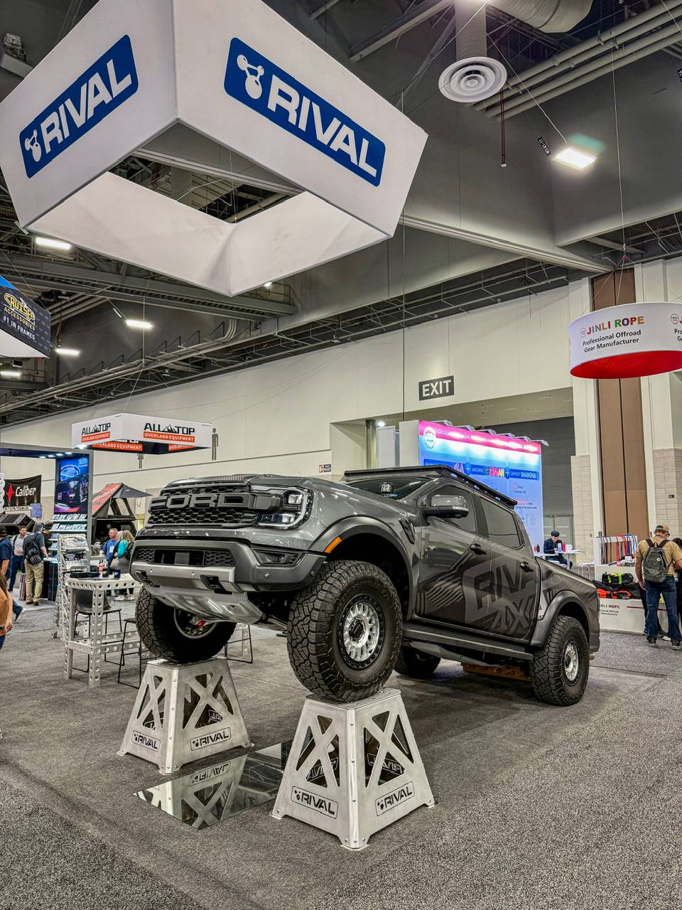

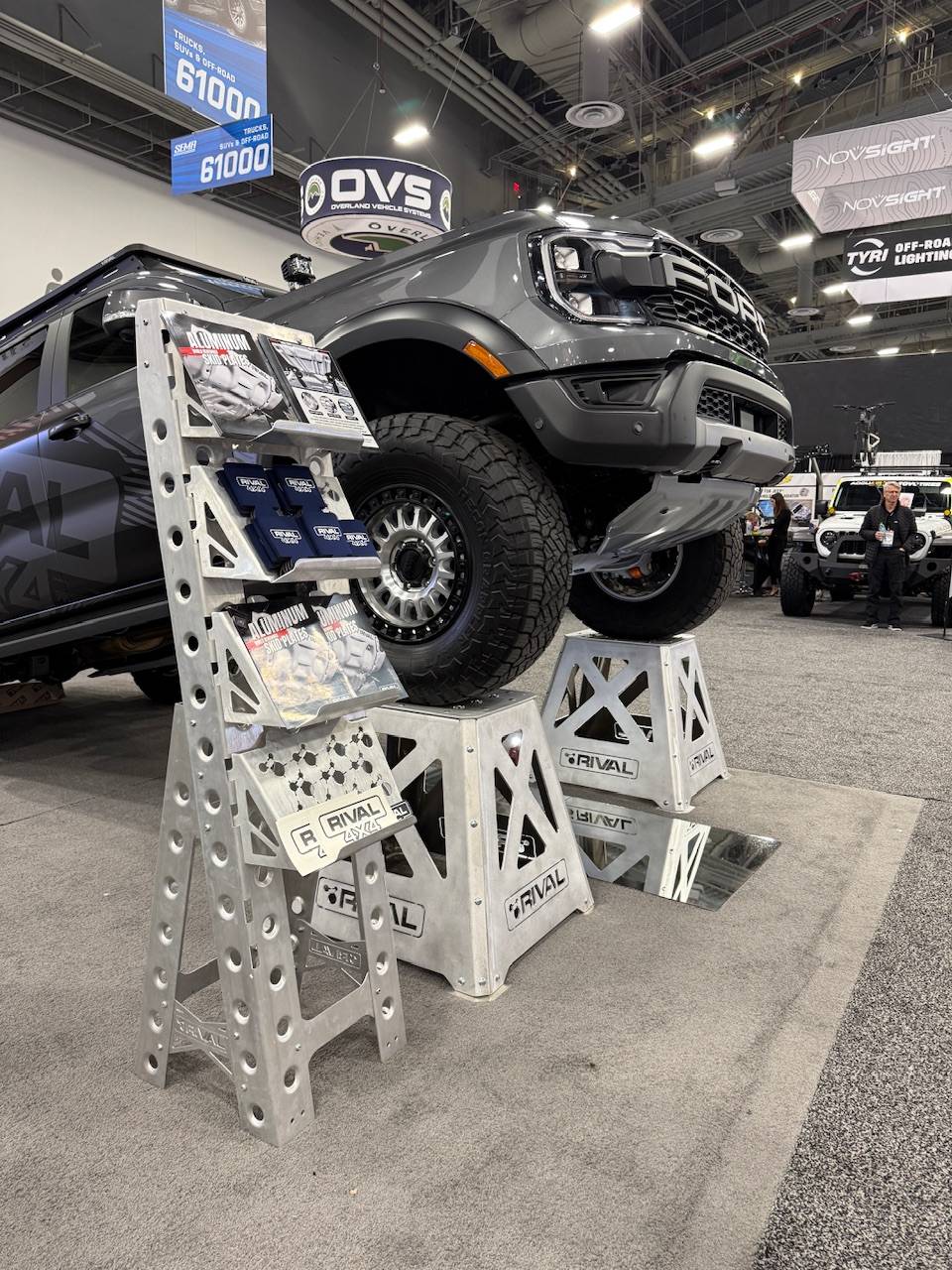

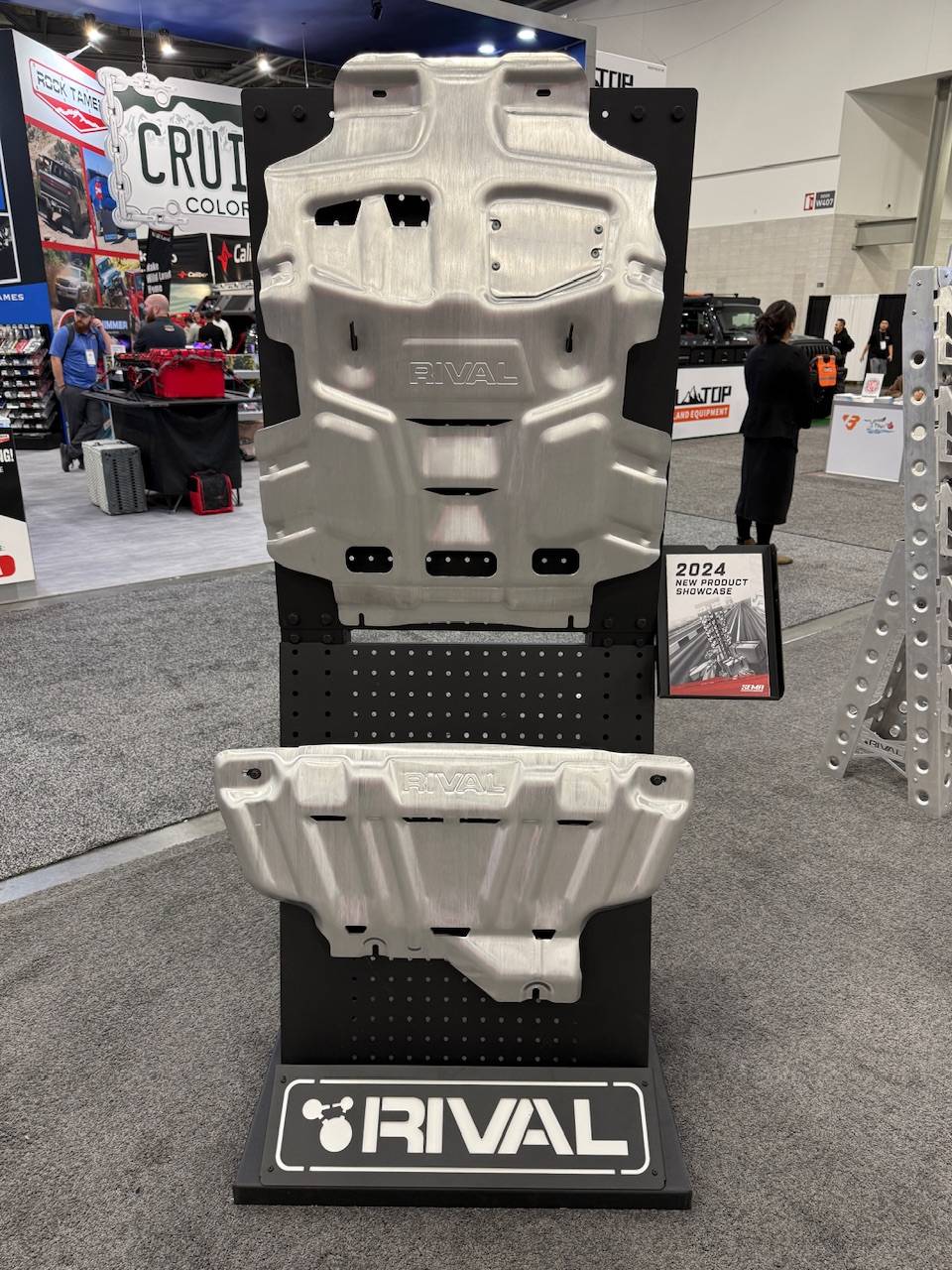

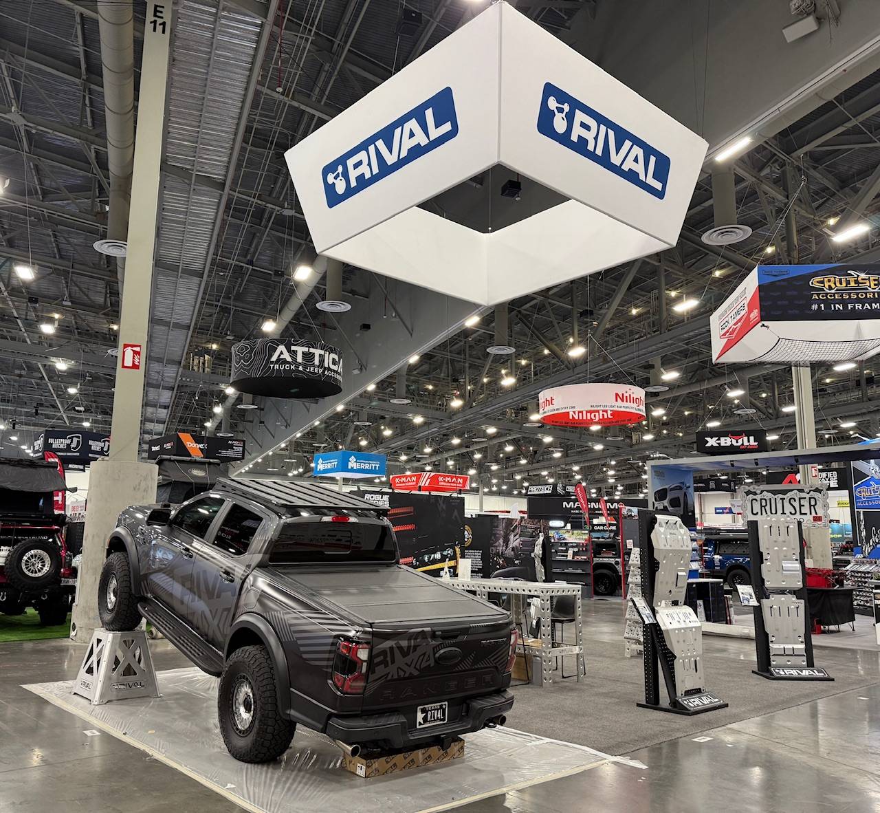

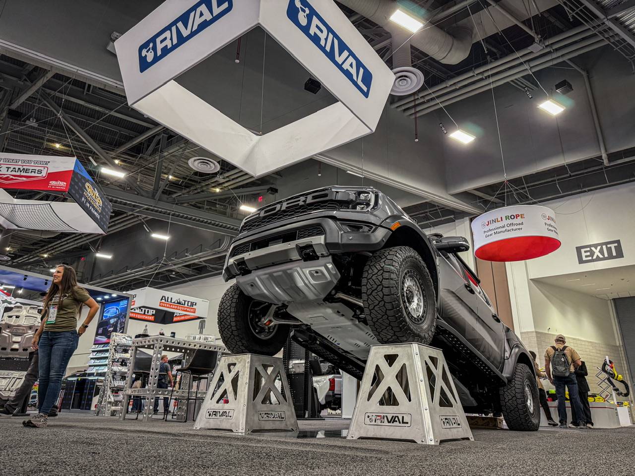

Watched some SEMA coverage videos and saw your RR on display. Looks great with the graphics, full skids and rooftop rack. Shame the bumper required so much revision to work with the US Spec truck - still looking forward to receiving my skids and being able to get my hands on that bumper!
