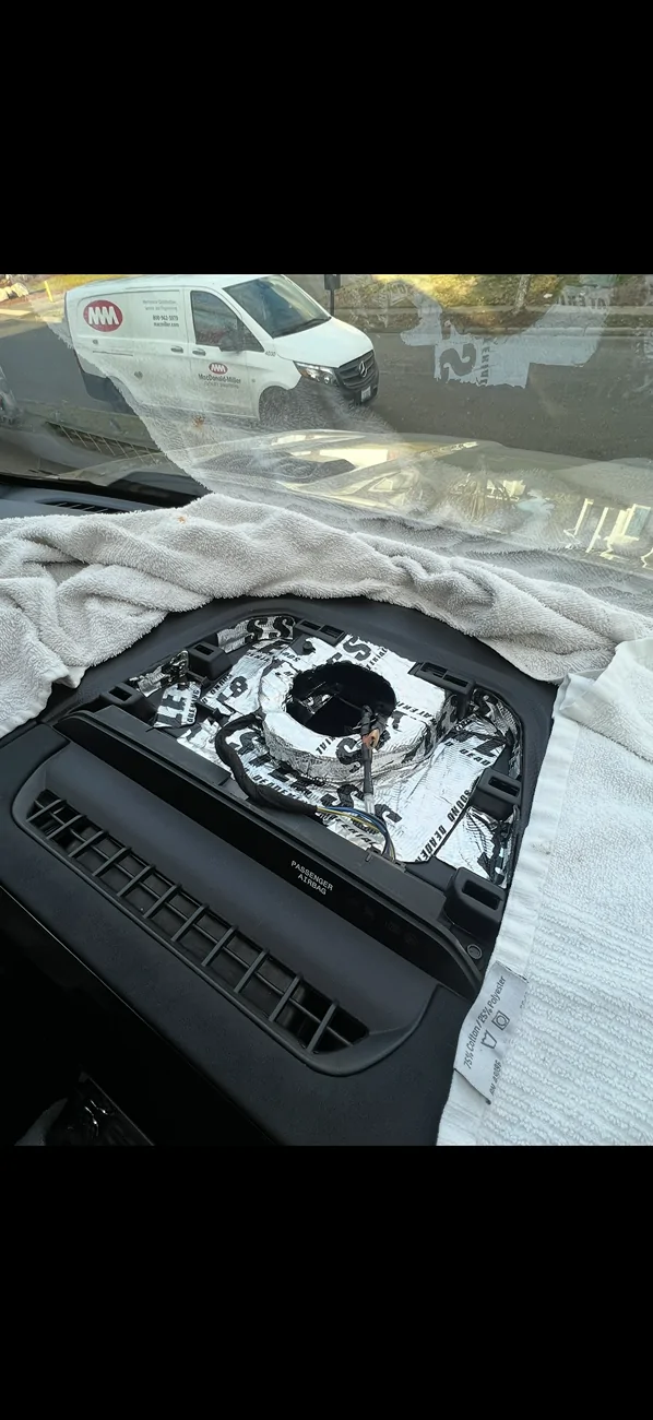

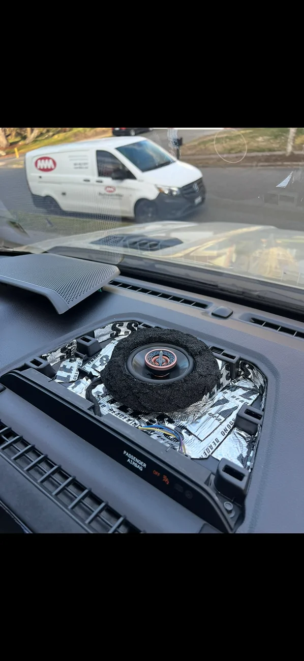

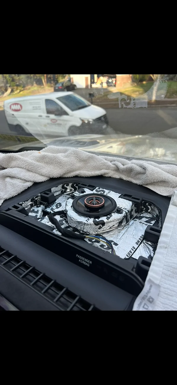

In all pure honesty the CC speaker upgrade to the Infinity (outside of the sub & amp upgrade) is probably my favorite swap out from the factory speakers. I love & enjoy the CC upgrade over the Focals and I love the Focals. Keep in mind I listen to a lot of metal, industrial, black & death metal, old school punk, & 80’s synth at high volume and I ALWAYS keep the sound staging in Surround Sound. So the CC speaker is a key & major player in putting that volume up into the windshield and directed right back into the cab.
I’d honestly hate not having the CC. The Infinity 2-way was a huge & impressive improvement over stock. It does need to be rewired into the factory pigtail (no plug & play adapter). And while I was in there I went ahead and SD’d the CC tub and make shifted a foam ring to direct the sound straight up and through the bezel opening and stop any sideways sound bleed.
Hope this helps!

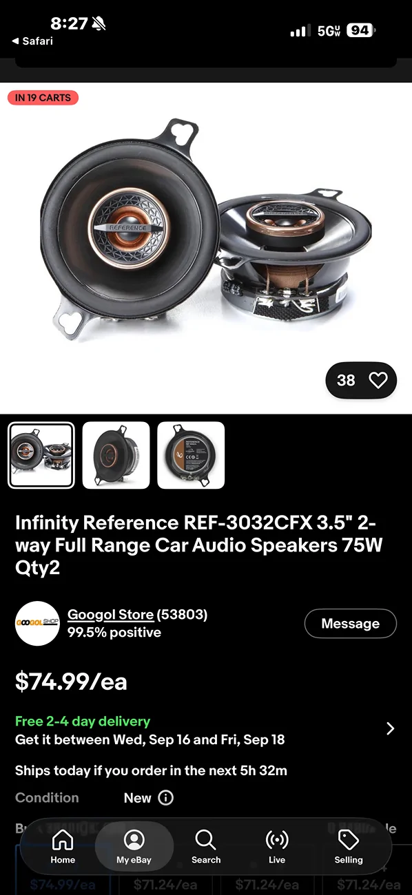

Can you also share the model of the Infinity speaker and any details on the wiring that could help me sort this out without taking it to an installer? Much appreciated.

Here’s a genetic EBay screen shot of the model Infinity that I used. I used this exact same one in the CC in my previous F-150 so I still had a single speaker kicking around to use in the RR. You might be able to find a single for purchase somewhere, otherwise you’re stuck buying a pair.

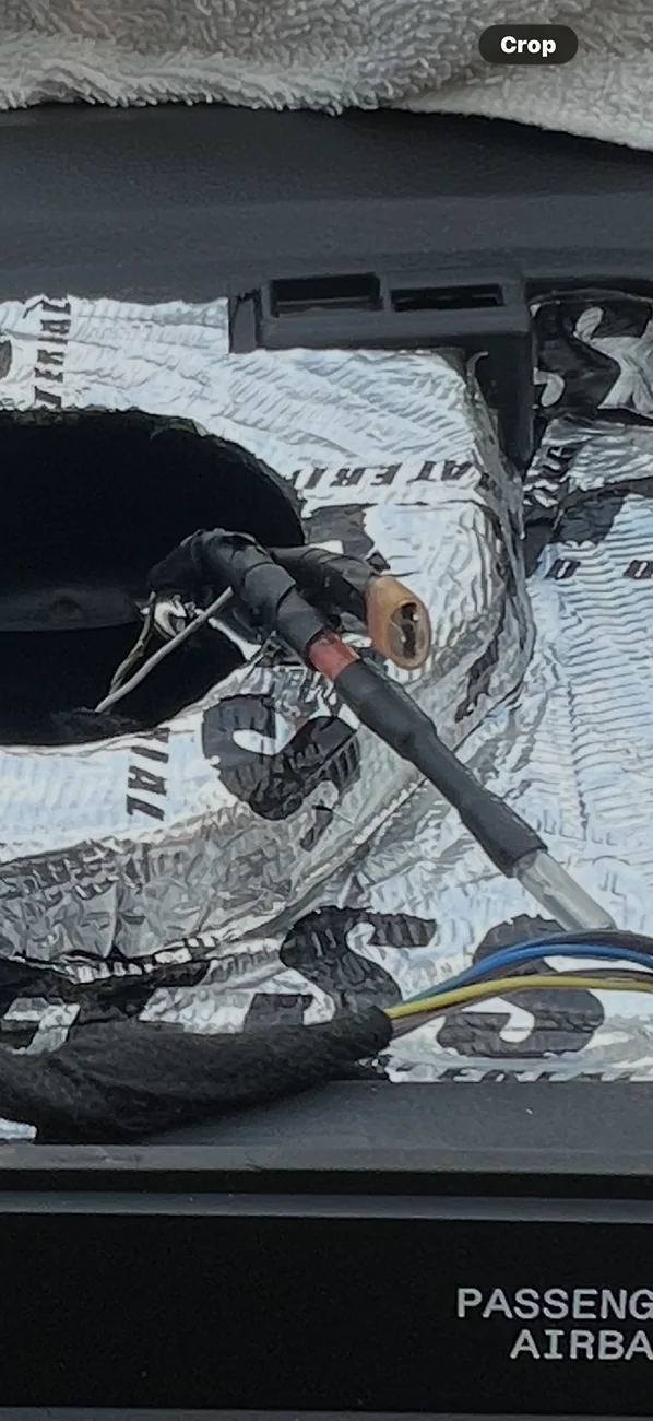

On the wiring from the plug, the solid white wire is positive (wider terminal) and the multi-color wire is ground (narrow terminal). I had to cut the factory plug off and crimp & heat shrink on terminals that matted to the Infinity. Still super easy!

So sorry, but I have one final question. Did the mounting tabs line up or did you have to adapt it somehow?
Lined up perfectly. The Infinity just dropped right in without any modifications to the dash opening or mounting holes.

I opted for the Infinity Reference REF307F (replacement for the 3032) because it has a more neutral output as opposed to the brighter Kicker sound. I'll report back after the install.
