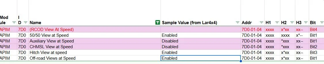

How about trying these? at least the 3 in white:
Ford Ranger FORScan NA Ranger 6th Gen (2024+) Crowdsourced Spreadsheet 1739229636714-8o

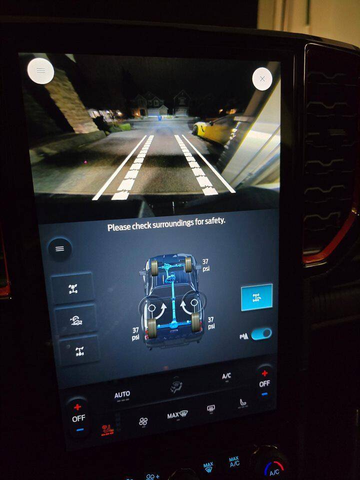

Here's a video of how it looks in my NA Lariat. No trailer required.
I remember now - these were already enabled, so I didn't put them in the confirmed sheet. If you find out that yours are disabled (use the non asbuilt menus), and this works, I'll put the info in the spreadsheet. Perhaps in Germany they are turned off by default. for reference my 7D-01-04 is 0806-CD43-413B
