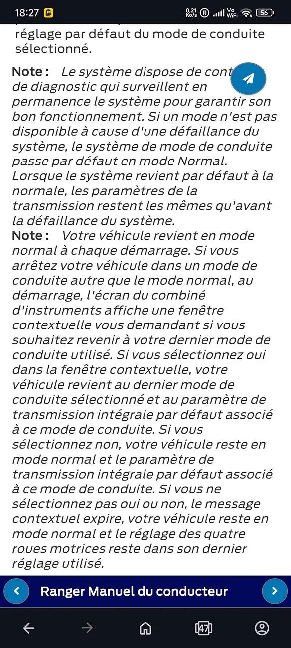

I just looked at my French manual and it clearly says that a message should appear.
Ford Ranger FORScan NA Ranger 6th Gen (2024+) Crowdsourced Spreadsheet Screenshot_2025-02-12-18-27-42-850_com.opera.browser

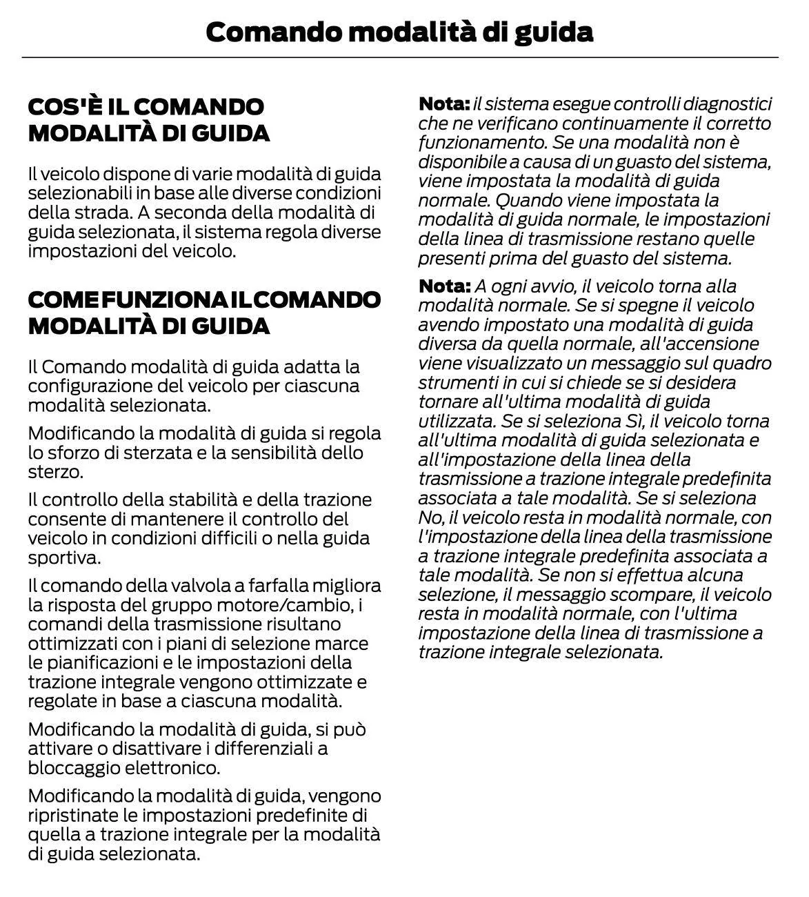

and here is the same message in italian...you can use google translate but it says what I wrote above. and it does not say the usual disclaimer of "on certain model/if equipped"
this looks like a standard feature.
Ford Ranger FORScan NA Ranger 6th Gen (2024+) Crowdsourced Spreadsheet Screenshot 2025-02-12 at 19.33.38

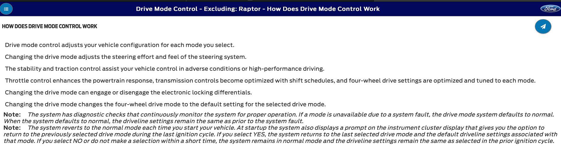

and this is from ford US manual.....
Ford Ranger FORScan NA Ranger 6th Gen (2024+) Crowdsourced Spreadsheet Screenshot 2025-02-12 at 19.38.09
