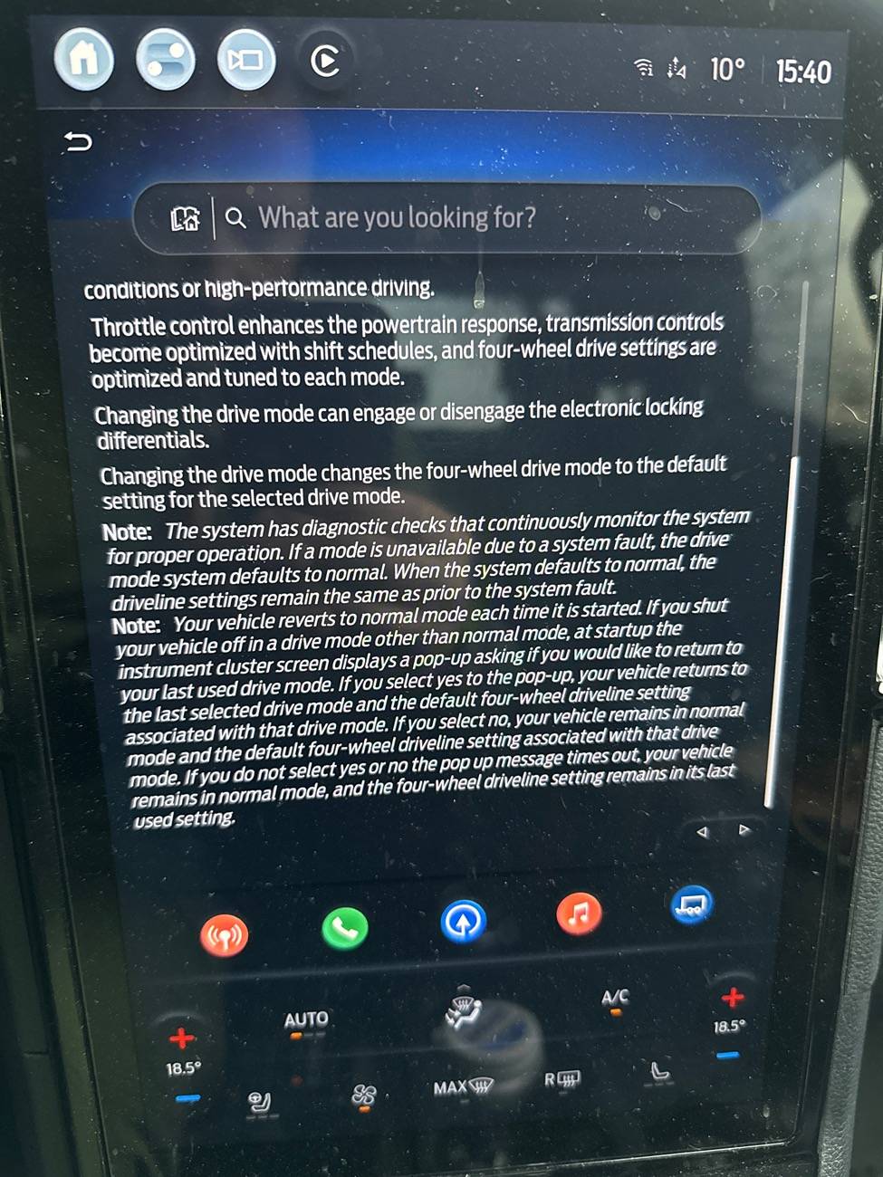

This is from my manual, in sync4
OK, for a test, next time you drive your truck, put it in SPORT mode(regrdless of 2wd or 4A). Dont change anything before you shut off the truck. Give it at least an hour before you try to restart the truck and see if you get a pop-up asking if you want to stay in SPORT mode.
