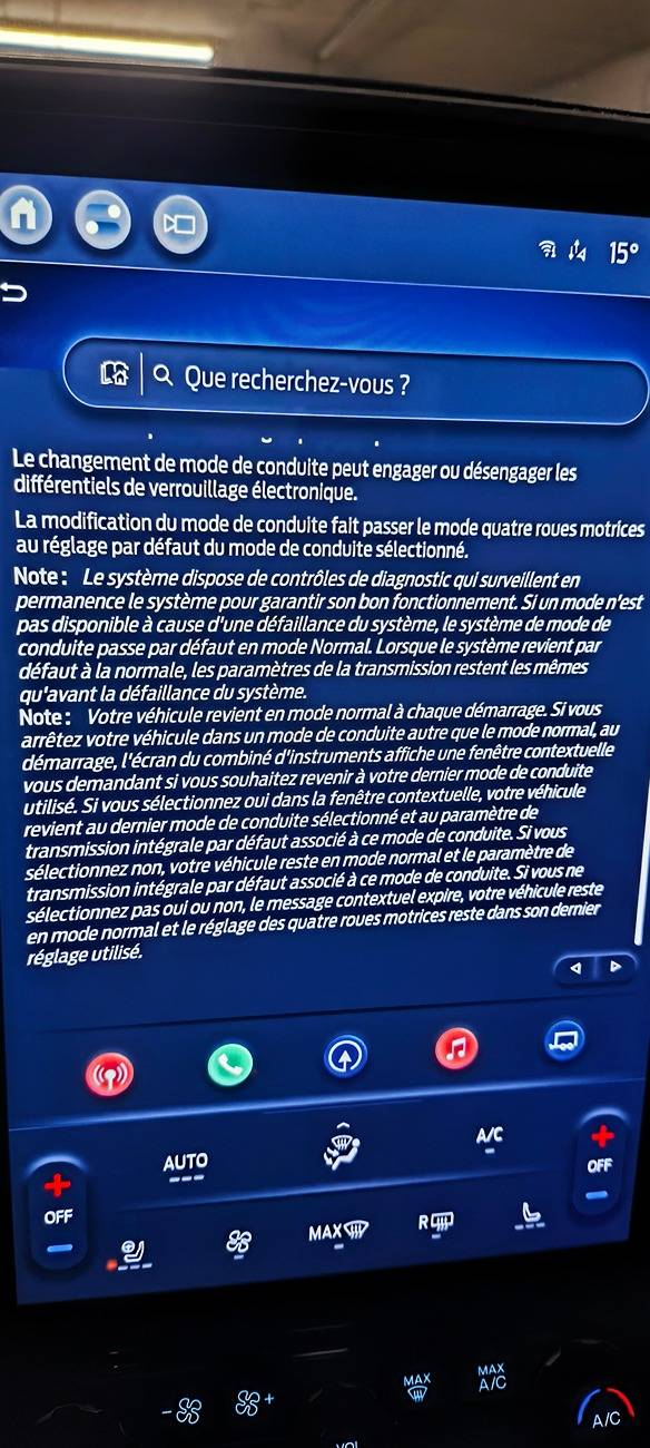

In my case, I have a Raptor 3.0 V6 (December 2022) of German origin, bought in France from an individual and I live in Portugal.
I have never had this pop up although the instructions in my sync4 indicate it.

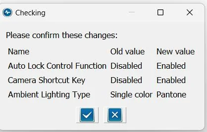

I have the auto-lock working (automatically locks once you hit ~10km/hr) if that is what you are referring to.
This was the first ForScan modification I made and it was before the Ranger spreadsheet so I probably used the F150 spreadsheet.
As it was my first mod, I didn't really know what I was doing so I took this screen shot after the changes - I don't know what module this was in but I hope it helps.
Ford Ranger FORScan NA Ranger 6th Gen (2024+) Crowdsourced Spreadsheet Changes 2023-08-15 174059
Oh, and the other things changed here were not successful.

Thank you. Yes, I had tried enabling the Auto Lock Control Function, as in your screenshot, but it still remains greyed out and unselectable in the menu. Perhaps it's a New Zealand thing?

It must be enabled also in BCM (or BdyCM) "auto lock"

Thanks @Raptortugal and @CrustyNoodle! That last clue worked perfectly. Needed to enable Auto Lock Vehicle in the BdyCM non-Asbuilt menu.
I had tried the same setting in the Asbuilt menu yesterday, but might have confused the whole thing, since I'd also enabled something similar in the IPC menu, resulting in none of it working.
