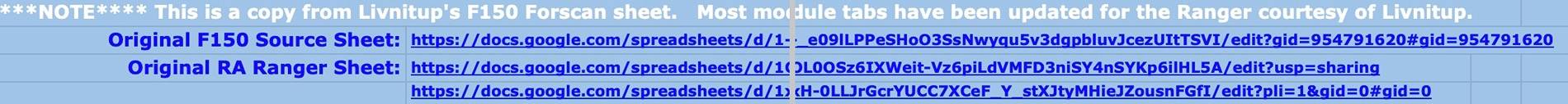

Thank you for your explanation! The third one is this, which is linked in the spreadsheet
Ford Ranger FORScan NA Ranger 6th Gen (2024+) Crowdsourced Spreadsheet Bildschirmfoto 2025-02-18 um 22.41.00
oh, the links inside the sheet. I can probably remove or hide these - i just gave links to the original sheets that helped populate this one for us as a reference only. These are different sheets and not related to the Ranger at all. Post 1 of this thread has the only links you need.
