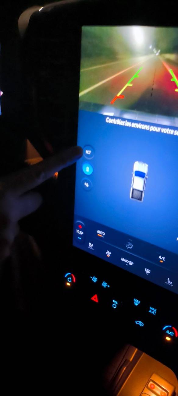

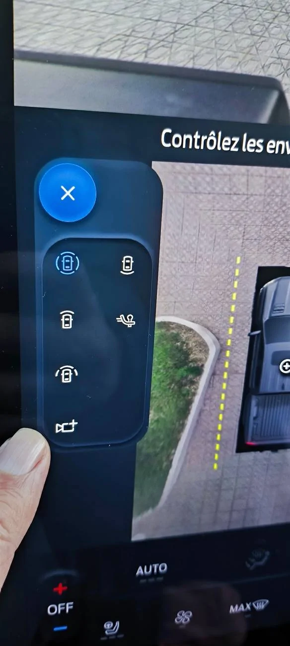

Thanks for the tip, it works; useless therefore essential ?
I just had to replace the numbers. Not add!
Thanks also, on the other hand I have a new button that appeared, the CAMERA AUX. When I press it nothing happens (does it work for you?)
Mine also, I believe it is something to do with an auxiliary camera for a caravan. Unsure if it works or not.
