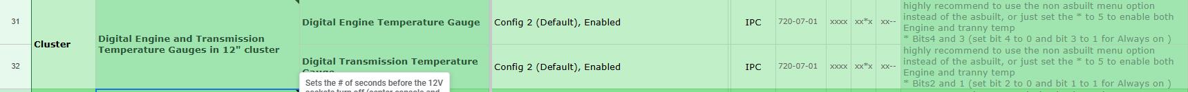

Can someone remind me where to find the codes for enabling the actual numerical temp for engine and oil in the dash display?
Digital Temp Gauge (With Alphabet C/H, E/F)IPC720-07-01xxxx-xx**-xxxx**=54
Minor Gauge Units (Numerical/ Alphabet C/H, E/F)IPC720-11-01xxxx-xxxx-*xxxAlphabet *=8 / Numerical *=A
