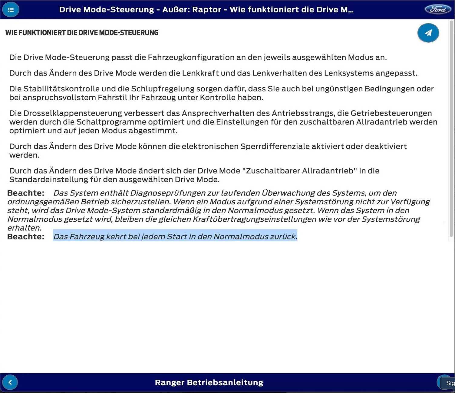

In my German manual, it is written exactly as it is:
Translation:
Ford Ranger FORScan NA Ranger 6th Gen (2024+) Crowdsourced Spreadsheet Bildschirmfoto 2025-02-12 um 19.55.27
Note: The vehicle returns to normal mode at every startup.
Without any asterisk notes or fine print, no exceptions.

Yes, that’s correct. It’s the same for me. But as shown above, according to my documents (German manual, German-spec vehicle with EU code), this behavior is correct—exactly as stated in the manual.
And even after diving deep into Forscan, I can say that there’s no way to code it differently. There are simply many differences—just like how it’s not possible to activate the cameras at speed on EU non-Raptor vehicles.

To view the owner’s manual online, you have to enter the VIN. Maybe it really has been changed, and my model is just “too new,” so it’s no longer included in the updated manual?!

Maybe that’s exactly the problem. Here in Germany, I entered the VIN to get a tailored online owner’s manual for my vehicle. What does the manual say in your Sync 4?
Same thing
