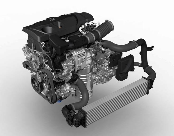

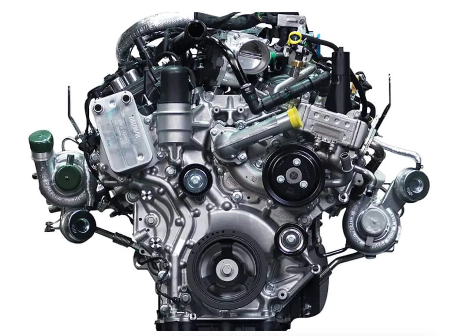

Somebody needs to come up with a turbo leak check device that works like a refrigerant leak detector die, if you see colors staining your pipes, air is leaking out. Twin turbo V6 engines have way WAY too many clamps…… I love my RR, but much prefer my wife’s RDX 2.0 four banger for long term maintenance. When car shopping, I always consider where they mounted the turbo, how hard is it to access, and how many feet of piping is there?

LOL, I am very ashamed to admit I never knew there were consumer grade testers like that, thanks. I am surprised that a 1 psi smoke stream would be effective, unless the leak was a very large one…? I don’t see how it could work well on a high volume system like a complete intake or exhaust, that is not close ended - do you plug the far end completely?.
I kill moles in my yard using gasser smoke bombs - I set one in a visible opening and blow the smoke through the burrow using a leaf blower, then stomp closed all the mini volcanoes. I guess that technique is similar in theory, to doing an engine leak test….
