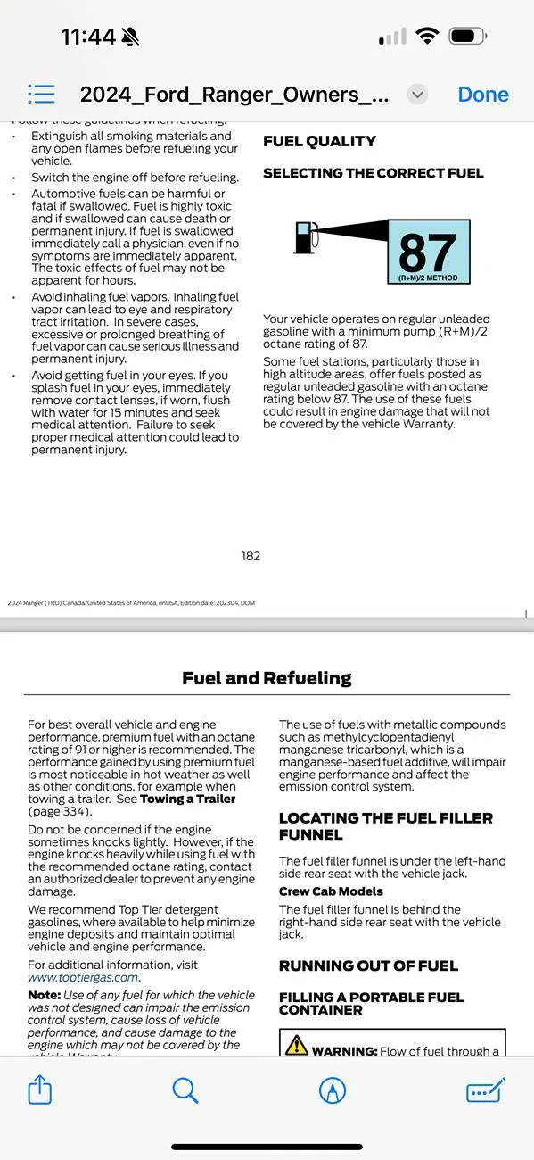

Not looking to start a big discussion, but are we all agreed that 91 from reputable purveyors is the proper grade for US models? Thats what I inferred from the manual but there was no Raptor specific fuel recommendation.

87 is the recommended gas for anything but the Raptor
Actually the manual isn’t clear on that. Below is a screenshot from it that I interpret to mean “you can get away with 87 but you’ll get better performance by using 91.” Also there’s nothing specific about fuel in the "Raptor Unique Features" section of the Ranger manual nor the Raptor specific supplement .

High performance engines and turbos perform better on premium fuel. Their maximum hp and torque require premium fuel. So I've always run it to maximize the potential of my ford ecoboost engines and to ensure best engine combustion occurs and finally to increase fuel efficiency.
