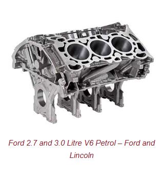

Also, that source in the video regarding the block of the 2.7L vs. the 3.0L is incorrect regarding. The entire block of the 2.7L and 3.0L are the same, in fact the 3.0L is a bored and stroked 2.7L block. Both used fractured main bearing caps. Straight from the horses mouth:
SinterCast AB | Passenger Vehicles
Ford Ranger Getty's Garage - 3.0L EcoBoost V6 Twin Turbo – Pros, Cons & Why It’s a GREAT Little Engine! 1748004254081-hv
There is an aluminum structural "sleeve" that goes over the bottom end of the 2.7/3.0L block, so it's a two-piece design similar to the Power Stroke 6.7L Turbo Diesel.

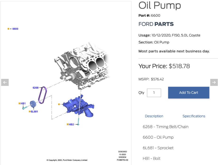

And yet another issue I have with the video is the criticism of the belt drive oil pump. The 5.0L V8 uses the same belt driven system! All the Ecoboost do and most modern engines do.
There are F-150's out there with 400k miles on the factory belt...something that most people dont' know about chain driven pumps is that chain oscillation can shatter pump gears (a common issue on Nissan's 3.7L V6 NA engine).
Belt driven oil pumps were introduced back in the early 2000's on small I4's, they were somewhat problematic initially, as is any new technology, but over time it's been ironed out and most people don't even know their 5.0L Coyote V8's use a belt drive oil pump!
5.0 Oil Pump Change? - Ford F150 Forum - Community of Ford Truck Fans
Ford Ranger Getty's Garage - 3.0L EcoBoost V6 Twin Turbo – Pros, Cons & Why It’s a GREAT Little Engine! 1748004882462-6i
The Real Cost of The Oil Pump Belt - 3.0 Duramax Diesel
Just a few examples, but most oil pumps are now belt driven, I4's, V6's and V8's all alike, people just don't know any better and assume it's "only this engine" and it "must be unreliable" because everyone knows chains are better than belts just because....until your pump gears shatter!
Application is what matters, not it's always this or it's always that. Oil pumps have low torque loads compared to cams and phasors, the g-rotor teeth are also sensitive to harmonics, so belts make MORE sense for oil pumps while chains make more sense for cams.
That bottom end does not look sturdy or durable. The lack of material holding the crankshaft is concerning.
Maybe this will help to alleviate your concerns
A. Upper Block
The most novel element of this engine is the two-piece block, with a single iron casting for the upper block, which includes the cylinders, and the main bearing caps (only the lower half of the block is aluminum). The bearing caps are laser etched and then cracked off to fit the crankshaft. Once reassembled, the three-dimensional mating surface for each cap provides extra stability. The match is so good that Ford has tested engines running without the caps bolted in at all.
B. Lower Block
Most engine blocks are made from a single material, but to save weight the 2.7-liter's lower ladder frame is die-cast aluminum and bolts onto the iron upper half. A second set of bolts secures the bearing caps to the ladder frame to further stiffen the engine. A composite oil pan seals up the bottom.
Ford Ranger Getty's Garage - 3.0L EcoBoost V6 Twin Turbo – Pros, Cons & Why It’s a GREAT Little Engine! 54cb32360b274_-_ford-twin-turbo-ecoboost-0414-de
