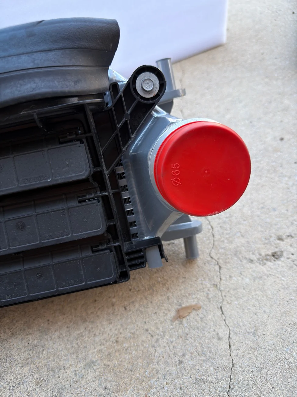

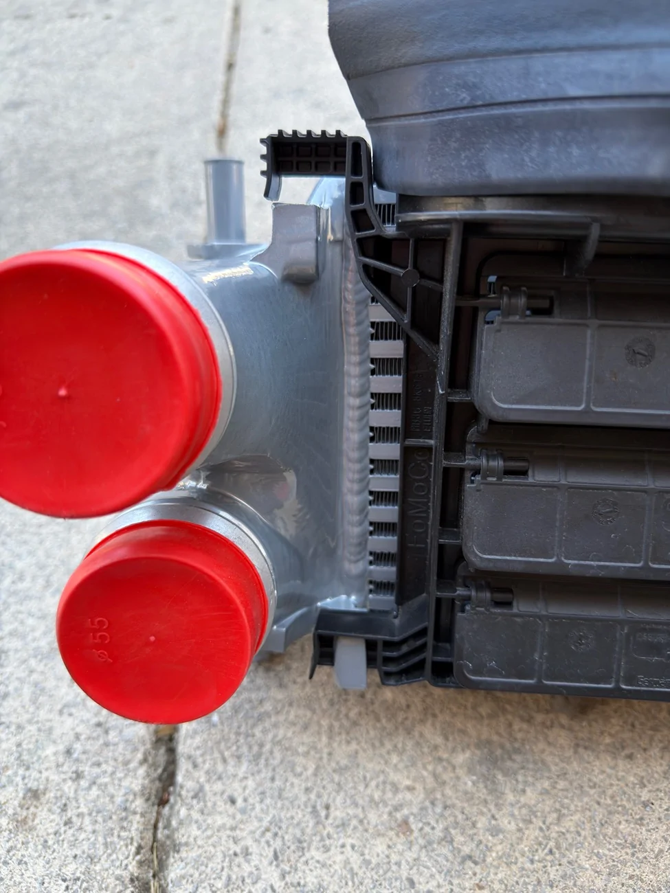

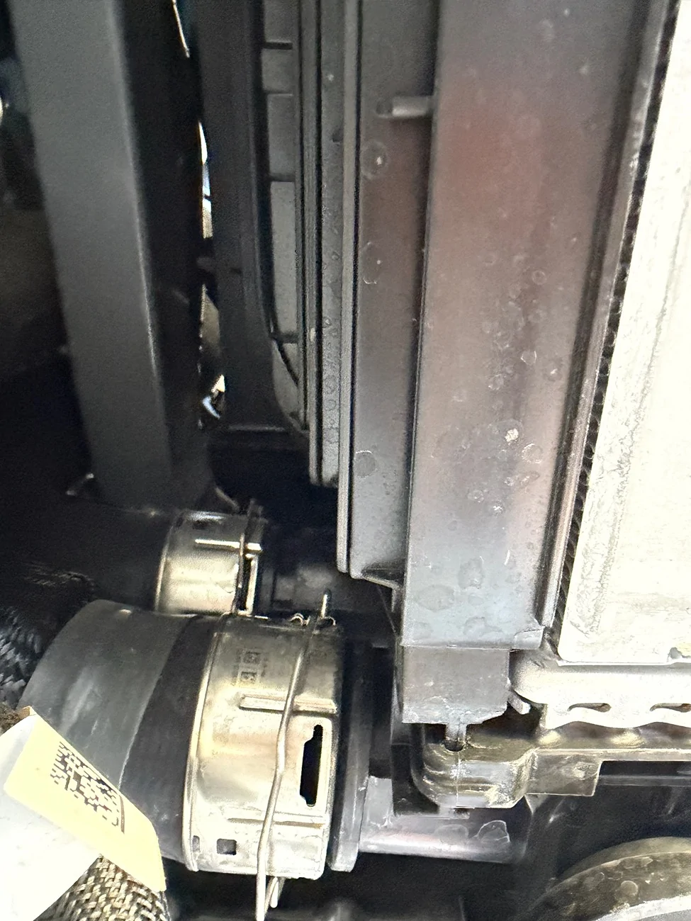

I installed a CVF intercooler. I tried leaving the grill shutter system in place but I found it to be impossible as the top of the intercooler interferes with the top of the shutter system frame not allowing it to be pushed up into place. The shutters themselves are very close to the new intercooler but I bet they wouldn't interfere with the new intercooler if the upper part of the shutter system frame was trimmed. Once I removed the shutter system, I was not going to start modifying it because I don't think it serves any useful purpose so I didn't put it back. Once separated form the grill shutter assembly, I zip tied the grill shutter motor to a harness that runs across the lower part of the bumper just below the intercooler cut out. The shroud that mounts to the rear of the stock intercooler is swapped over to the CVF intercooler and lined up well on 3 of the 4 corners but the 4th corner couldn't be secured because it didn't line up. With the other 3 corners secured, the 4th corner doesn't move at all so I didn't make any modifications.

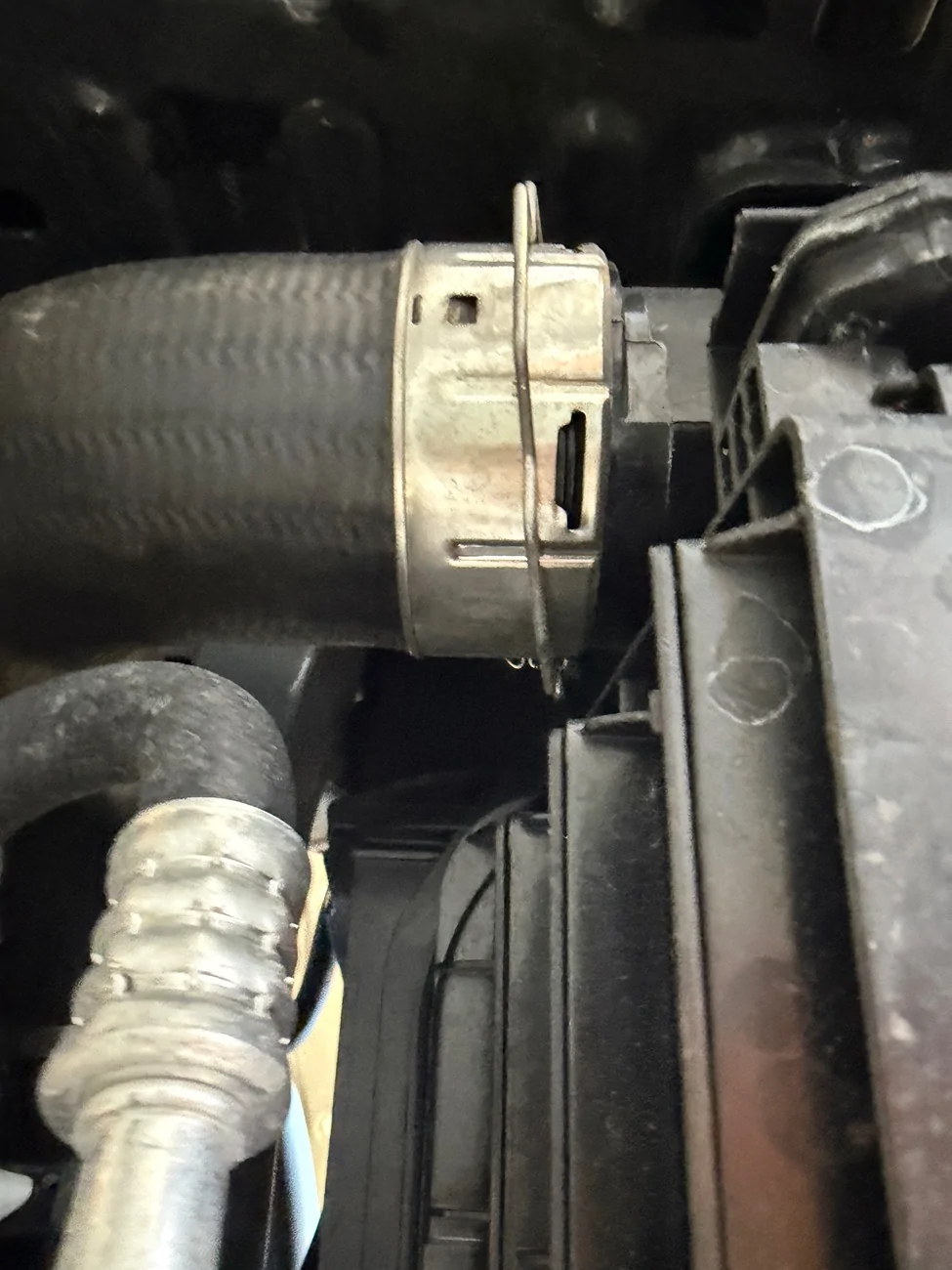

@Caneman88's third image shows what I was talking about regarding the 4th corner of the rear shroud not lining up with the tab on the intercooler.

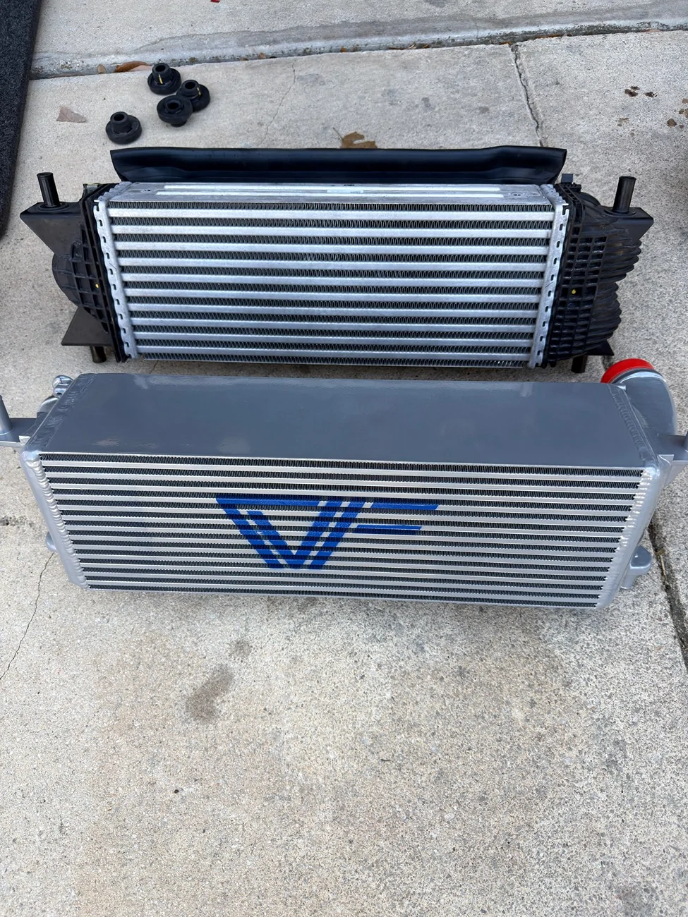

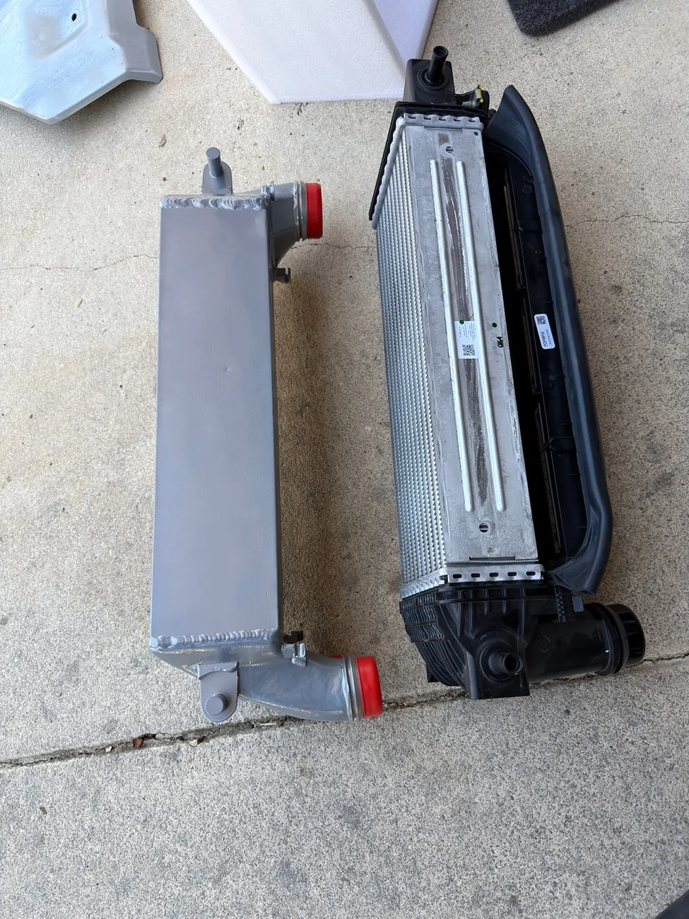

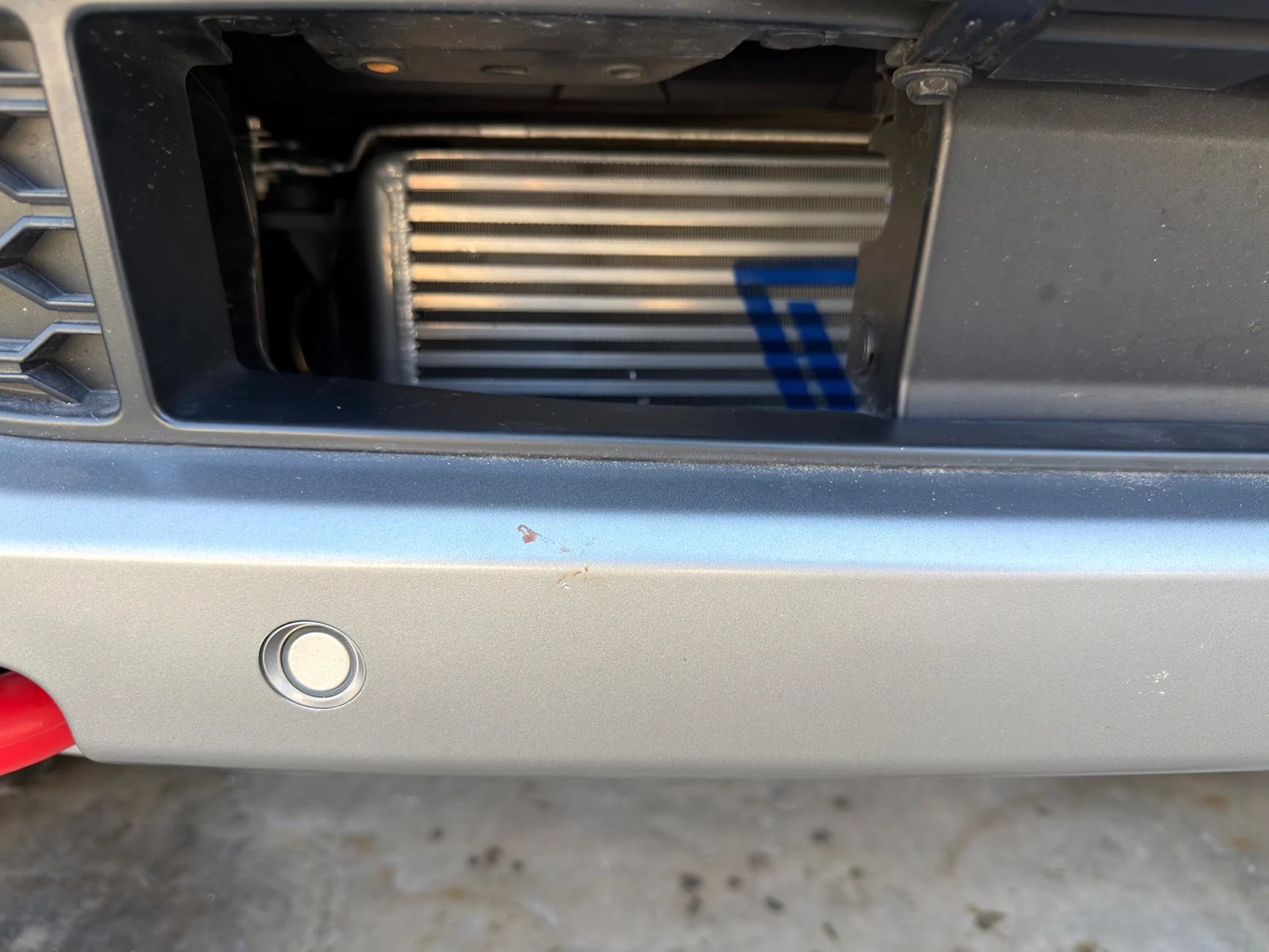

some pics of my CVF install took about 2 hours if you do the stencil put it on side not in the middle like me :explode:
OK. So you use their bracket and removed the front shutter. If you look at my thread I just relocated the ACC in order to free up all airflow to the intercooler. I'm going to try and reuse the stock frame and just pull the flaps.
OK. Not that big of a deal.
