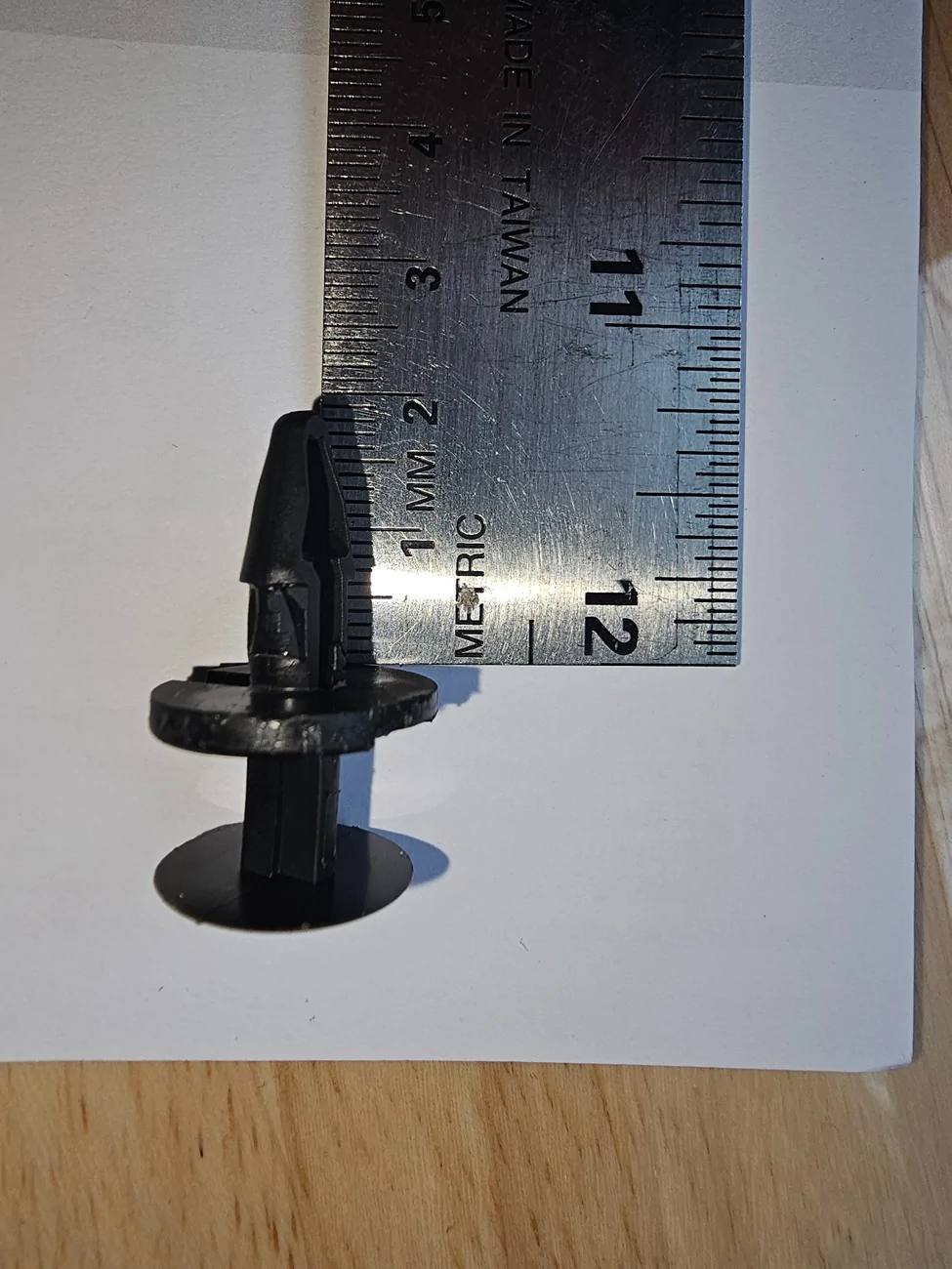

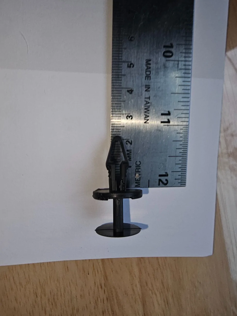

There are at least 2 (maybe 3) sizes (lengths) used to hold the Grill Retainer on.
The rivets along the front are a different length than the rivets closer to the engine.
Head Diameter: 18mm
Stem Length: 20mm (appears shorter as it is used and not in original shape).
Panel Range: 4.5mm - 7.0mm
Fits into 6.5mm hole
Ford Ranger Grill Retainer Rivets 20251124_141531
Head Diameter: 18mm
Stem Length: 22mm (appears shorter as it is used and not in original shape).
Panel Range: 7.0mm - 9.5mm
Ford Ranger Grill Retainer Rivets 20251124_141551
