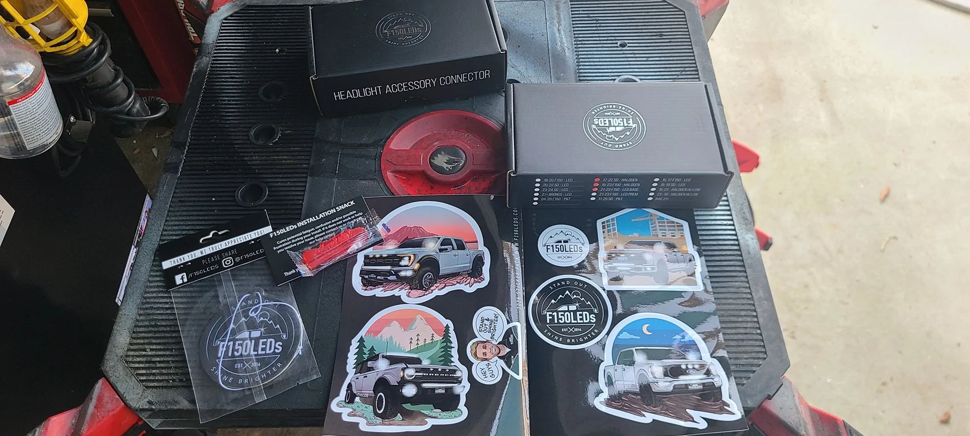

Ok guys, the harness from @F150LEDs showed up to conplete this install. I actually ordered two of their headlight accessory connector kita because i need one for my father in law's truck too so they both showed up.
Ford Ranger Ranger Raptor Grill Replacement? 20260214_163326
I dont know how many of yall got stuff from their website but they really put thought into what they build. Their harness kit is top notch. They give you stickers for your toolbox, some for your back window, a scented deal to hang on your rear view mirror, and a stress relief gummy fish to eat and relax if you get angry from something not going well.

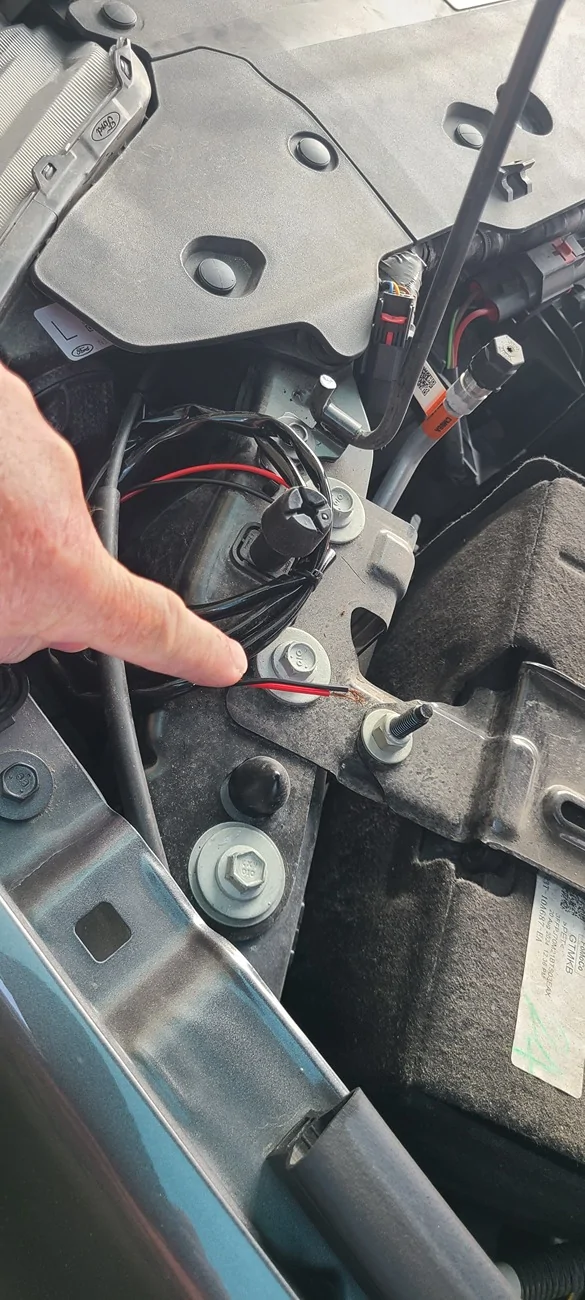

Remember these wire from the earlier post? Its time to revisit them and put them to use.

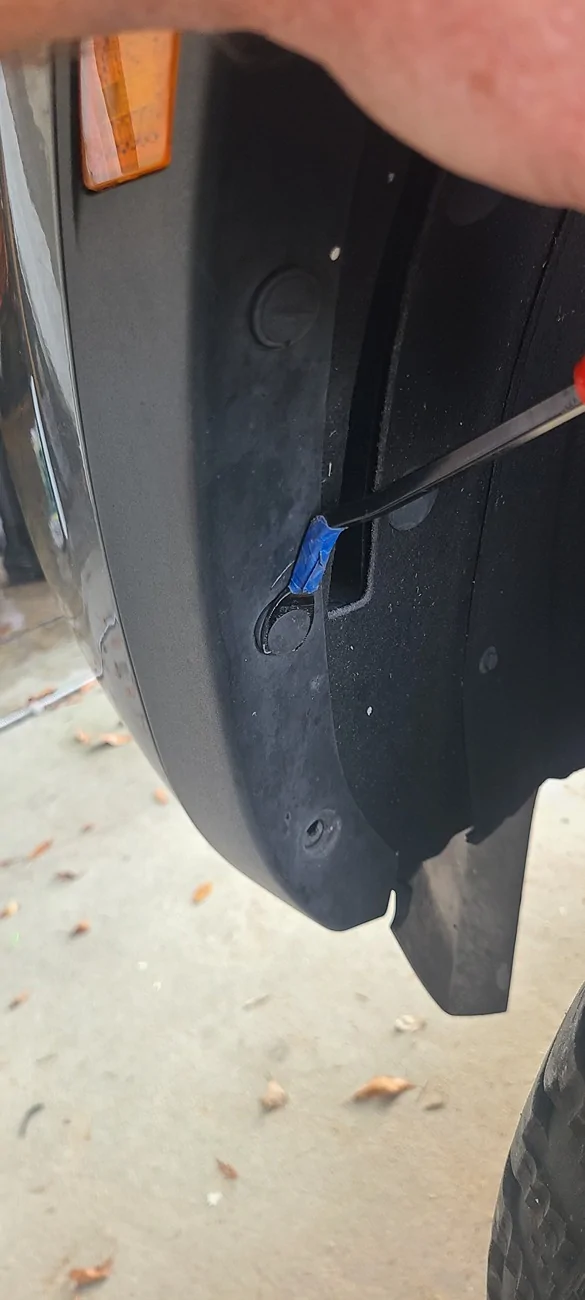

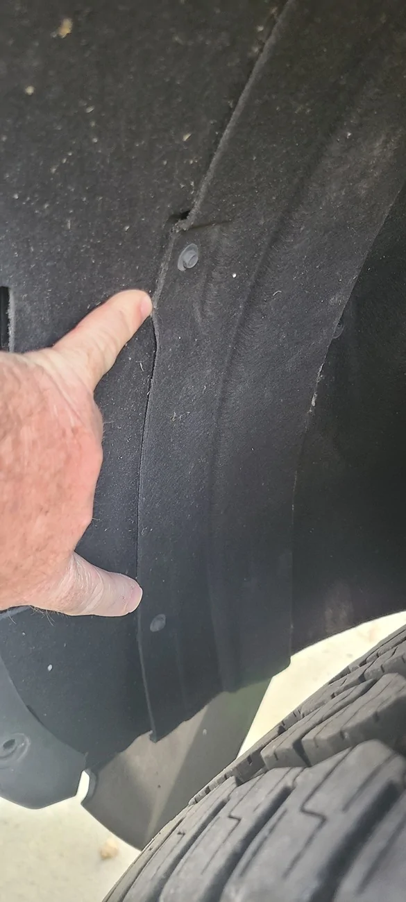

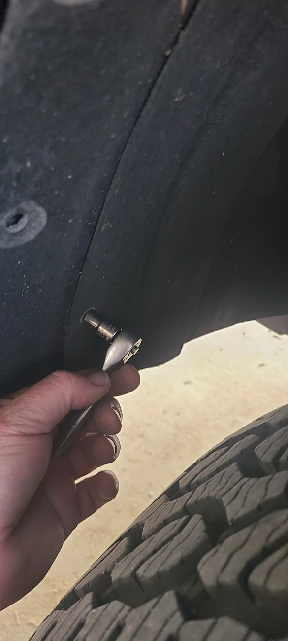

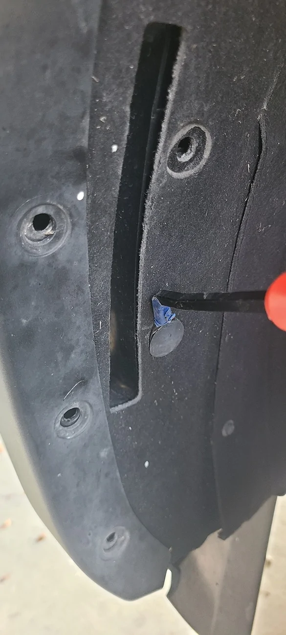

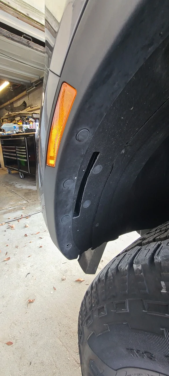

All the pieces that attch your fender liner in the above pics have to come out. The little deals you pull the middle out of, the two push pins, and the two 7mm hex had screws.
Ford Ranger Ranger Raptor Grill Replacement? 20260214_164231

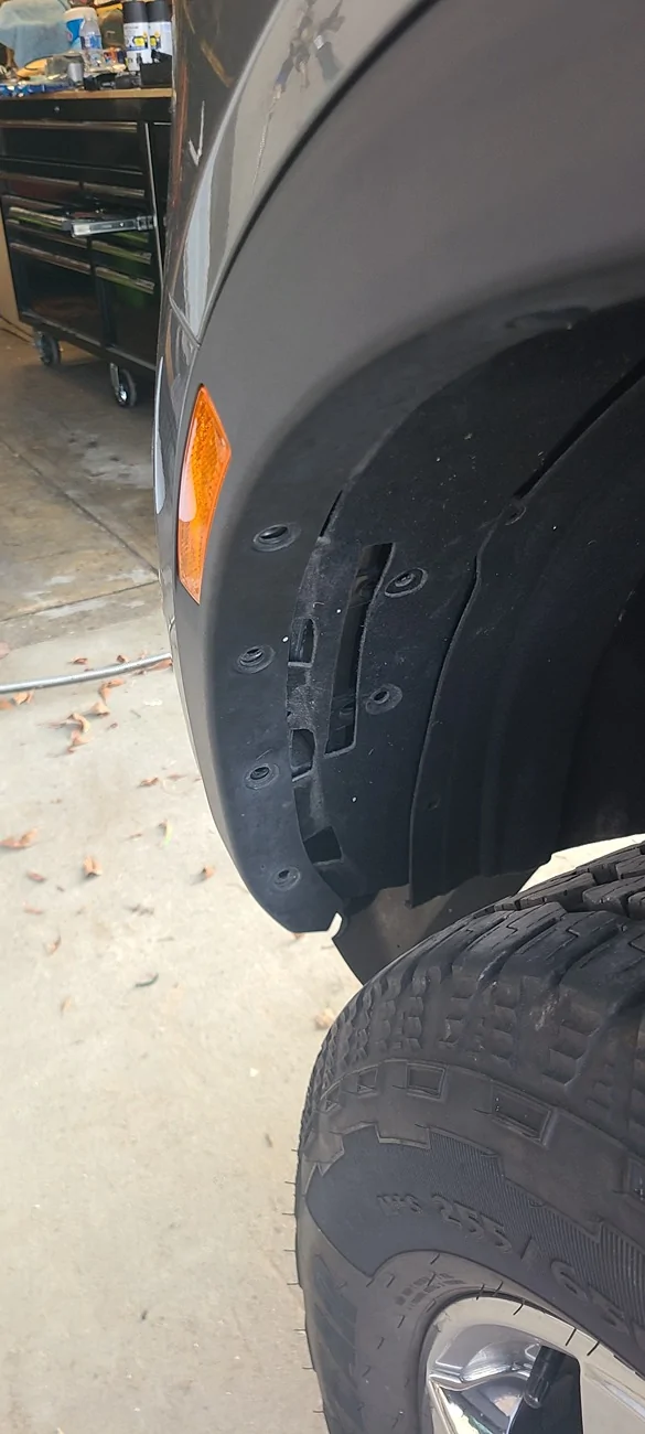

Yank the fender liner out. Let me tell you, it sucks putting this back in properly so if you can get to the back of that orange corner marker light from somewhere else, go that way. I learned what a pain it is to put back after so if there is another way, go that way.

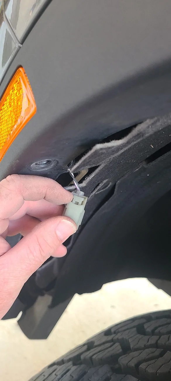

The white plug in the picture above about pulling the liner is this plug which plugs into that orange marker light. There is a little tang you oush with your finger tip and the plug slides right off.

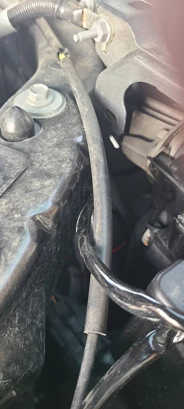

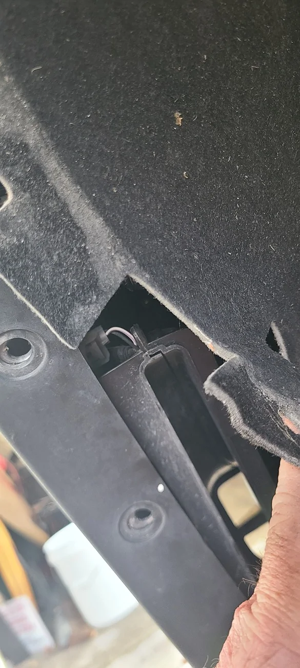

Push the grill wires down behind the headlihht and fish them out from where you pulled the fender liner back.

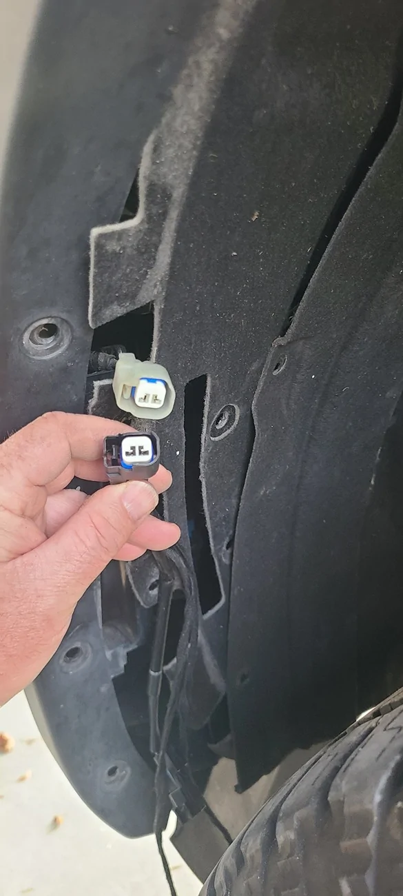

Find the f150led harness and compare it to your plug. One side will be identical but black and the other side will plug into the trucks plug. Plug the one side into the truck harness and the other, place into the back of the orange marker light where you unplugged the harness. Just fyi, plugging into the light is just as easy as unplugging was so be ready for all that fun. And the f150led harness plug will need to be pushed very hard, like amazingly hard, to make the catch click.

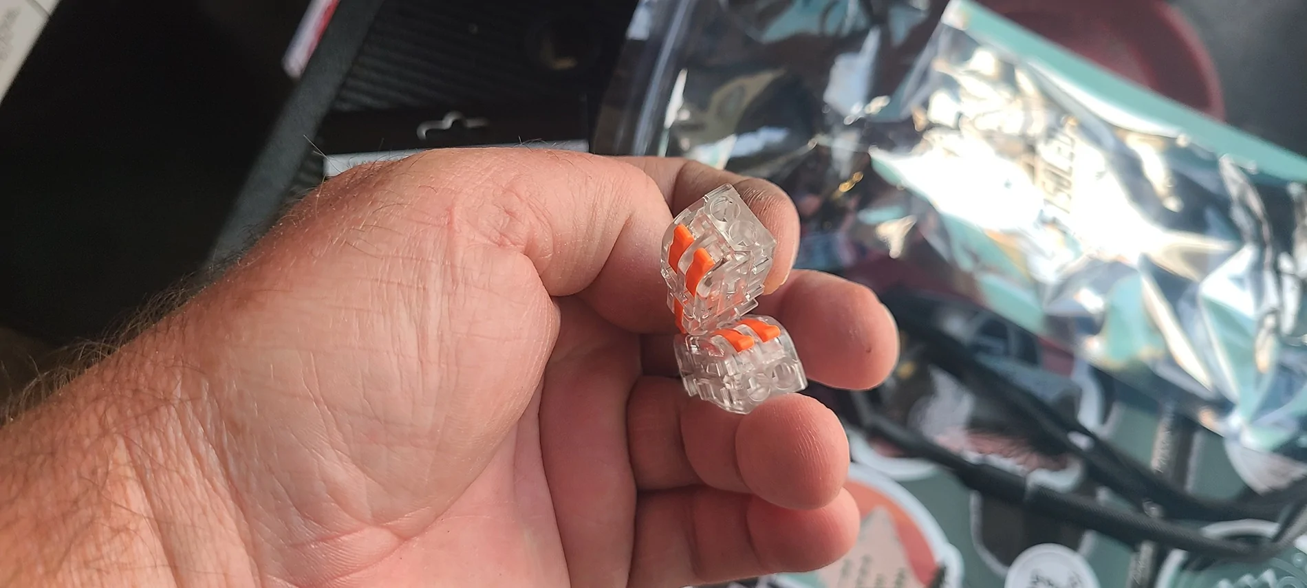

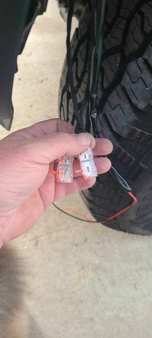

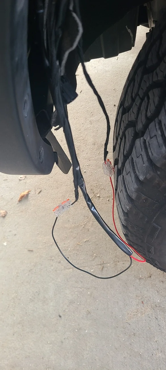

So now you are here with the other ends of the adapter harness. These suckers are freaking awesome. You lift the orange tips till the are perpendicular to the original position and slide your wire in and then flick the orange tips back down. They really lock down on the wires. Nice. What a great kit.
Ford Ranger Ranger Raptor Grill Replacement? 20260214_165059
You will be here now
Ford Ranger Ranger Raptor Grill Replacement? 20260214_165300

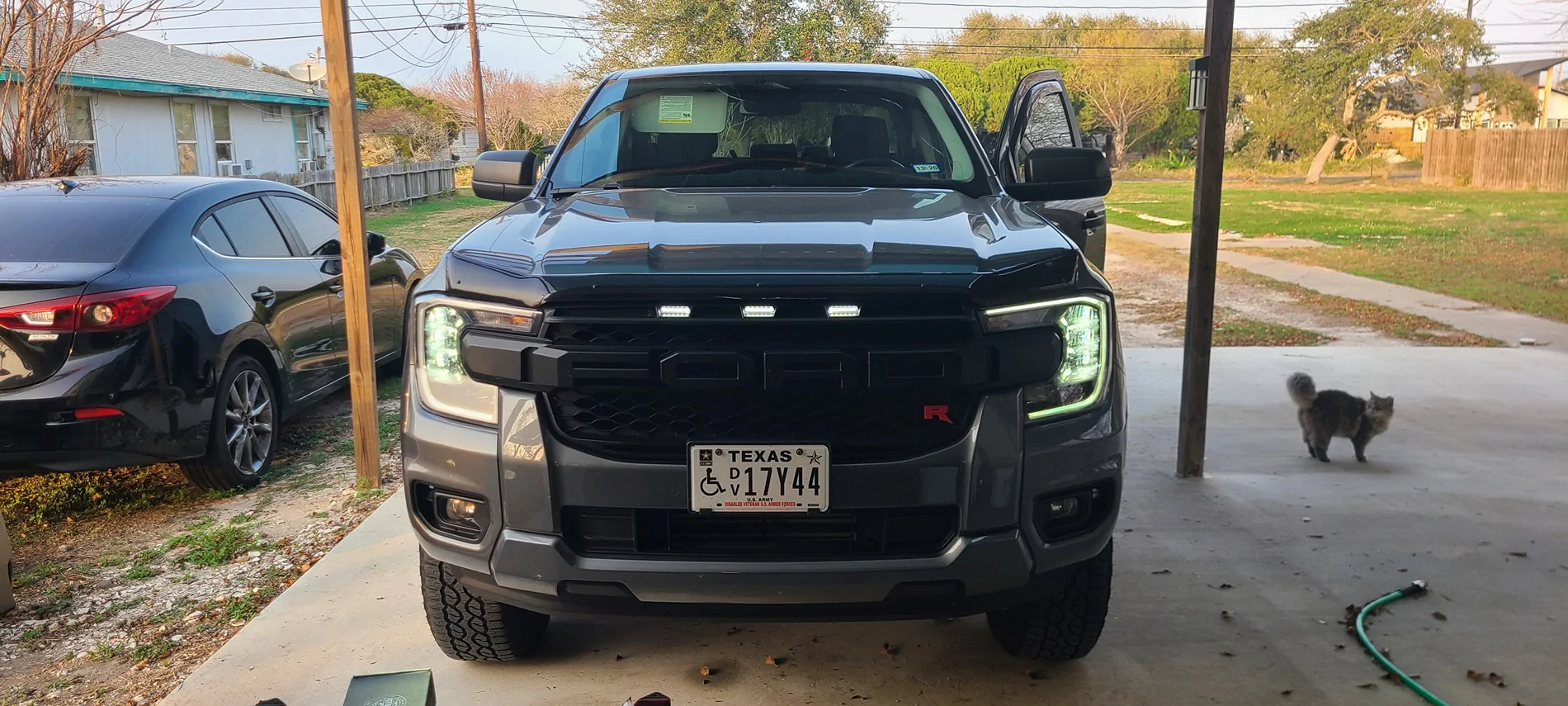

Turn the lights on and make sure your grill lights work. For this grill, the wires were backward feom what you would think. It wasn't red to red and black to black. All you have to do is figure out which way turns your lights on and you are ready to put everything back together.

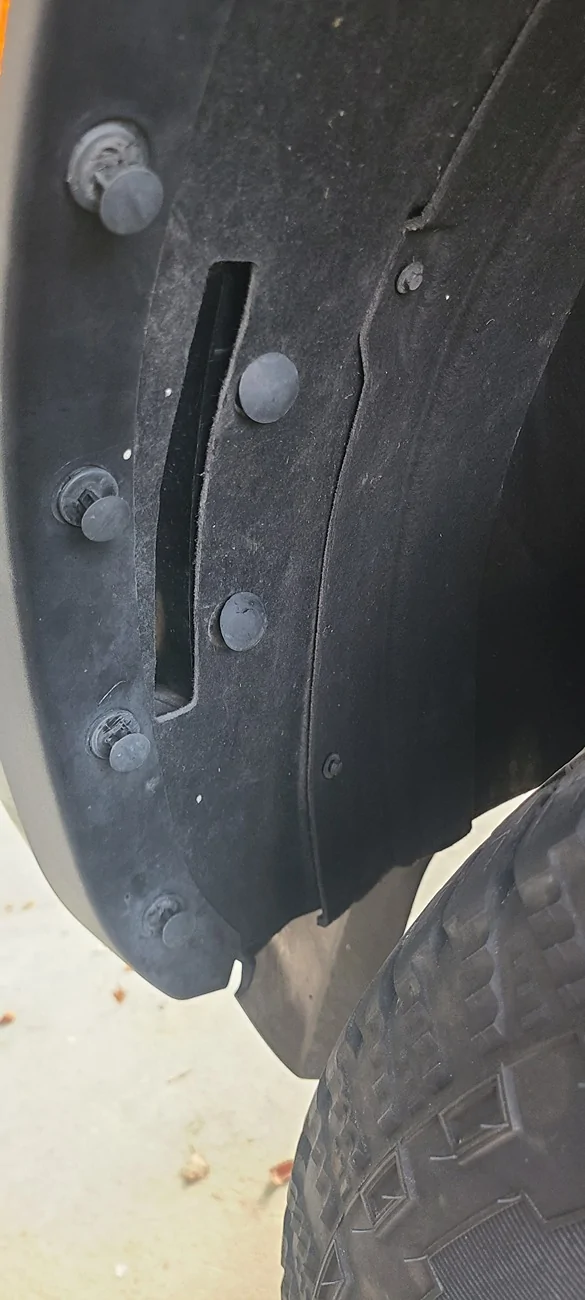

Put these back in and align everything as much as you can.

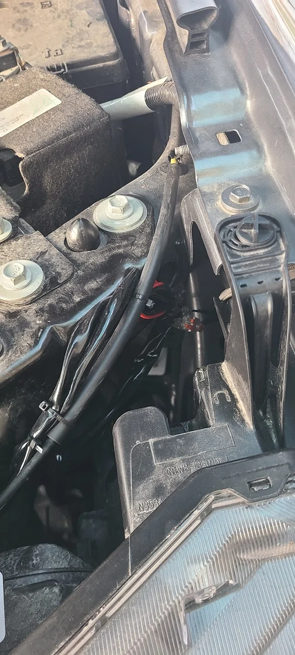

Roll up.your excess wire and zip tie it away nicely.

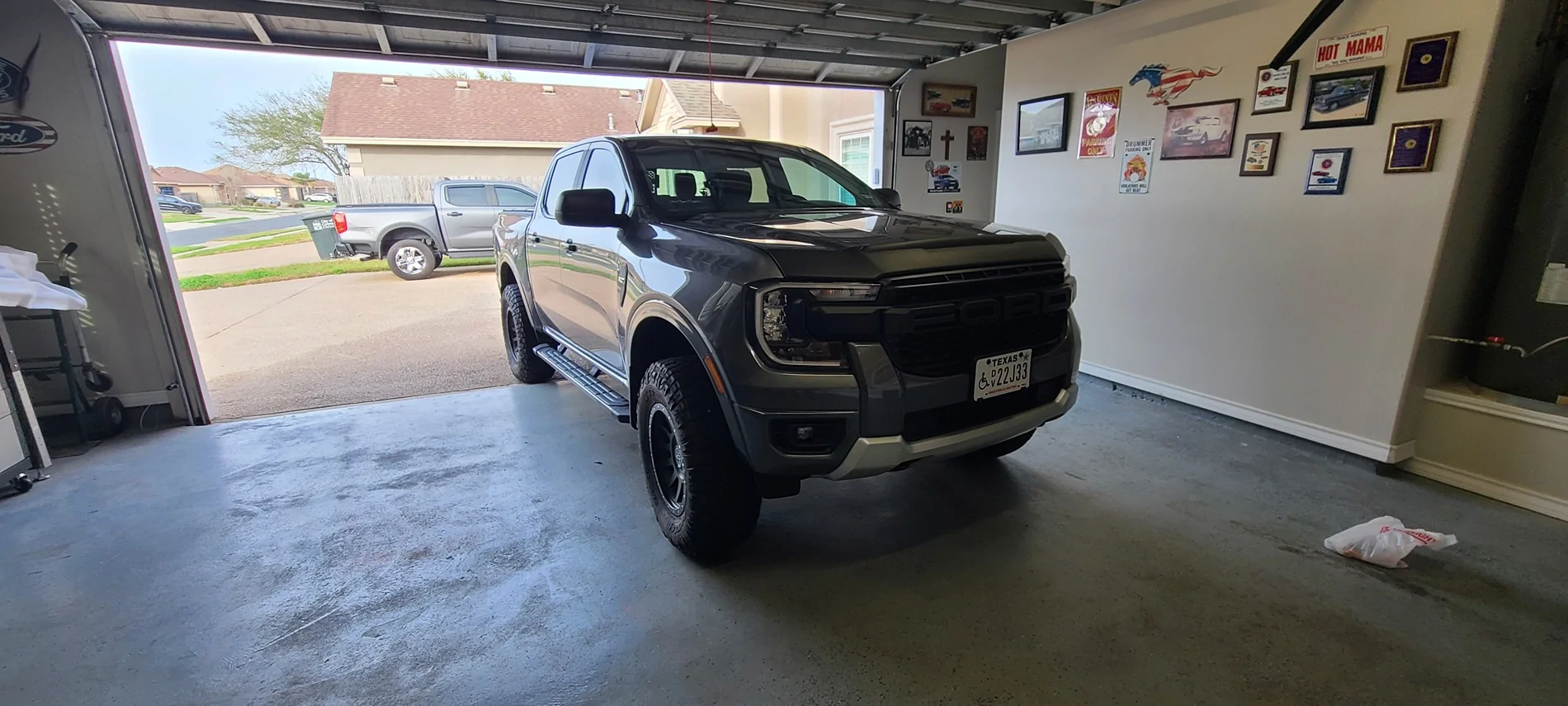

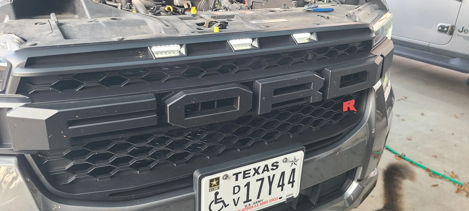

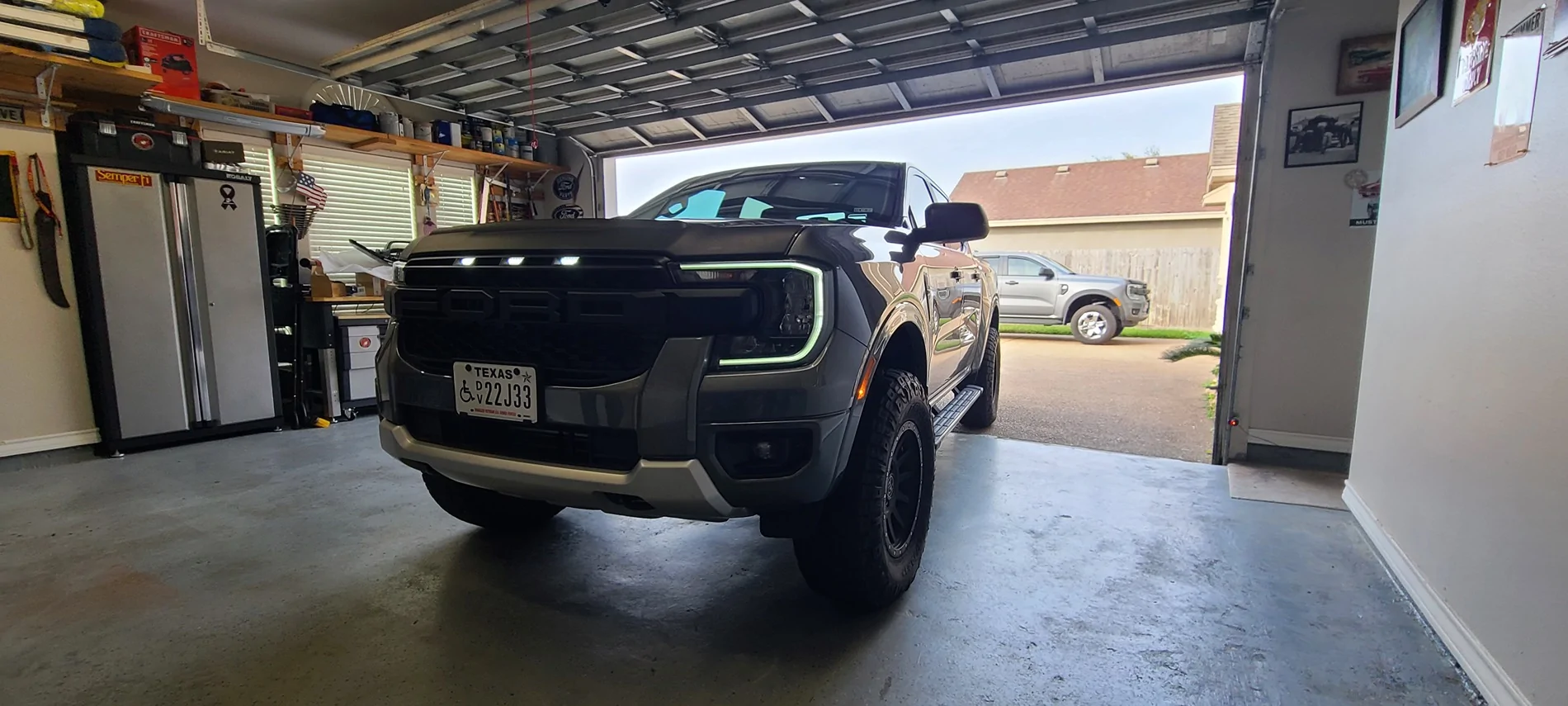

Check out how cool the grill looks when you are done.

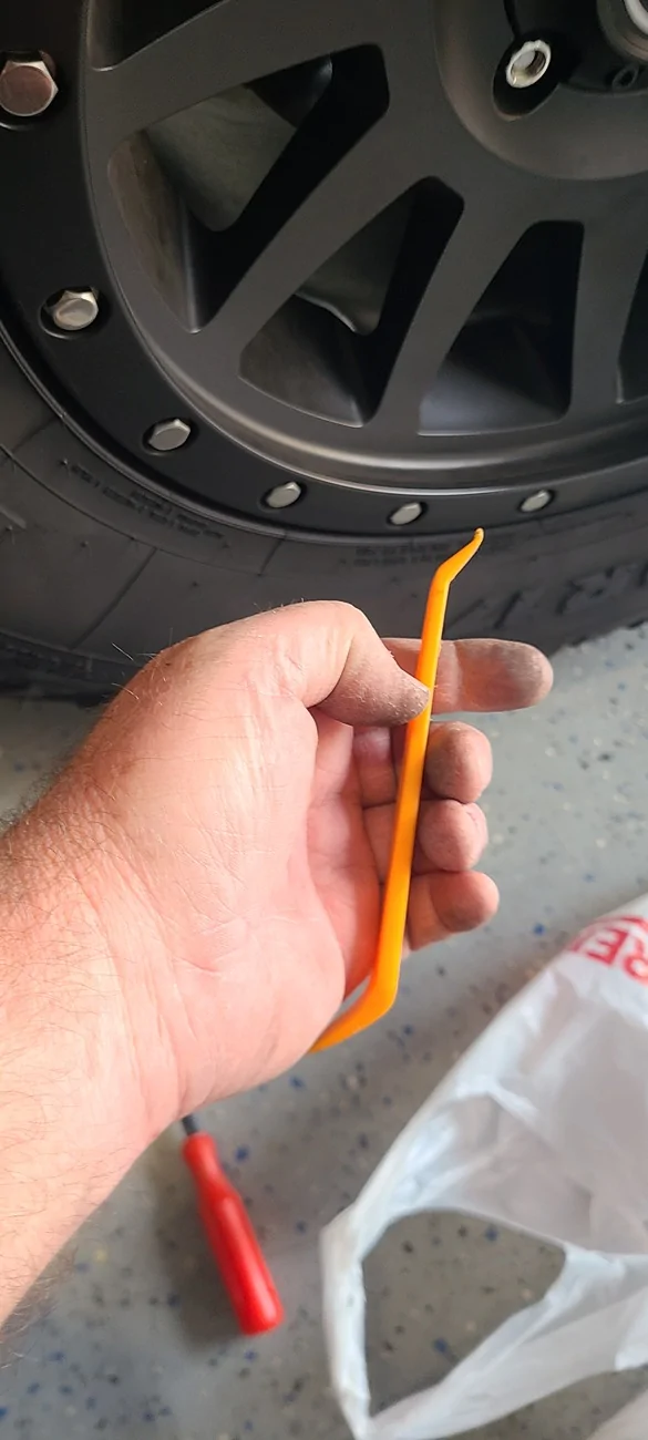

Found out the tool to temove the oem grill without breaking the clips. A normal ol plastic interior trim removal tool.
Ford Ranger Ranger Raptor Grill Replacement? 20260218_155429
It pops the clips rght off.

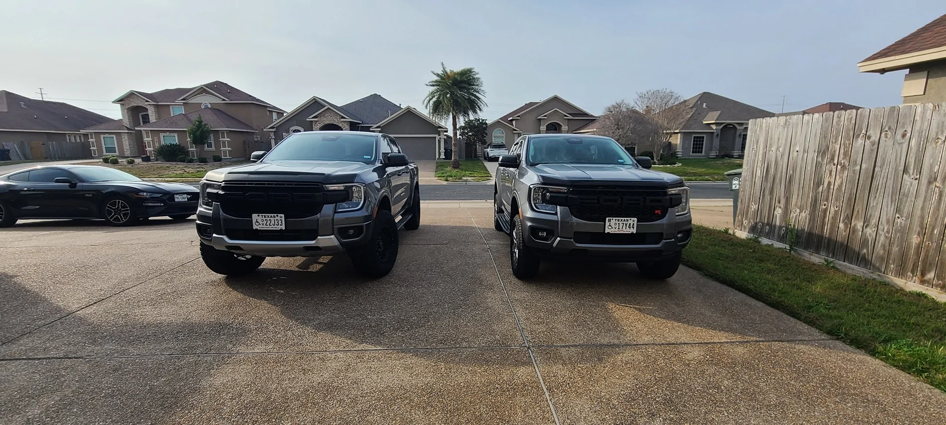

We did my father-in-law's truck today and it was an hour and 30 mins start to finish
Ford Ranger Ranger Raptor Grill Replacement? 20260218_161801
Ford Ranger Ranger Raptor Grill Replacement? 20260218_161827
Ford Ranger Ranger Raptor Grill Replacement? 20260218_162128
His is a 25 xlt fx4 amd he has a chrome package grill for sale now, boxed and ready to ship
