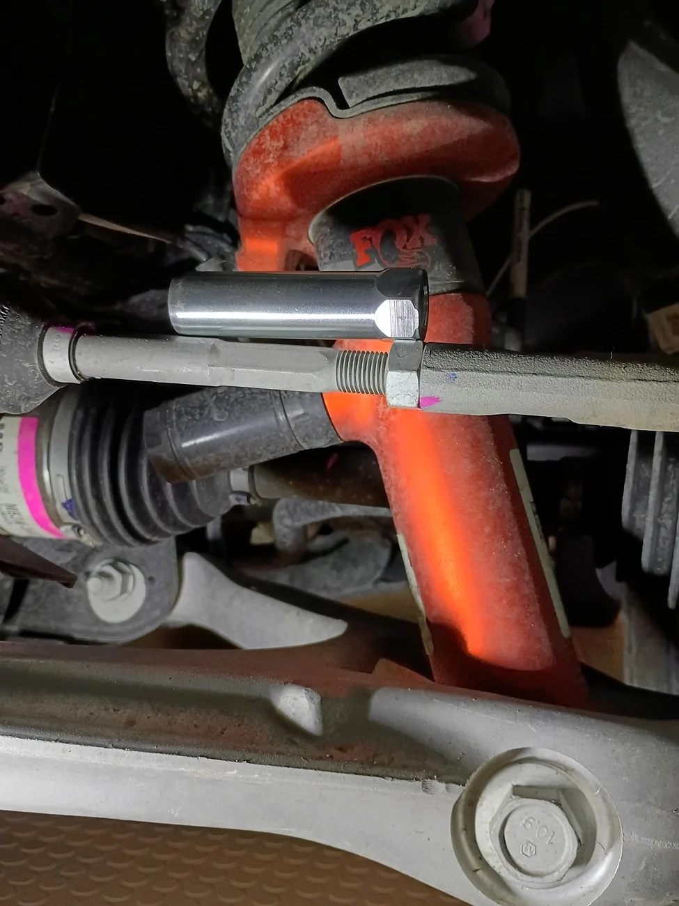

My plan is to install the tie rod sleeves before hitting the desert.
You can see how the sleeve will engage with the inner tie rod in the picture I took a few minutes ago. Measuring the diameter of the tie rod and the inside diameter of the sleeve, it is a close fit.
