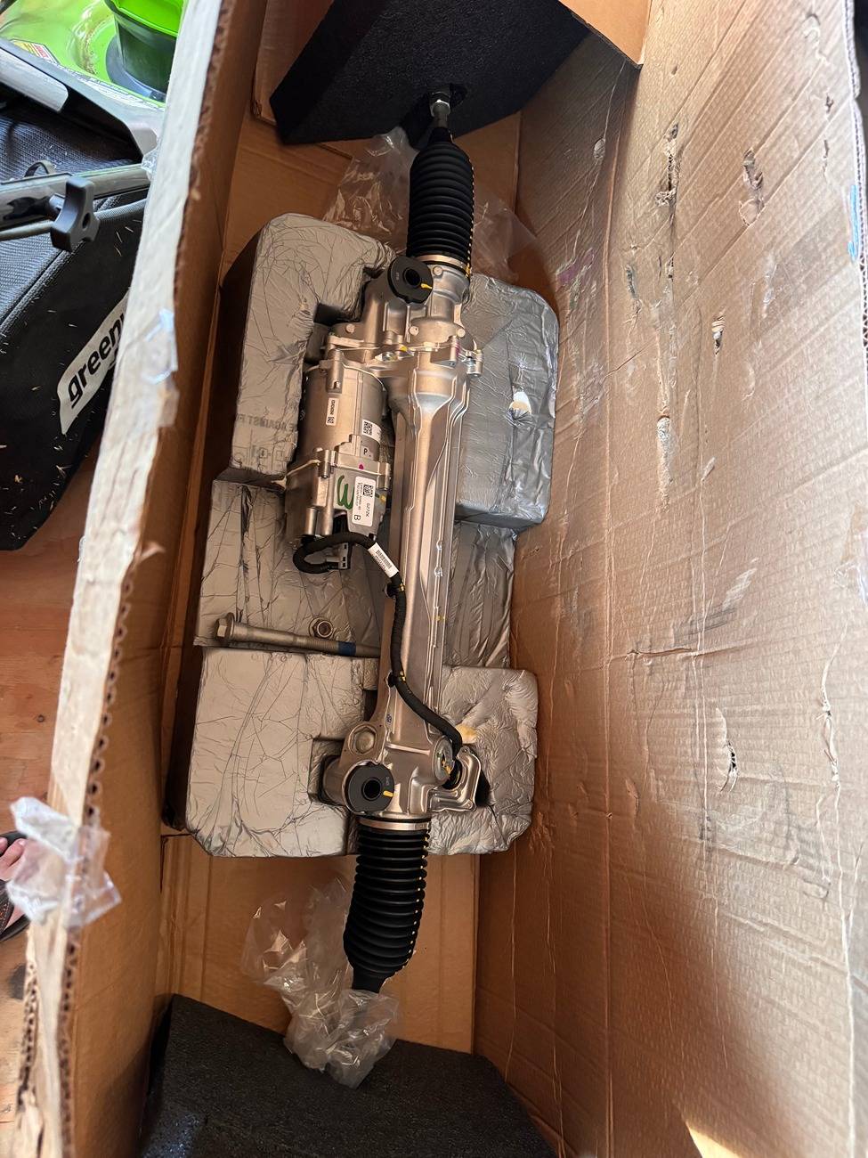

My Upgrade Hoss 3.0 rack just came in the mail and I'm pissed off of how it came in. The packaging was horrible and I'm missing hardware.
Has anyone installed this on their RR yet? Do I need to get different Tie rods?
Looks like the tie rods are installed already in the packaging based on the pic you posted.

Yes, I don't know why they would do that... I would of been better if it was shipped not together.
You will need either a Procal tool, or FDRS and forscan to program the new rack...let me know if you need any help.
